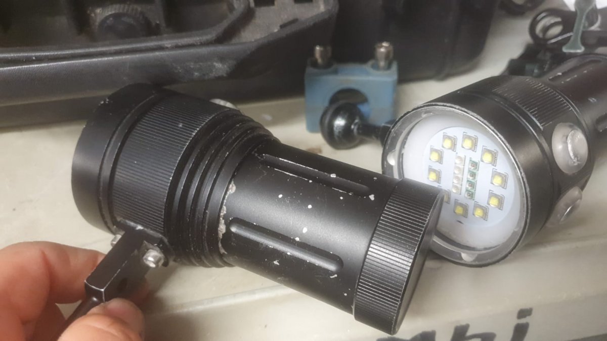

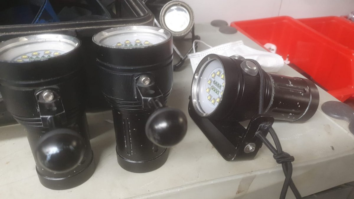

    Of course you will not find any test of cheaper lights. They are crap. Do you know how many Ali-Express lights I thrown away after two dives? I paid $50 USD for these lights. Following your reasoning I could buy 36 instead of a Keldan.

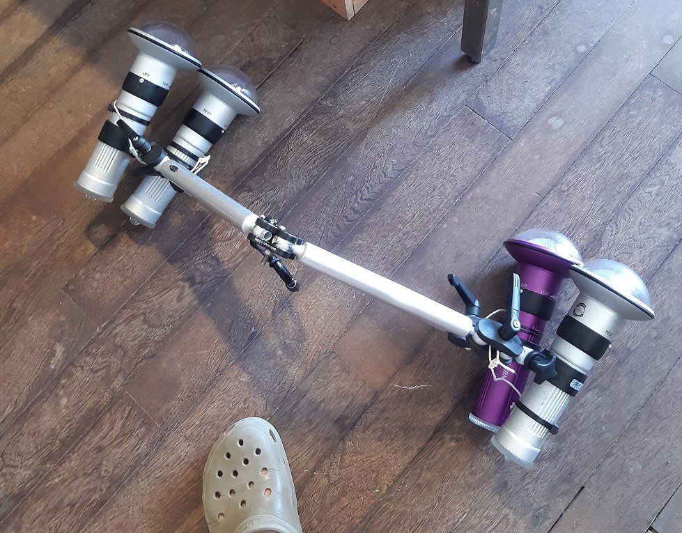

    The maximum power I used was this. When you open it like a cross and you light the scene from above you get a really nice effect
