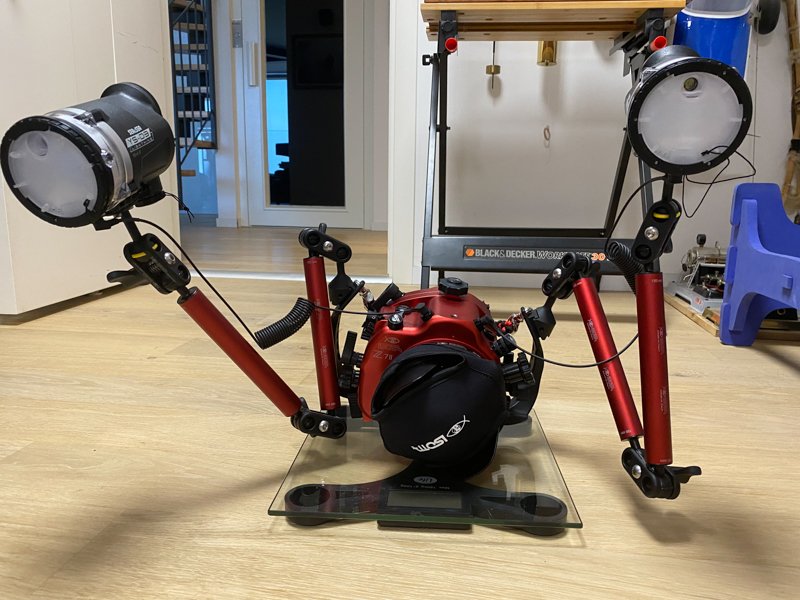

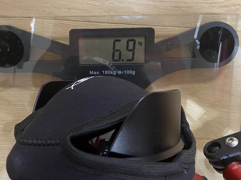

  17. Hi all
    Now I have my setup:
    Nikon Z62
    Nikon 8-15 lens
    Nikon FTZ
    Isotta housing
    4.5 glass dome+ zoom extension
    2 Sea&Sea YS D3 mark 2
    All: 6.9 KG
    Much lighter than expected. Cool !
    Quote
    Edited by ido

  19. On 10/22/2021 at 6:25 AM, ido said:
    Hi all
    Nikon Z62
    Nikon 8-15 lens
    Nikon FTZ
    Isotta housing
    All: 6.9 KG
    Looks beautiful! I have also Isotta housing, same strobes but DSLR D850. With macro lens, is just below 9 kg. I did not check it with the dome (got it just recently). Oh, I also have a Sola light on top of the housing.
    Enjoy it!
    Edited by Silvana
    Enjoy it!
    Thanks.. I am just strageling to disasamble the zoom extension from the dome..
