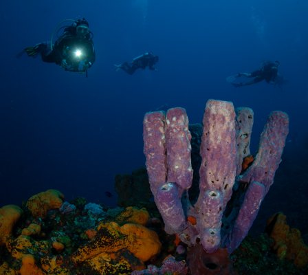

  4. Here's an example. OK, not a great shot for sure - but the idea is to move the strobes to light the tube sponges - and not the whole image. So maybe moving them both over to the right right of the housing.
    The exposure is set using the ambient light - and the strobes maybe turned down slightly so they don't overwhelm the sponges.
