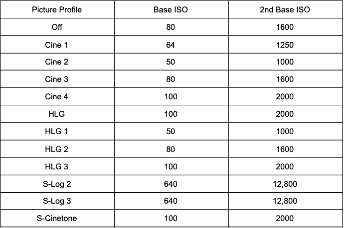

    What iso do you use for HLG because for every picture profile as native iso
    Each ISO has native ISO, that's correct, I have attached a chart that shows each one.  For the HLG3 I believe its ISO 2000 for the higher setting, which is what I used throughout this video.  Of course with SLOG3, you get clean files at ISO12,800, so it depends on how deep going, etc, for example as I am using the Sony 28mm F2 lens and WWL-1, if I want to take of the WWL-1 and shoot portraits at wide aperture (which I often do), the SLOG3 wouldn't work, as F2 there would just be far too much light coming in, so its always a choice based on what I want to film.
