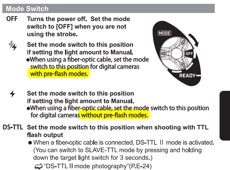

    Page 20 of the manual says the flash works in manual mode with the S&S dial in pre-flash position if you reset the custom mode of the S&S flash - maybe your flash has been reset to do this?  quote:
    "In this way the strobe is set to work in Manual mode, even if with the trigger in TTL, but it is necessary to put the Mode selector on the first position []."
    Chris yes, I was thinking of the same, however it refers to making the TTL trigger to work in manual. I have a manual trigger. Anyway, that sentence indeed would explain why it works now, if I can only identify that I have a TTL trigger and not a manual one.

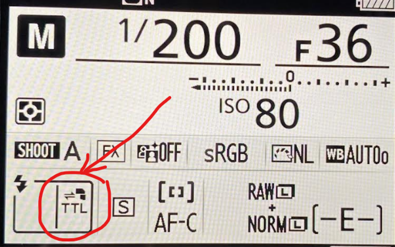

    Happy to report that the mystery of the century has been resolved! Isotta helped me with instructions to check the type of trigger I have. Turns out, Backscatter installed a TTL trigger, while I asked for a manual trigger and trying to make it work with this assumption. The checking of the trigger type is rather simple: with the camera in the housing and the trigger ON, check the back display on the camera by pressing the "info" button. For my camera, bottom left corner says TTL. When turning the trigger OFF, that writing disappears.
    With that resolved, following the Isotta's instructions from the manual for TTL trigger made sense and explained why it works for me in the "pre-flash" mode of the strobes instead of "without pre-flash".
    Thanks everyone!
