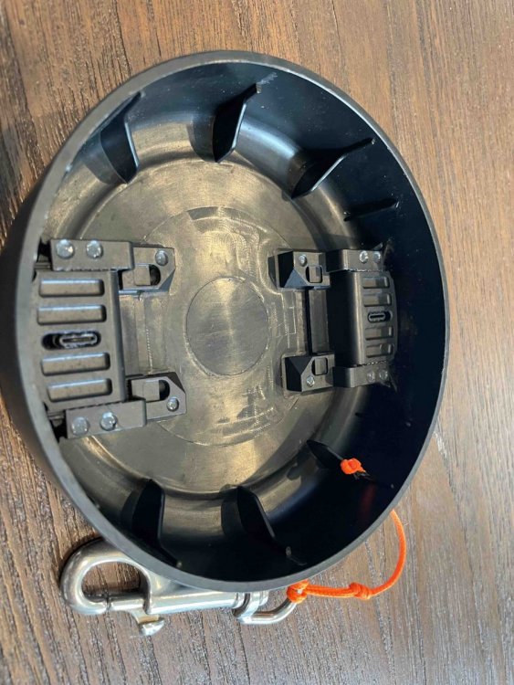

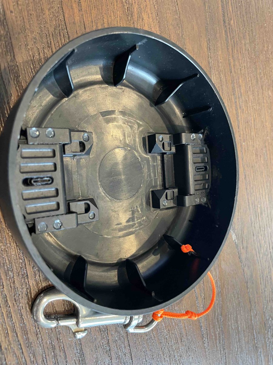

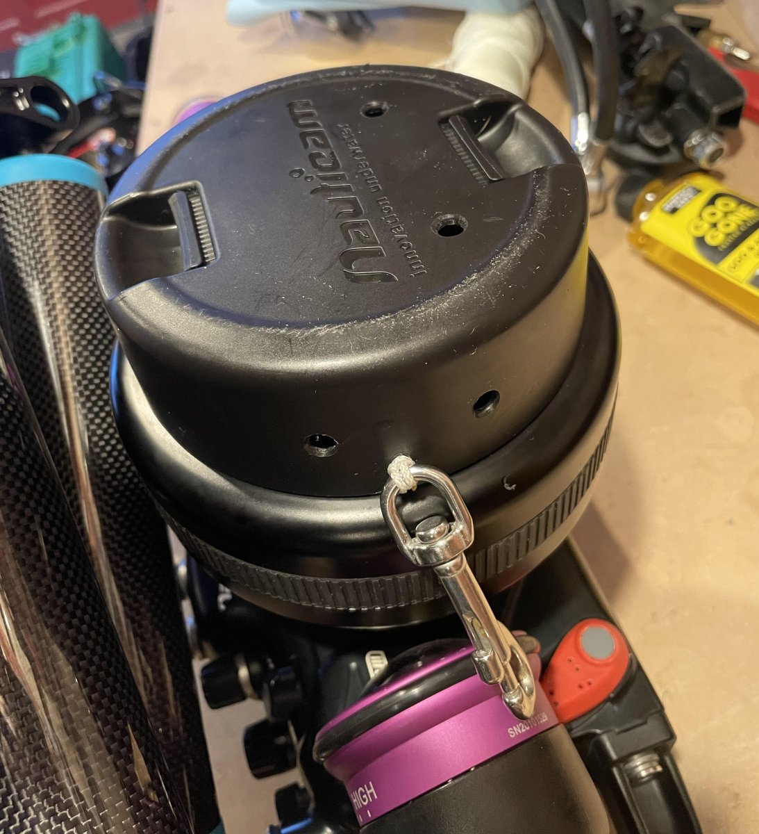

  3. Hey Owen, mine is a pain too. I've drilled a small attachment point for a boltsnap (at the suggestion of Natalie Gibb and Adam Hanlon) which is definitely a must-do modification. The boltsnap is hard to operate in dry gloves though so I'll probably replace it with a bungee loop and a double ender. I think we're both diving similar conditions.
    I've also drilled several vent holes in the hard cap in an effort to make it easier to get off underwater. I haven't actually dove it with the vent holes yet, so I'll let you know how it goes if you like!

  6. Hey Owen, mine is a pain too. I've drilled a small attachment point for a boltsnap (at the suggestion of Natalie Gibb and Adam Hanlon) which is definitely a must-do modification. The boltsnap is hard to operate in dry gloves though so I'll probably replace it with a bungee loop and a double ender. I think we're both diving similar conditions.
    Awesome Kees, that’s exactly what I was looking for!
    Yes, let me know how you get on with the vent holes. If you remember next time you are with your lens, do you mind sending me a pic of where you drilled the attachment hole?
    I've dropped you a picture on Facebook, but in case anyone stumbles on this thread in the future, I'll post it here too.

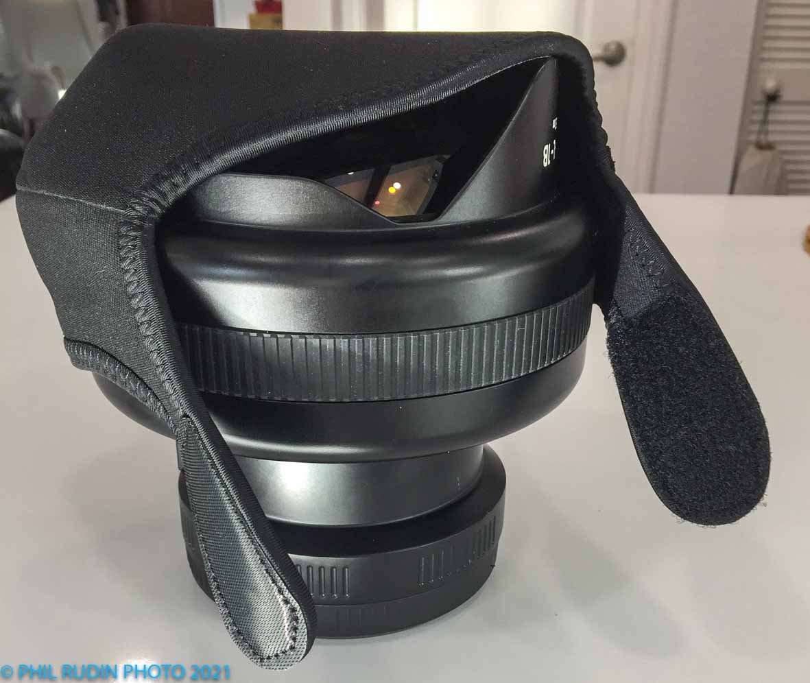

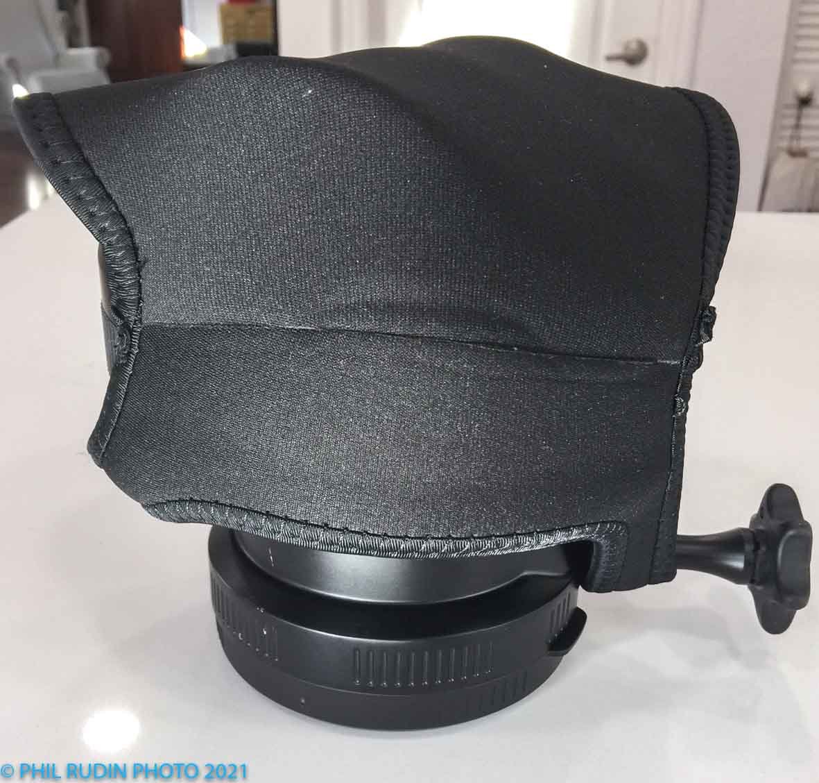

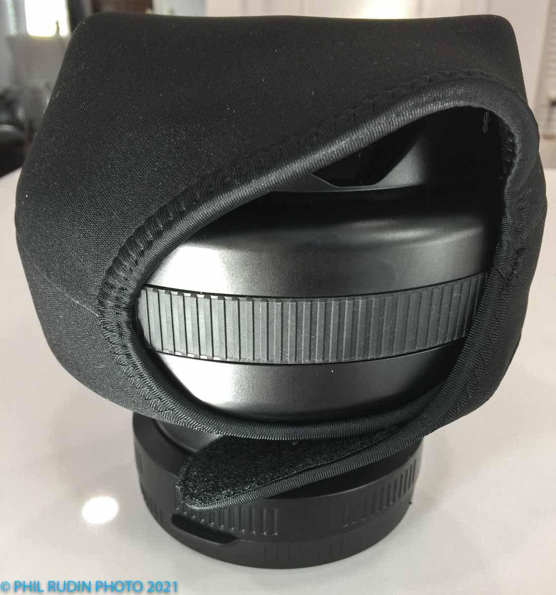

    We all want to protect our expensive glass while in the water. When the WWL-1 was developed the buoyancy collar was not part of the original design that was added later so the 140mm neoprene dome cover worked well. Nauticam's WACP was the first wet optic offered with the hard cap and that was later offered for WWL-1 when the type "B" was introduced.
    This does not seem like rocket science to me at least not if you are using a port with a zoom/focus wheel like the one for the Sony 28-60mm zoom. The photos show a 180mm neoprene port cover looped over the zoom wheel on one end and a velcro closer on the other end. I am sure some of you do-it-yourself guys can make this work.

  11. I've done something similar with a bolt snap but also a little different. My bolt snap is on a small piece of cave line that is attached through a hole I drilled. I also have the WWL-C and not the -1 or -1B.
    Given the amount of gear, bailout bottles, etc. I dive with, I also feel better having the hard cap on for the dive.
    The reason I have the extra line is that I keep the bolt snap attached to my Nauticam housing setup. There are a few small brackets with holes and I attach the bolt snap to that.
    When I get to the bottom, I take off the cap and then just "let it go" knowing that it is attached to the housing and won't get "lost."
    Two additional thoughts:
    1) I have had a really hard time removing the cap at depth due to the vacuum effect I believe. While I don't cherish the idea of drilling more holes into the cap, I do like the idea from @keesbl since it will make it a LOT easier to remove at depth.
    2) The length of my cave line is such that the cap can be on the wet lens and also connected to the housing. The downside is that it "floats" and sometimes gets in the way. I've thought about weighting it a little bit with tire weights so that it always is negative and below the GoPro I mount on top of my housing.
    In addition, I also wear dry gloves on all my dives and have no problems operating the small bolt snap, but I also have plenty of practice given all the gear I carry on my dives.

    Phil Rudin's dome cover photos look to be the best I've seen.  Phil, would you mind sharing what brand of 180 mm cover you have?

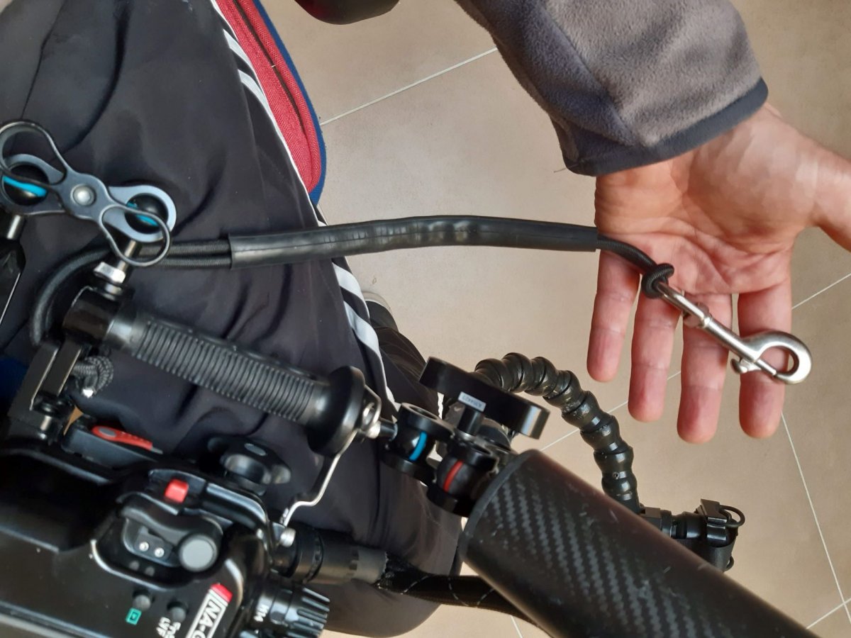

  14. I do rebreather dives with 3/4 stages and scooter and I leave the hard cap on the boat. It sucks. I have big hands (gloves size 11) and it's impossible to open with dry gloves. I really do not understand Nauticam solution.
    Anyway I clip my setup (GH5 WWL-1B, two Keldan Luna, four float arms and monitor)  to my right chest D ring through a 25 cm bungee and bolt snap. When I swim or ride with the scooter the housing sit perfectly on my side behind my armpit with the precious WWL facing up. I used the same conf. with the plastic 6" dome and I never had a scratch while diving.
    In order for this setup to work, the whole gear needs to be nearly neutral, and simple friction with the water while swimming brings it into perfect position. Unfortunately I don't have a picture of it in the water, but it's enough to have a bungee and a bolt snap of this length:
    When I move a little between shots I slip my arm over the cord that acts as a handle between the two arms and carry it like a shopping bag. This way.
