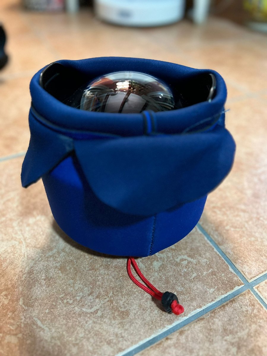

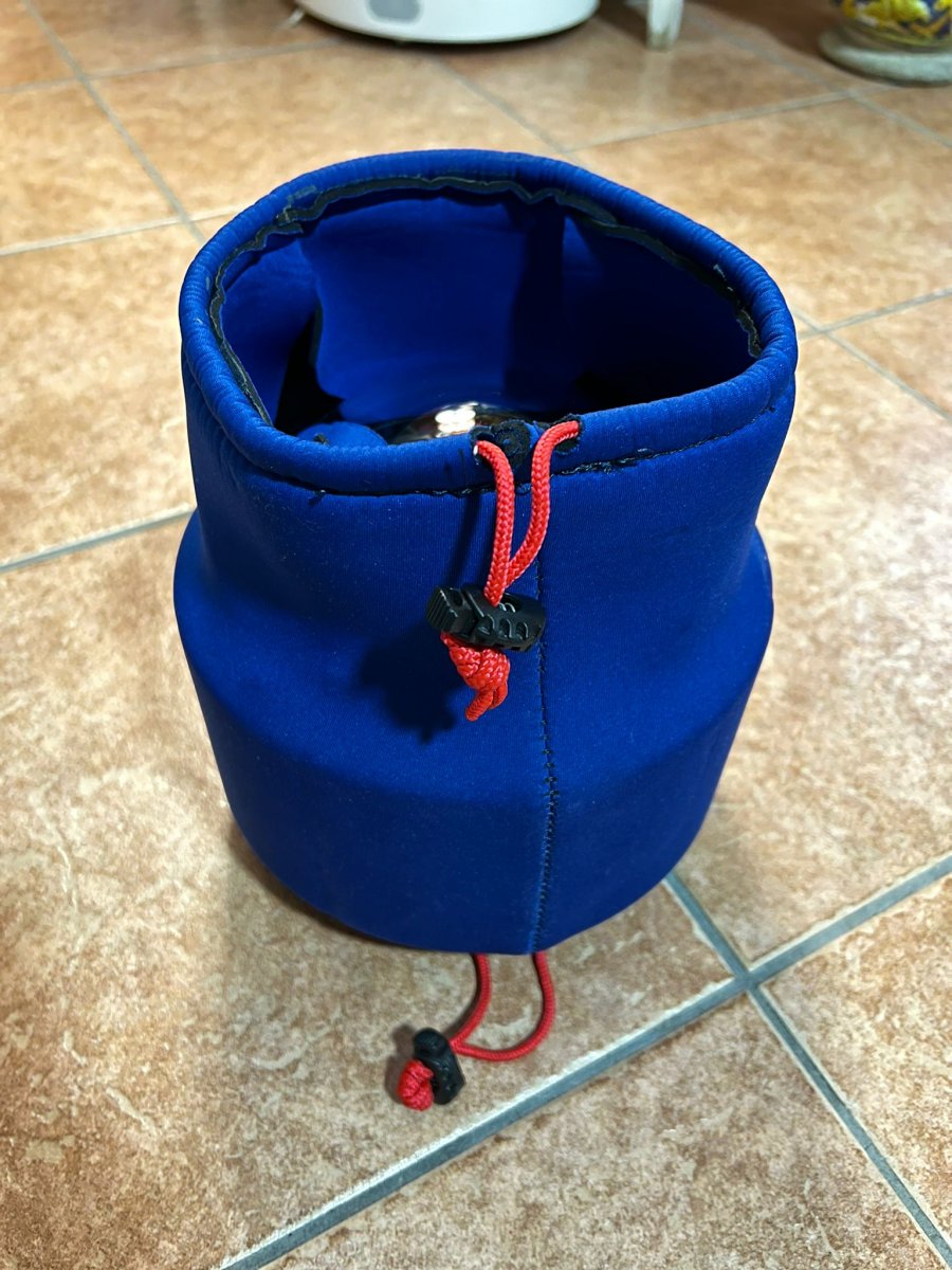

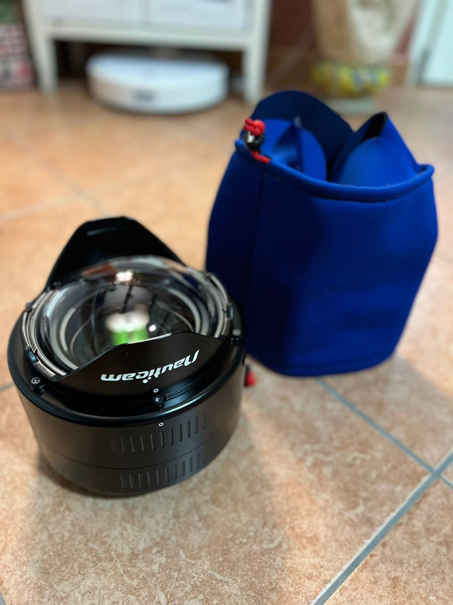

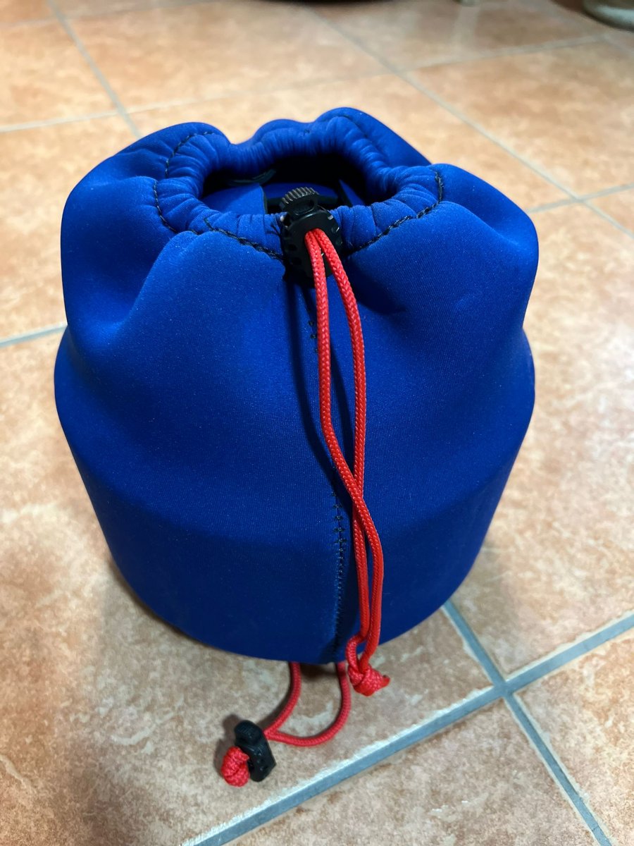

    Never tried, but I think it won't fit because the WWL-1 collar is much wider and deeper.
    My solution (from another tread):
    View archived post in: Nauticam WACP-C

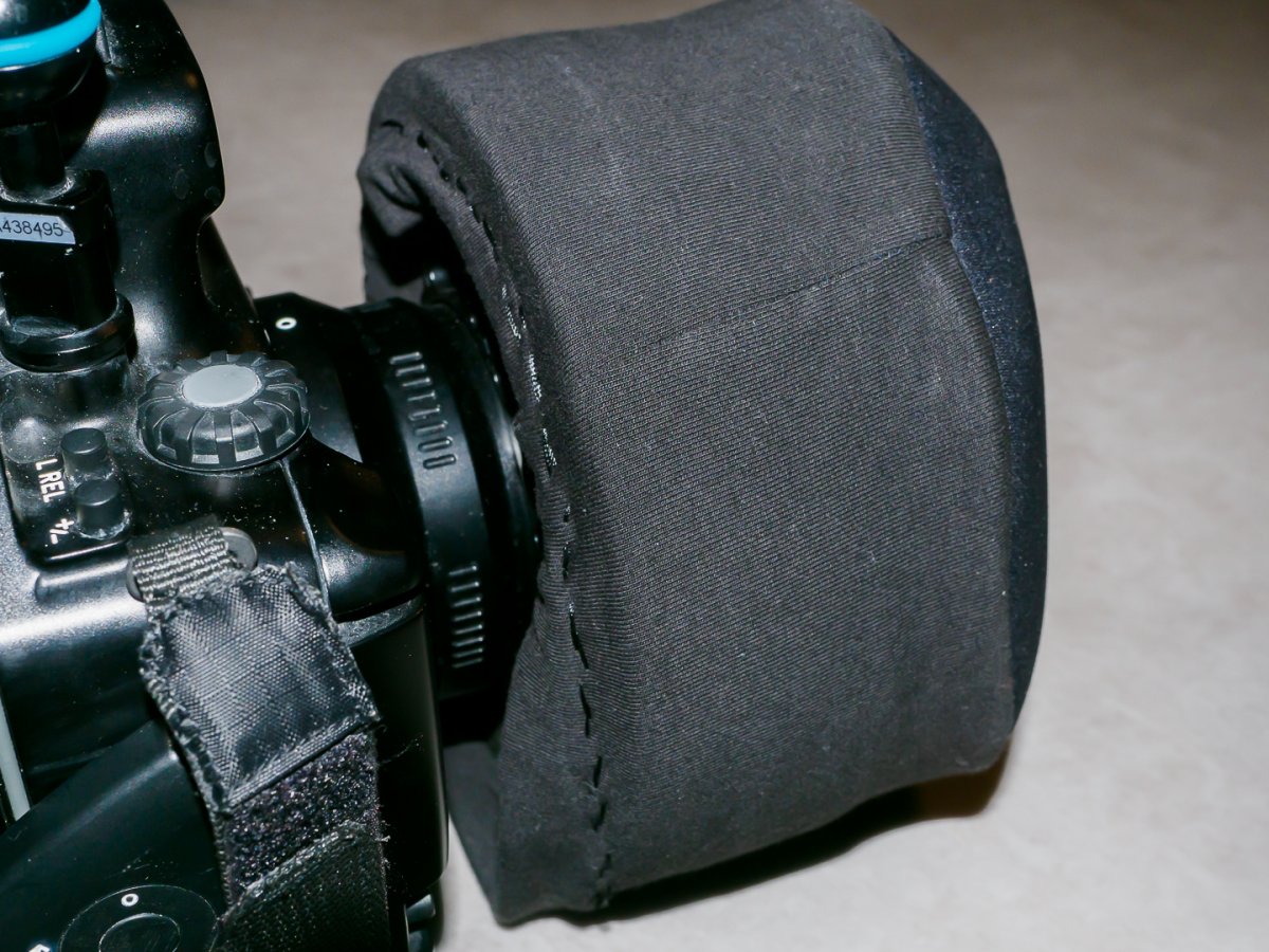

  13. Another DIY solution from a friend of mine with WACP but the concept it's the same.
