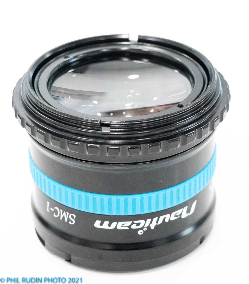

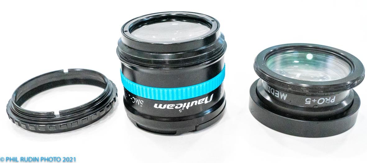

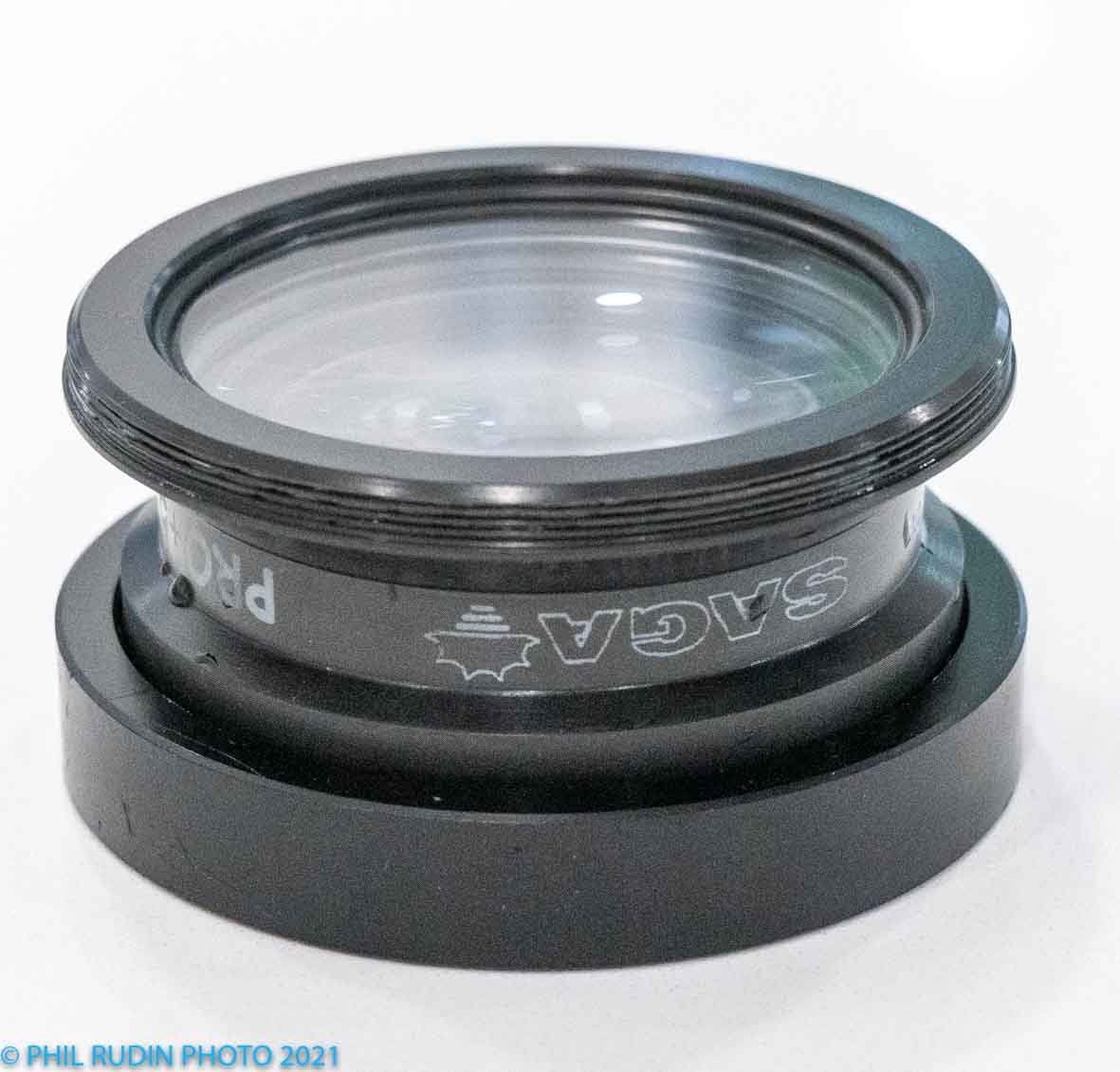

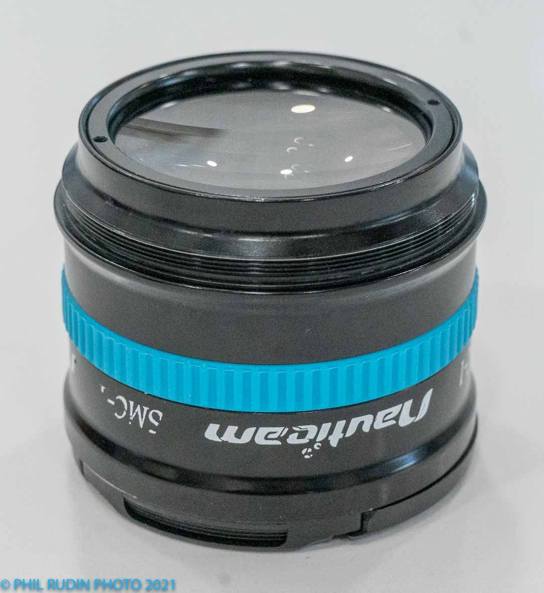

  12. It is not my intent to discourage you Newdiver but I have all of those parts and it is not going to work in the way you expect. The ring you have attached from Reef Photo is designed for a specific purpose for Nauticam wet closeup lenses. I have attached some photos to help illustrate. The Nauticam SMC-1 and other Nauticam wet lenses like CMC-1 are designed with the threads moved forward on the lens while many other closeup lenses like the SAGA DIVE +5 C/U lens have the threads flush with the rear of the lens. The ring you have referenced (which ships with the SMC-1 and CMC-1) is used to make the rear of the C/U lens sit flush with the port glass when you are not using a Nauticam designed flip adapter. These are proprietary designs used to get the rear of the C/U lens as close to the lens as possible. Even a millimeter or two of additional space will reduce the magnification of the C/U lens.
    The same issue will occur with the WWL-1B if you try to mount it using a spacer. Further the bayonet mount adapter that attaches to the port has two small roll pins that align with the two indentations on the Nauticam designed ports, (see the ring photo detail) without these pins being locked in place the bayonet adapter will spin on the port and the lens hood will move out of alignment and vignette.
    For those thinking about buying the Seafrogs housings be aware that you will have the same issues trying to mount many flip adapters to the Seafrogs macro ports. The C/U lenses will need to be threaded onto the port and then removed for several different lens designs.
    If others are considering this less expensive housing you may also want to consider some of the less expensive wide angle wet lenses that mount with the 67mm thread.
    If you want the have the Nauticam equipment mount the way it was intended to mount you can PM me I will be offering my like new Nauticam NA-A7C housing for sale this week.
