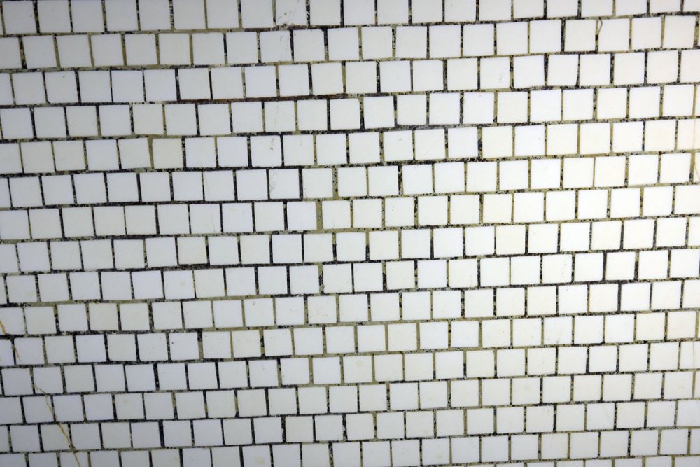

  7. I wanted to share some initial impressions of shooting the 14-35.  This was a pool dive (open water coming) shot largely ambient or with some video lights so I bumped up the ISO to keep shutter speed reasonable.  230mm dome and Canon R5 in Marelux housing and dome port system with the correct (specified) extension.
    Overall from a shooting perspective, this was very easy to use. Focusing was too fast to notice and in all regards there was no annoying hunting or anything like that. I was largely using ISO to modify shutter speed and with IBIS plus lens IS most of the shutter speeds were pretty easy to work with.  It focuses close and without thinking about it.  So from a “ease of use” it had zero issues.

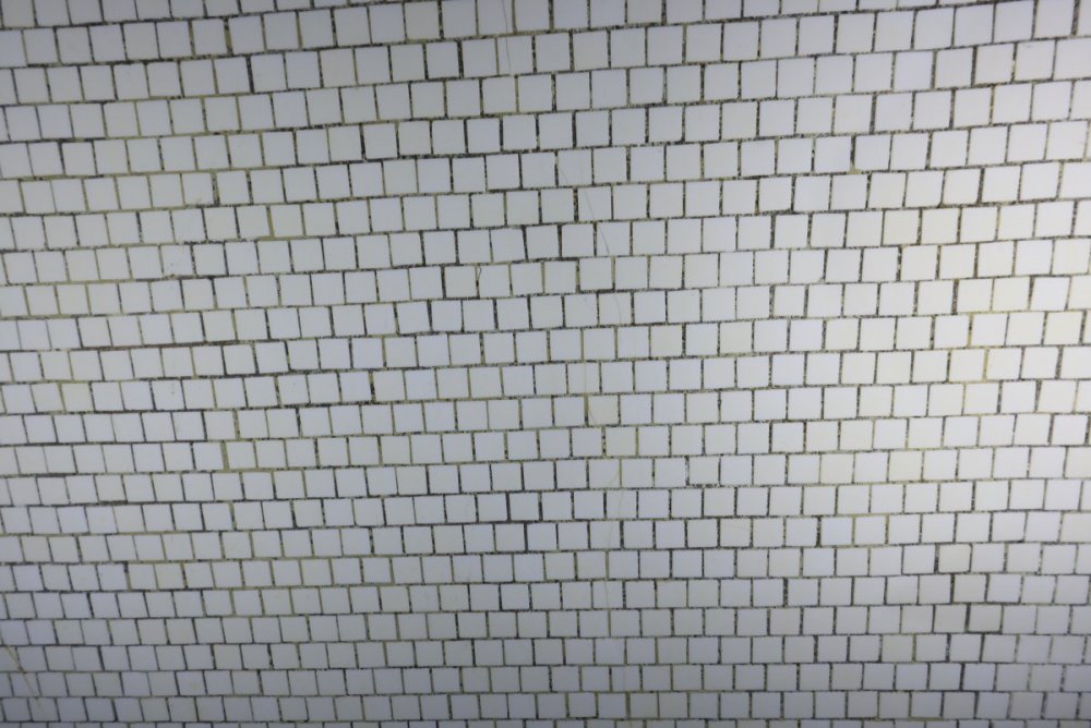

    Not surprisingly, this is a rectilinear lens in a dome.  It was very soft in the corners when pretty wide open (I shot it from F4 to F22).  This was much more apparent at 14mm than 35 (which is a shock to no one).
    Here is a lovely photo of the pool wall at f14 at 14mm

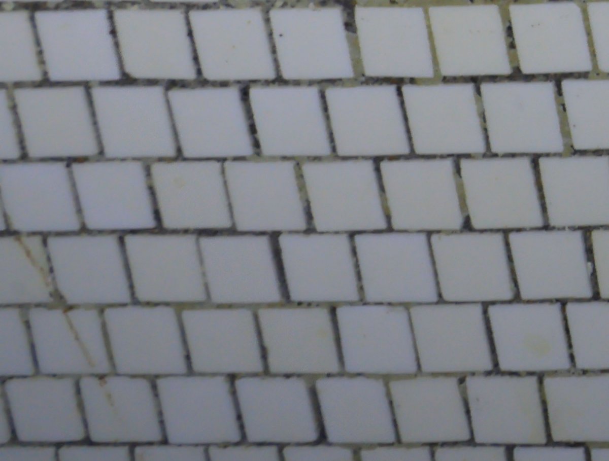

    Looking at corner sharpness, for me it seemed pretty acceptable (Remembering that this is a 14mm lens on a 45 mpix camera).  Center sharpness seemed spot on for the lens and F14 and above looked pretty good. It is easy to nudge to a happy place in post even if it looks a bit soft out of the camera. There was a wee bit of chromatic aberration available in the upper left corner in a few of the images that you can see at 100% crop but not otherwise. I also took these in raw and did very little post processing, the jpgs looked better but I wanted to post what they looked like relatively unadulterated (but acknowledging that the R5 and this lens already do a bit of inbody magic even when shooting in raw). While I don’t show it, I also did post process images how I would if I wanted to use them for something, and they are very workable.
    Here is the worst of the corners at 100% crop in the above image:
    And for those intersted: How things look not at 14mm - here is 27mm (f11)
    and 35mm (F11)35mmF11_60th_sm.thumb.jpg.6dfd2593b9e0ecf8af102615f23f2b31.jpg
