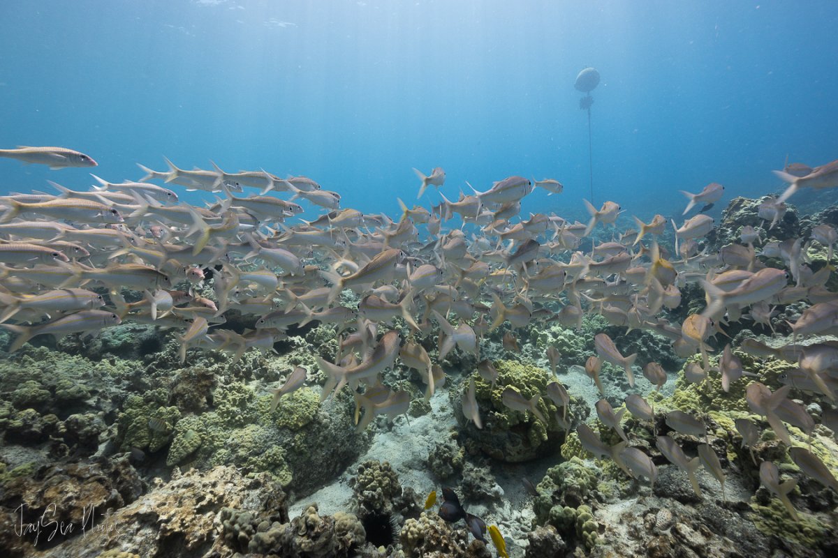

    • ambient light at 15'
    • Canon R5
    • 14mm
    • f/11
    • 1/160 sec
    • ISO 250

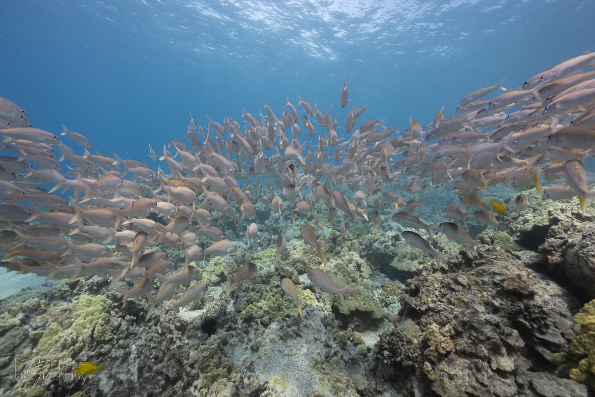

    • Canon R5
    • 14mm
    • f/13
    • 1/160 sec
    • ISO 320
  1. Great contributions @JayceeB, it is possible to upload a link for the images in FULL-RESOLUTION to check, please?
    @JayceeBAs an alternative a post of each bottom corner at 100% maybe about 1200 pixels wide to look at corner resolution if you don't have anywhere to host a full res image.

  4. @JayceeB,
    Thank you very much for sharing these. I would expect better corner performance at f/13. Is the lens in the correct position?
  5. 4 hours ago, adamhanlon said:
    @JayceeB,
    Hi Adam,  I'm assuming the lens is in the correct position.  I have it wrapped in a Marelux housing with the 230mm dome and 60mm extension ring as specified in their port chart.  Should I be checking anything else?  One thought...i was finning in the same direction as the fish school when the picture was taken, so the reef may have some motion blur.  Perhaps i should take another test shot while holding still?
    If you zoom in on the pics you'll see the corals/sponges in the corners are soft but centre of frame at the bottom is sharp.  I would not expect motion blur sharpness to change across the frame for fixed features on the bottom.
    What may be more interesting if you are prepared to is take a shot of a wall or similar where you are parallel to the subject  at 14/16/18mm to see how the corners improve as you zoom in.  14mm is particularly wide for a rectilinear lens so if the corners improve as you would expect it provides some indication that the extension used is correct.
    Thanks, Chris.  I'll try this at some point.  I don't have convenient access to a pool, but I do have access to a concrete anchor block (90' deep) that is ~4'x6' wide that might work.  I'll try an f-stop progression next time I'm at that site.
    a flat sandy/weedy bottom would also work to see how the point where you can distinguish sand grains at 100% view on screen changes with settings.

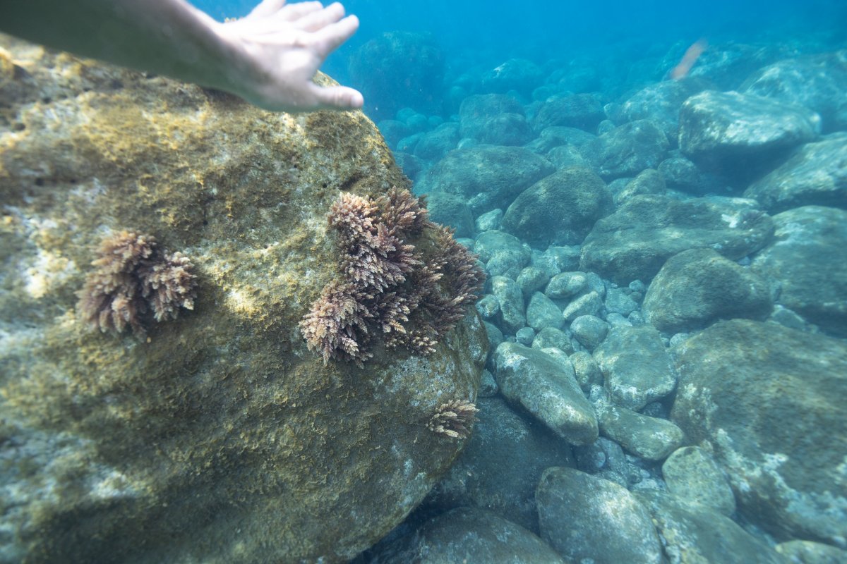

  9. IMG_8575.thumb.jpg.9a1c07e31901835402cb9e8e2e922768.jpgJust tried myself this weekend!
    8'' dome
    14 mm f4 1/400
    Can't deny, good center but horrible blurry corner performance......
    Sad :( Thinking to try 20 mm next snorkeling..
    Edited by stillviking
  10. Any tips for better performance of the lens and avoid this blurry corners? 20mm f8? What would you do?
    Is the S&S correction lens an option?
    RF 14-35 f4L has a 77mm filter diameter so I think it may work, but didn't find any reference.
    Problem is I have a trip next week and need to find a fast way to minimize soft corners.

  14. I have used the Nikon Z  14-30mm F/4 with the S&S 82mm lens and it is without doubt unforgiving in any port smaller than 230mm. With the Ikelite 8 inch compact port things were worse not better at every f/number.
    The lens was designed for the S&S 240mm dome port. S&S list the 77 & 82 lenses as being compatible with ports down to 165mm but I am skeptical at best as too weather this will add any advantage.
    14mm will also suffer in an eight inch port without the S&S. I would start at F/13 and above if you want to improve corners. Also a ton of photos can be made without needing to consider corners at all, this is a highly over rated downside all else considered.
    Ahhh, ok. Hmmm, as JayceeB (greta name!) suggests, small aperture then and not zoomed out to the widest setting. And, if you can, include more blue or neutral space at the edges. Sharpness doesn't matter then.
    Edited by TimG
