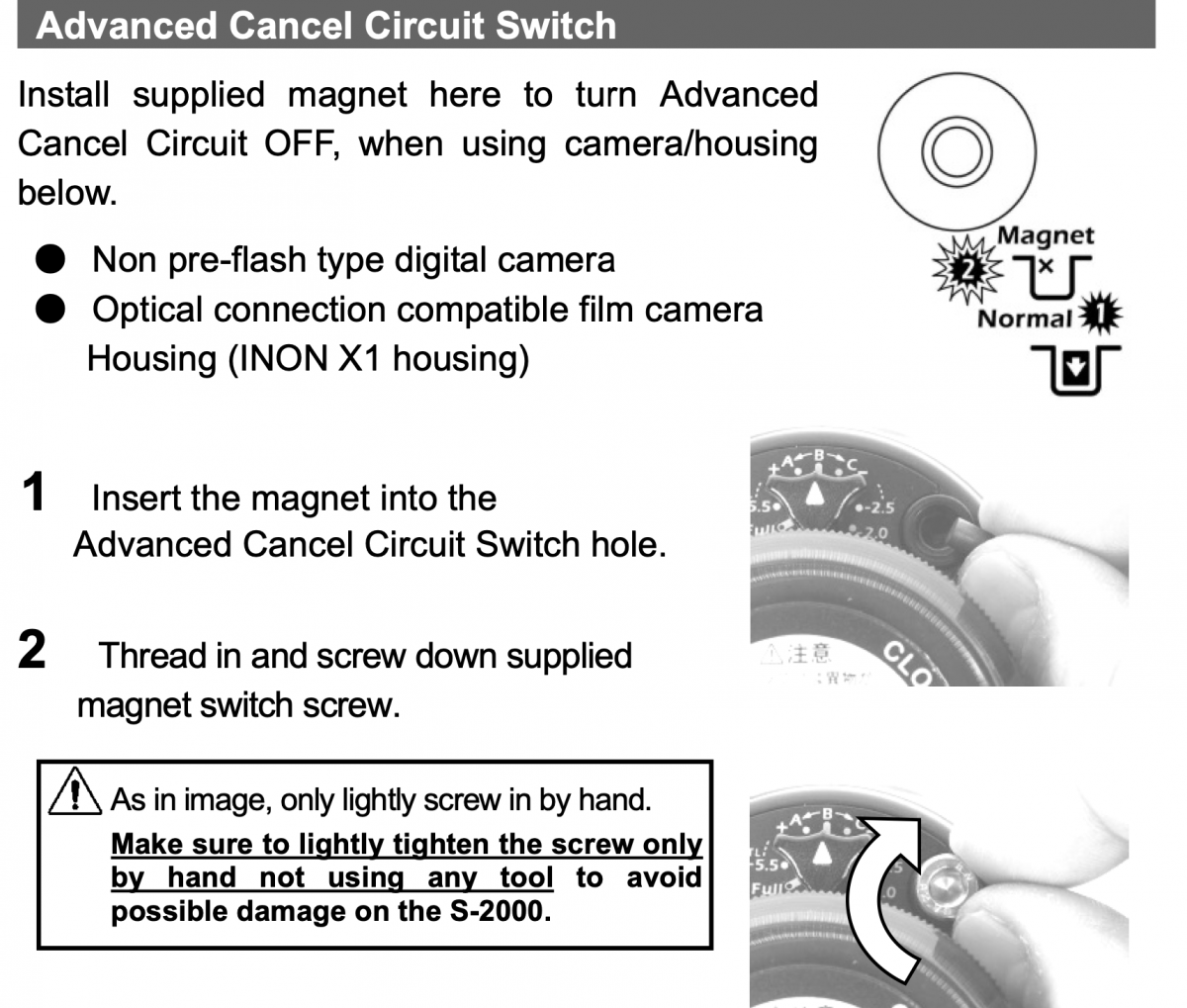

    Purely a guess, but I'm assuming he means the small magnet that you can use to disable (or enable?) the pre-flash cancel mode?
    BB as in "BB gun" where the small magnet resembles a BB?
    But, I took a quick look at the manual for the Z330 and I don't see mention of using the magnet so maybe they have gotten rid of that?
    Here is a screenshot of the S-2000 manual page that mentions it:
    250562631_ScreenShot2022-03-23at8_16_39AM.thumb.png.a81f3eb1119a3ec86f38e2340a556db7.png

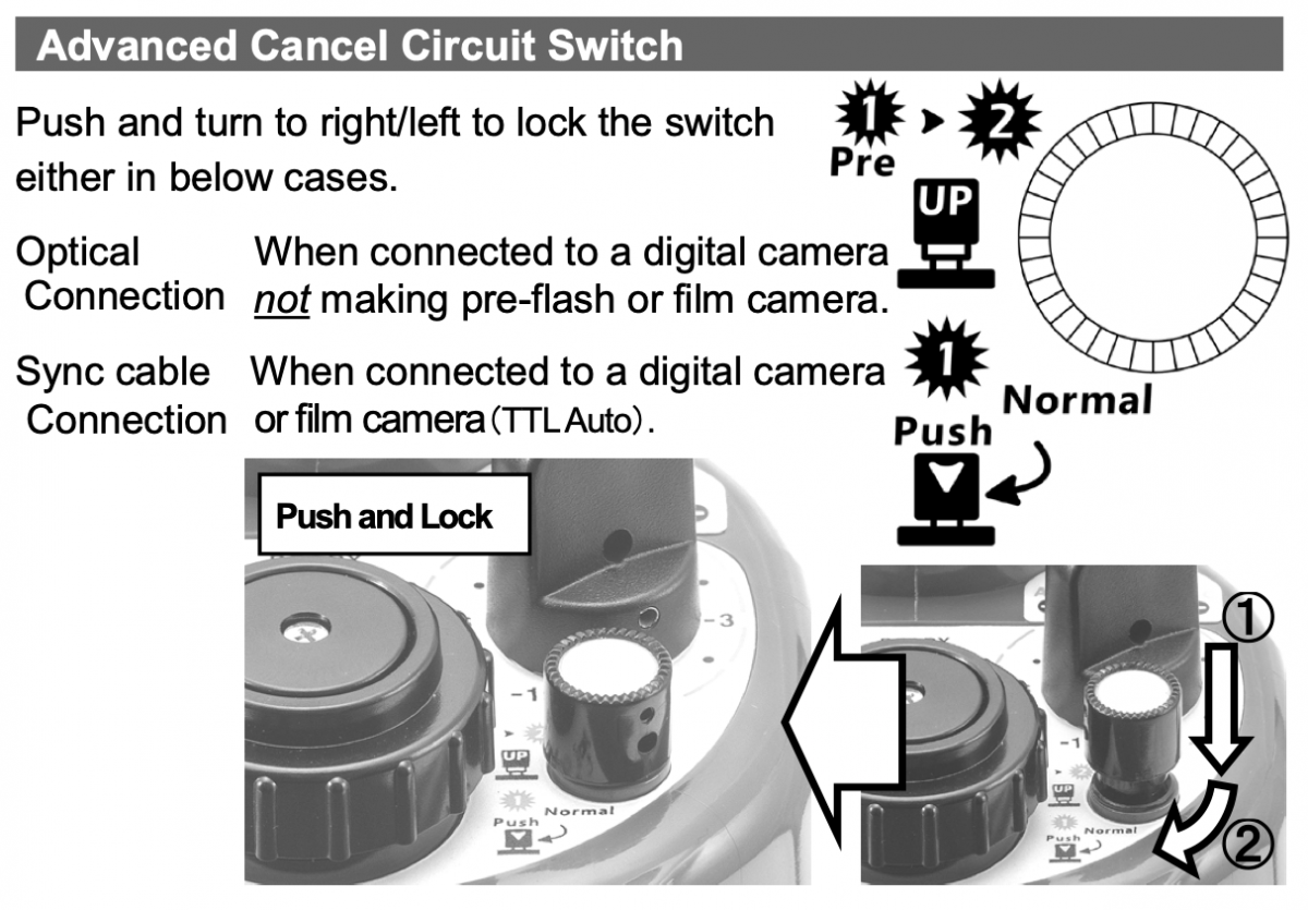

    I don't own a Z330, but I took a look at the manual and it looks like they might have put in a "simple switch, for example" to control the function instead of the BB:
    1447786835_ScreenShot2022-03-23at8_51_58AM.thumb.png.4c4989772019bb0e3daef551b2038a49.png
    Those bastards!

    Right, I can see why they use a magnet - one less penetration of the housing, though equally it could be handled by an extra position on the rotary switch.  I've been caught out by it once, but I'm pretty good at setting it in the right position when setting up the rig ever since.

    The problem with BB is, that they pop out upon unintentionally touching them slightly from this "simple switch - push and lock" position, when one adjusts other controls, e.g. intensity, especially when wearing gloves, but also w/o gloves. It may depend on the shape of your hands - I have rather crude hands with bold but short fingers (called "sausage fingers" here in Austria) and it happens frequently to me, while my wife never complained about the BBs so far... :pardon:
    I have read here about people (with Z240 that seem to have similar problem), who use superglue to arrest the BBs, because the BBs drive them crazy. I realized immediately what Alex meant with the abbreviation BB, as this is indeed the Achilles heel of the Z330s and the problem recurs again and again, even after experience with the strobes..
    We have three Z330 and they are very fine strobes, with the exception of the BBs, that are annoying - as Alex says part of the photos are ruined, because one of the strobes jumped out from manual and gives not enough intensity. Sometimes it is too late to rearrest the failing BB and make the photo again...

    If I'm not mistaken you are shooting manual and the BB is popping out.  If you always shoot manual it should be feasible to screw out the BB switch and install the screw like they have on the the cheaper D2000 etc.  Apparently it's M7 x 1 screw about 16 mm long, but you would need to find a magnet.
