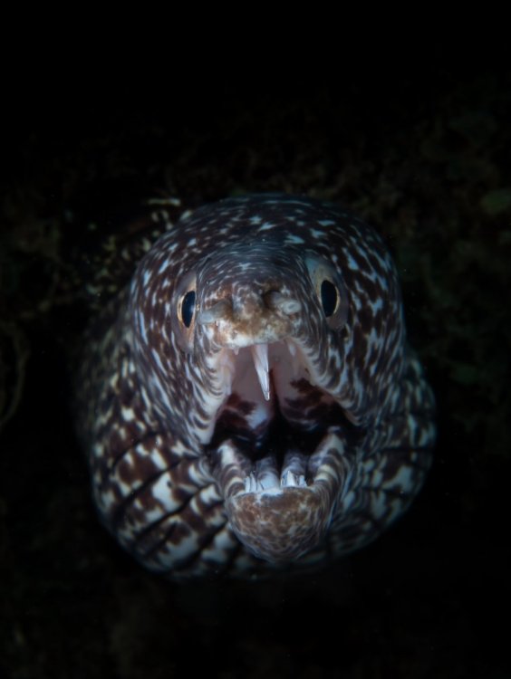

  15. 3 hours ago, JustinO said:
    I managed to find a few at wider apertures - f13. These are still crops, but show what the lens can do - still acceptable sharpness in both the moray portrait and the xmas tree worm. Still a little soft at the edges. Like others have said, at the price point it's a good lens.
    Awe man, that is an amazing eel image.  I would like to try to capture a similar image this summer.
    Thanks! I used two strobes in cross lighting position, either side of, and slightly in front of the port about a foot apart. so the edge of the beam just lit up the face.
