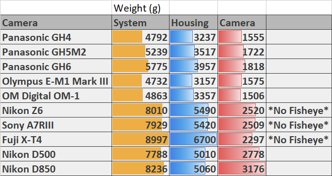

    From my recent comparison , albeit using diff lenses than discussed here.  Perhaps it helps weight wise though.
    Edited by makar0n
  10. The big D850 to D500 weight difference would be in the domeport.
    With the D500 you can easily get away with a180mm or 100mm domeport with, eg the Tokina 10-17.
    No chance with a D850 and, say, a Nikkor 16-35. You then need a 230mm domeport plus a 90mm EXR. The system become massive and heavy.
    You could switch to a Sigma 15mm FE or the Nikkor 8-15 both of which can cope with a smaller dome on the D850.
