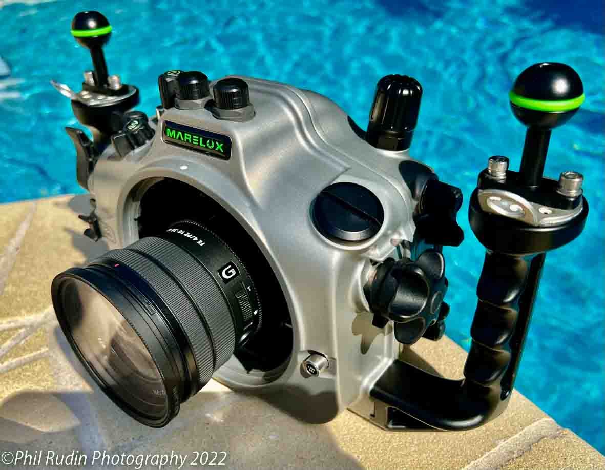

    The testing of the new Sony FE PZ 16-35mm has been done with the Marelux housing for the A7 IV and the Nauticam housing for the Sony A1. With both cameras I had the power zoom set to the wide end of the lens on the OK button and zoom in on the down arrow button. I did wide tests with and without the S&S conversion lens (now $600.00).
    Both housings are well built and the controls are well placed with or without gloves.
    What should not be overlooked are the outstanding Nauticam water contact optics that can be used with the Sony FE 20-60mm lens which is excellent for its cost.
    Cost wise the PZ 16-35 and S&S lens will cost around $1800.00 and the 230mm dome will cost in the $2276.00 to $2439.00 , port extension around $270.00 for a total cost from $4346.00 to $4509.00
    The 28-60 with gear cost around $566.00/$681.00 depending on brand. The WWL-1B with bayonet adapter and port runs from $2087.00 to $2224.00. Total $2653 to $2905.00.
    If you chose the new Nauticam WACP-C the cost is $3283.00 plus the N100 30mm port extension $413.00 and lens with gear 681.00 for a total of $4377.00. Both of these combinations are going to have better overall image quality and corner sharpness at like F/numbers than the $4346 to $4509 packages. If you remove the S&S lens and go with the 230mm or smaller dome port the differences will be even more noticeable.
    Photo is the Marelux SonyMX-A7 IV housing with the 16-35 PZ lens and the S&S lens mounted.

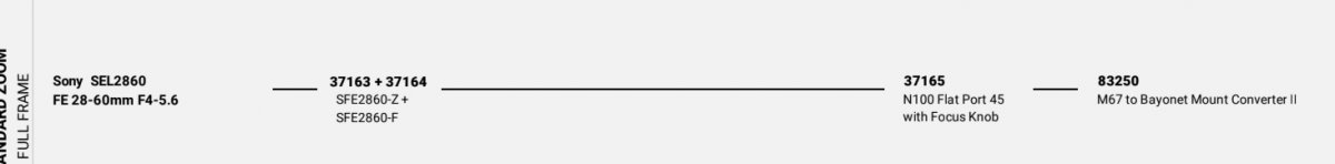

    Now hopefully last question as I am not very familiar with the Nauticam port-family: for the WWL-1B and the 28-60:
    I‘ll find it in the port charts?
