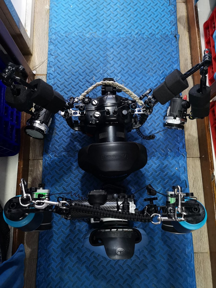

  5. @Frothin
    Be careful, you have put your hand in a gear which, in exchange for your passions, will take your time, and especially your money. But I can only say : WELCOME to the world of underwater photography.
    From the previous answer to your initial post, i cannot agree more with what @Barmaglot said : "do you dive to take photos, or do you take pictures while diving?" That will make a huge difference in your investment, unless you arte very rich and do not look at what you spend. I am the happy owner of a Sony A1 system (details will follow below) because I dive to take photos, which I sell either directly or via articles in magazine (specialized or large public). And this is the reason why I am using professional material. And this what should drive your decision. If you alreday own a G1 setup, and intend to take pictures while diving, more a hobby than a semi/pro activity, be assured that you will find as much pleasure, keeping in mind that you will need to overcome all the frustrations from underwater photography. I am sure no one will disagree here about all challenges and frustrations we have all encountered. Be prepared on that.
    With that being said as a preamble, i own a full Sony A1 setup, and without any commercial promotion intention (i am not paid by any manufacturer) :
    • Sony A1 with from wide to macro : 15mm FE (Sigma), all Sony 12-24 F/4, 16-35 F/2.8, 14 F1.8, 24-70 F/2.8 and 90 Macro F/2.8 and , 20 F2.8 Macro 1:2 (Tamron)
    • Nauticam Housing with Macro Port, 100mm Dome, 140mm Dome and 230 Dome. What ever we talk about corner softness, never a customer, client has complained about this... Come on, we are talking about underwater photography and not architecture photo. I had used the WWL-1 in the past, but sold it as i did not see the benefits, but the weight while travelling!
    • 2 x Inon Z240 for Macro, in TTL (with TRT S-Turtle TTL trigger) and 2 x Subtronic Nova (15 years old) for Wide Angle in Manual mode, with different sets of buoyancy arms and clamps from Nauticam (too expensive) and SeaFrog (great and cheap). Plus a backscatter Mini Flash for Snoot Macro (really great)
    I have been using this setup for now 18 months with much pleasure and satisfaction having upgraded from Sony A7rII in the same setup (only changed the housing, keeping all my ports and other accessories). Honestly, doing underwater photography for now 25 years, there is nothing I am missing with this setup, setup that took more than 10 years to build. I did not buy it in 1 shot. I.e., the Subtronic strobes that i bought 12 years ago. Same with the port...
    As a conclusion i would say and emphasize that underwater photography is like a love story. With HIGH and LOW (same as any pictures, with highlights and shades). It will give so much fun and plasure, proudness, but also will trigger so many frustration : Underwater photography will give you challenges that you wouldn't have faced had you not started with it... But so much pleasure as well
    Feel free to visit my website www.colorsoftheblue.com (unfortunately, not updated for the last 2 years)
    Eric

  14. 10 hours ago, Frothin said:
    The biggest concern with the a1 is that the underwater set-up is on the bigger side. Since I travel full-time, I would rather not have to carry a pelican case with me everywhere - the a1 itself with the telephoto lenses are already painful to carry.
    For what it's worth, here is my rig (A6300 in a SeaFrogs housing, 8-inch dome, Retra Pro strobes) next to a Nikon D850 in a Nauticam housing with a 230mm dome and Sea & Sea YS-D2 strobes:
    Top-down view on the same:
    The Nauticam A1 housing is similar in dimensions to the SeaFrogs A6xxx one - being metal, it's thinner than plastic, and it fits the camera body inside a lot closer, so the difference in camera body size is canceled out - and a WWL-1B is somewhat smaller than my 8-inch dome (the outer diameter of the port, not including shade petals, is 22cm, whereas the WWL-1B diameter is specified at 156mm).
    As you can see a large portion of the system bulk comes from arms and strobes, which is largely independent of the body that you pick, be in a D5/Z9 on the upper end (dual grip sports cameras make for a very fat housing), all the way to an RX100 or TG-6 on the lower end.
