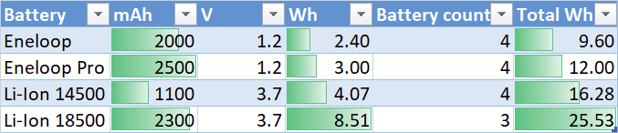

    Best would be a strobe which could use both types of batteries but NOT a  battery pack...so AA or 14500 or 18500 (albeit only 3)..these are all similar sizes to the point you could drop 4x AA or 4x 14500. And with 18500 one could use some kind of a plastic cartridge, albeit with 3 batteries, so that it should still fit the battery compartment. Free to use whatever, depending on performance needed, and there is always easily obtainable AA as a backup. And we keep the small form factor.
    Simplistic table, based on parallel connection.

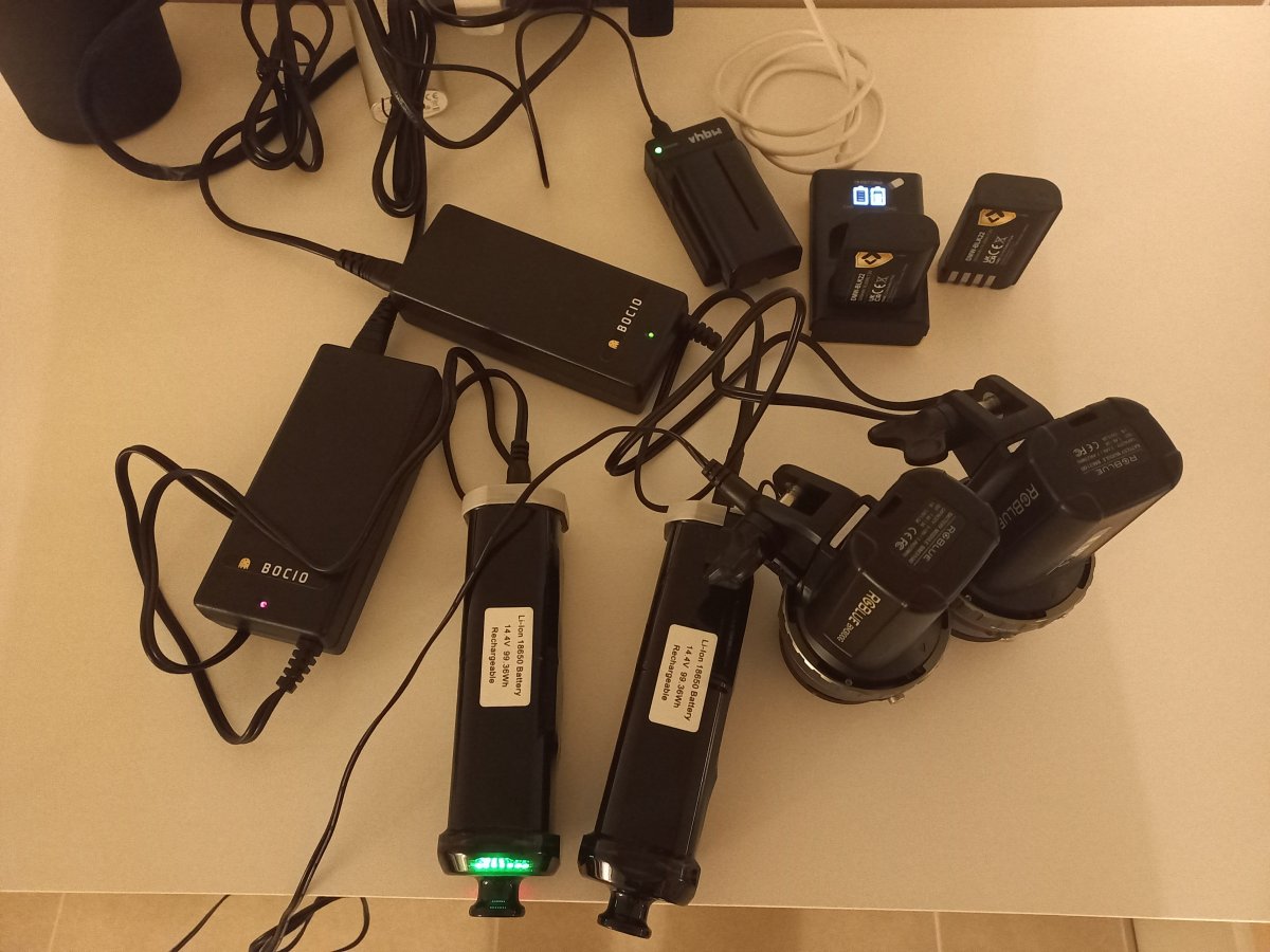

  7. Typical situation with several other gadgets charging around...
