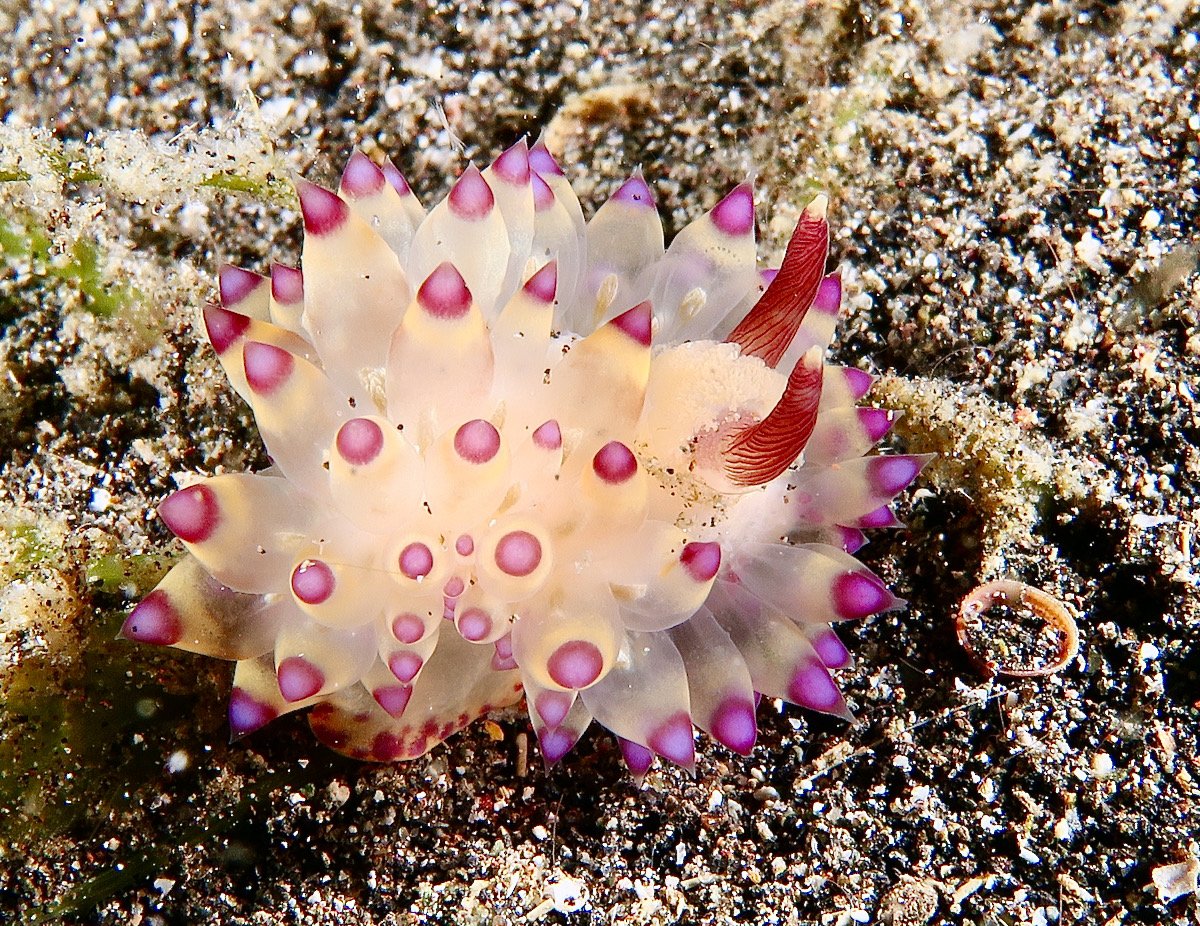

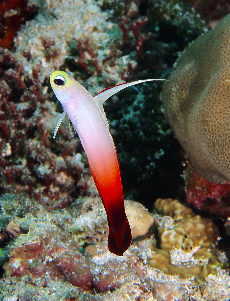

    This is a now vintage album with my RX100 https://flic.kr/s/aHsjZczii3
    I was one of two compact cameras on the boat and my images were on par wit some larger formats I lacked compositional technique otherwise they would have been better

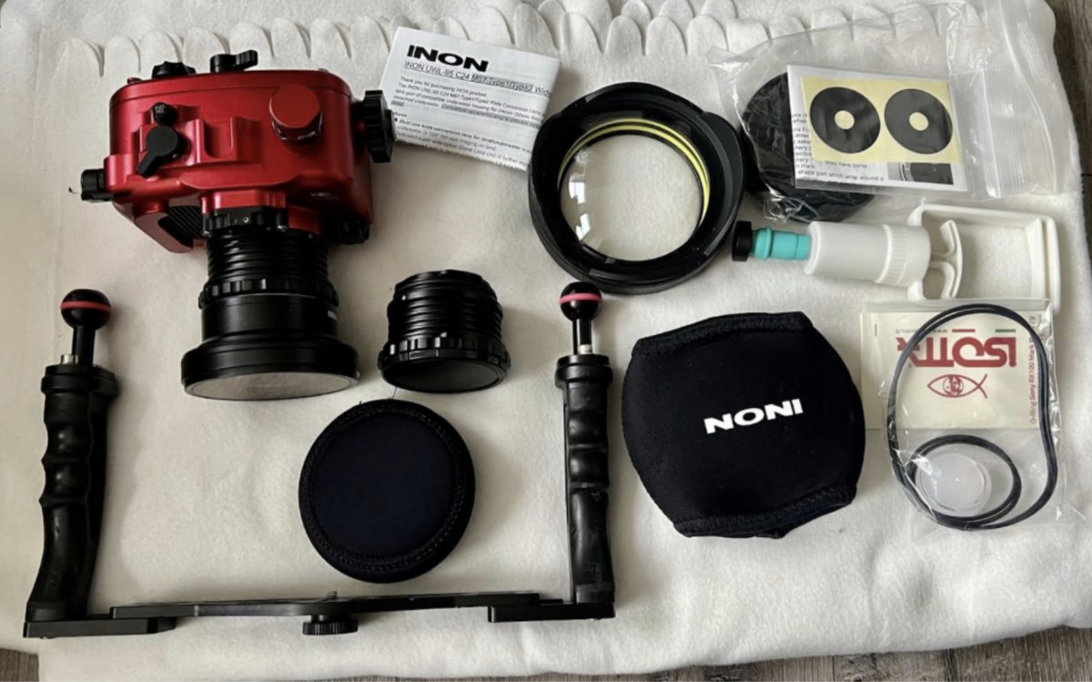

    I had RX100VA in Isotta housing with the INON UWL-C95 and I can say that this is a great combination. Fast, reliable, by far less expensive than most of the mirrorless solutions. Main downside for me was the limited battery life (empty after one hour).
    It works with the full zoom range and external strobes, is small, lightweight and easy to use. If I hadn't been given the opportunity to switch to the new A7 IV with Nauticam I I'd stayed there.
    Many other points have already been mentioned by Interceptor. I cannot confirm slow or weak AF - I had no missed shots. But size matters especially with respect to size of the sensor, and terefore FF is often better but at 4x the price tag.

  9. It has to be mentioned, that you need to transport less weight. In the plane and in the water.
    this is isotta for rx100
