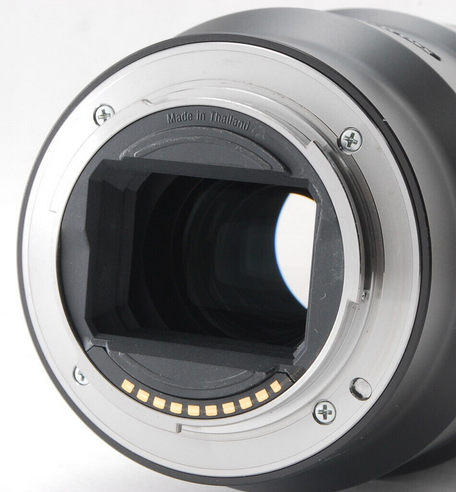

    This is the back end of a Sony 90mm:
    I haven't tried it myself, but eyeballing it, the protruding element of the TC simply won't fit into that rectangular window.

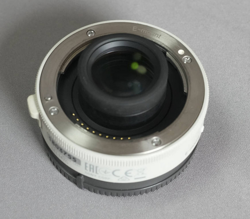

    Edit: The back end of a 70-200mm GM:
    SEL14TC:
    The protruding element is way too close for the contacts to fit into the SEL90M28G. You'd have to grind away parts of the baffle to make enough room for the TC to fit through, and it's right next to the control wires passing through the same plastic part.
