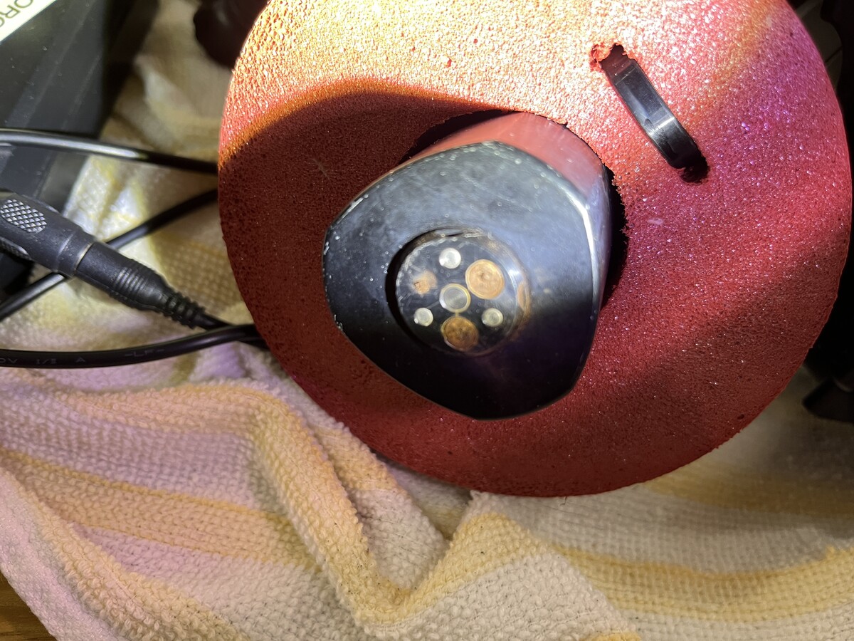

I have an Orcatorch D910V video light. It has worked fine for several years but when I took it out to charge for a dive trip in March the magnetically attached charger wouldn't stick. Looking closely it became apparent there were several rust hills forming that held the charger too far away for it to stick on. Here's what it looks like now:
The three gold colored spots are the rust hills. The three smaller silver spots are the charger contacts. After scraping away the worst of the rust I got it to charge and took it on the dive trip where it worked fine as usual.

Just to clarify, are the contacts shown are outside of the torch? I would expect that the rust is from the magnets used to hold the charger in contact with the terminals. I would think that just scraping back the rust and also considering sitting the contacts in a citric acid solution it would cleanup nicely. Iron oxide aka rust is soluble in citric acid but it won't dissolve the iron that has not yet rusted.

Chris, yep, the contacts are external and attach to the charger by magnetic contacts. We tried removing the rust but the contacts, or the fitting, seems to be misshapen by the rust or some other action and the magnetic contacts won't adhere.

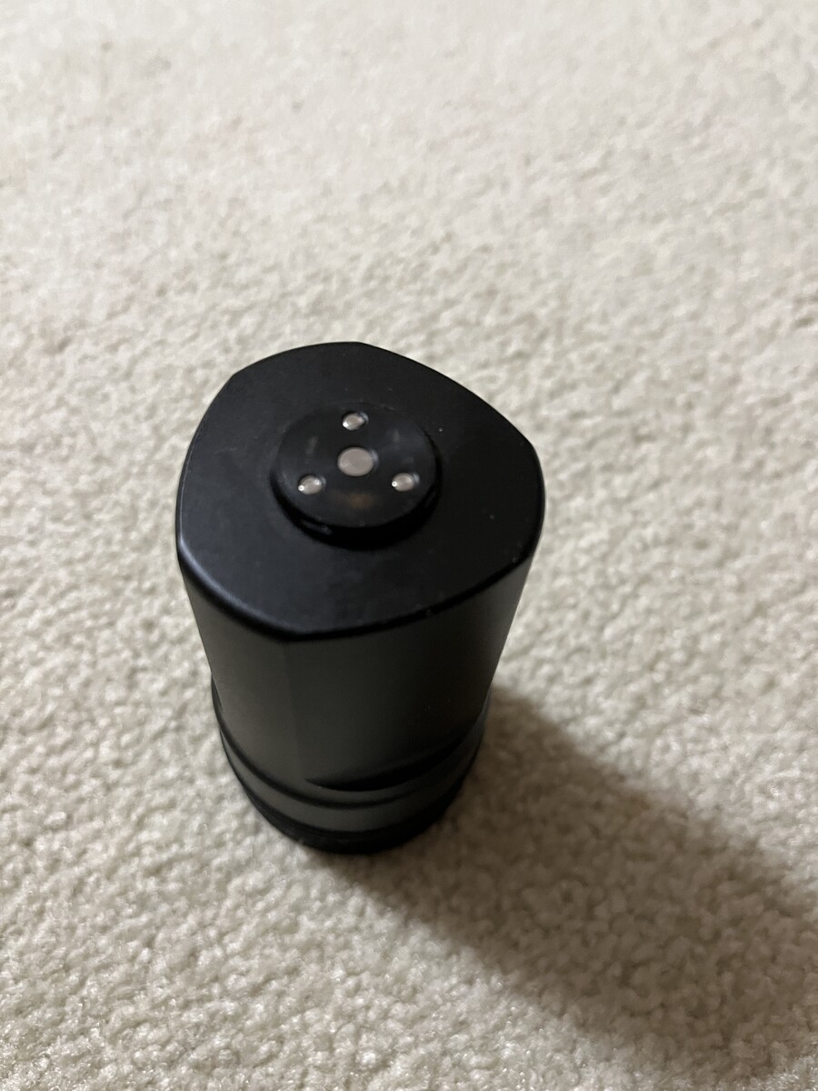

OK - the new Orcatorch B90 battery arrived:
It looks identical to the 4+ year old original and seems to be charging OK using the original charger.

The problem I experienced with the old battery was that the rusted magnet areas swelled and got thick enough to prevent the charger from making contact - in other words, the rust bumps pushed the charger away from the battery contacts. After I scraped enough of the rust bumps away, contact was made and the charger did its job.
