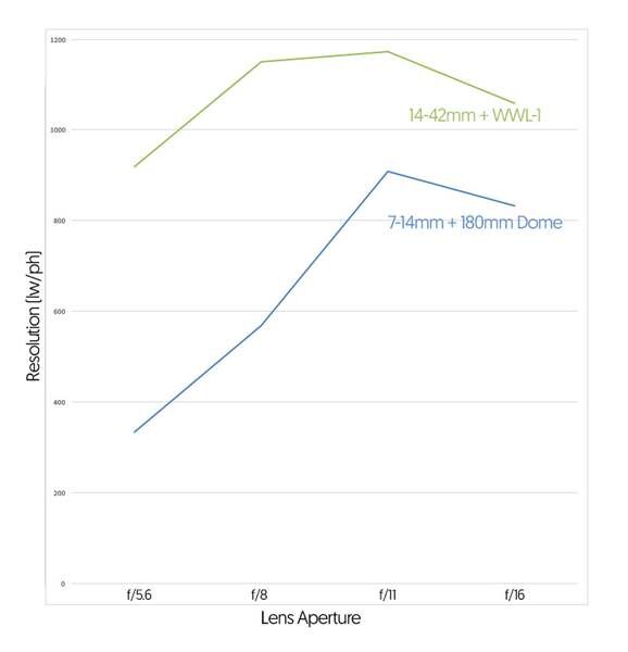

A closer look at Backscatter’s 2026 strobe test: corrected charts and additional measurements
Good points, surely a lot of things to consider. A pitty that the review ends with an advetisement, which undermines the feeling that the text was written from an objective perspective. The best thing that could happen is that the tecnicians of both companies would sit together to make a improved version.
