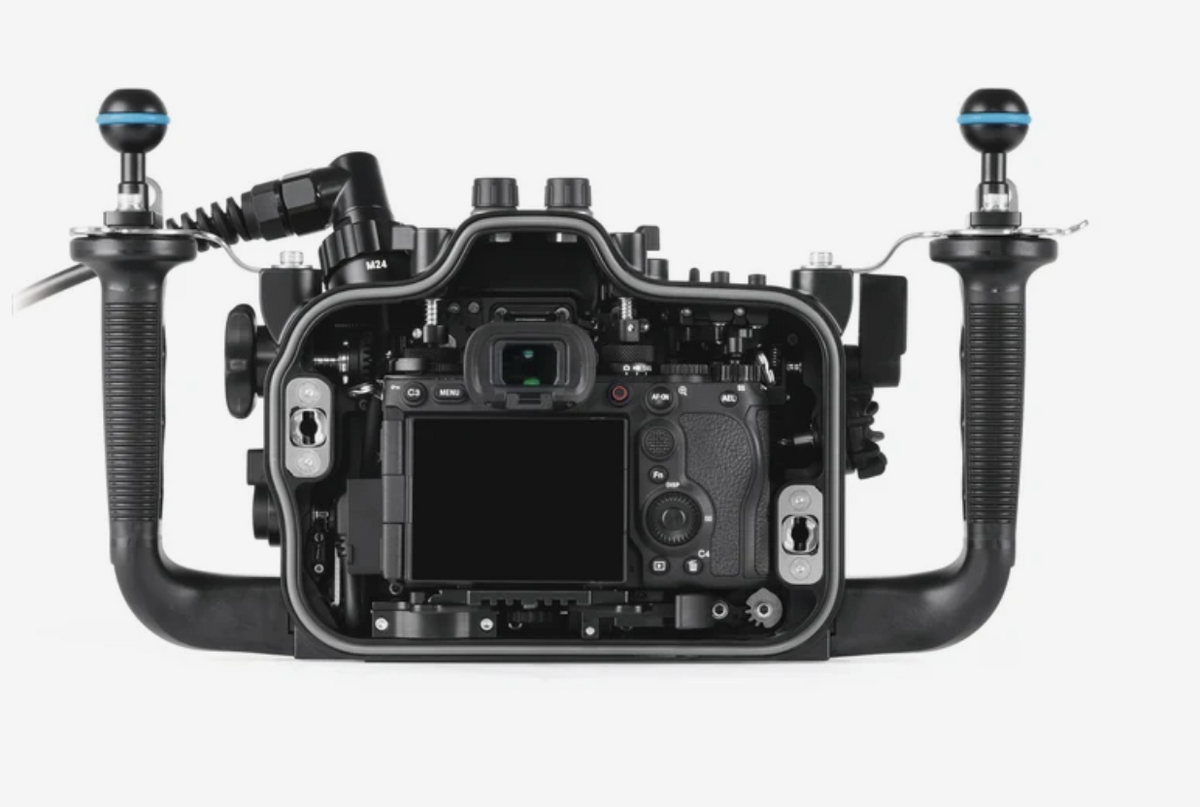

  2. Hi RomiK, Thanks for getting back to me! Nauticam confirmed that the cable exits from the underside, leaving the USB-C port above it unobstructed. See the attached picture. I've also got a custom USB-C bulkhead on order that uses the Nauticam M14 offset adapter, allowing both the vacuum valve and USB-C connection to share the same M14 port. Fingers crossed it all works out! I typically don't monitor with a LUT, relying instead on scopes to judge exposure. RAW S-Log3 certainly isn't the prettiest thing to look at, but as long as my framing is right, exposure is correct, and white balance is reasonably close, I'm happy to make that compromise and handle the rest in post. Your point about the FX5 is valid, and I actually have one on order. That said, I really enjoy the flexibility of switching between stills and video during a dive without having to commit to one or the other beforehand. Thanks again! Peter

  4. Hey everyone, I’m upgrading my Sony A1 II rig for RAW recording and have the Nauticam HDMI 2.0 cable assembly on order. Has anyone used it with a USB-C cable connected to the camera at the same time? Does the HDMI connector obstruct the USB-C port directly above it? My current HDMI 1.4 connection leaves the USBC port clear. The reason I'm asking is because I’m working on a custom USB-C charging/data bulkhead installed through the Nauticam vacuum valve offset connector. The goal is to charge and offload files without opening the housing or releasing the vacuum. I’d appreciate any firsthand experience or photos showing the clearance with both cables installed. Thanks!
