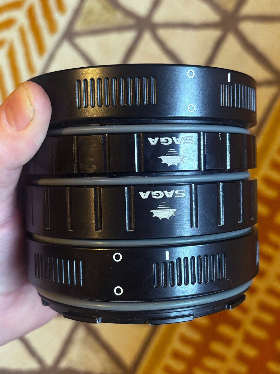

  21. Quick update on the ports. Nauticam's new port for the lens made it to Lembeh today - and it obviously fits the 100mm perfectly. I've only tried it briefly, but the 90mm port is problematic - as the front part of the 100mm lens does not fit neatly into the inside of the Nauticam port for the 90mm, so the lens ends up not being able to get right up to the front glass. Which won't be an issue for most things, but I suspect would impact using the EMWL. I will test more in the coming days. I have a shorted Nauticam flat port here (32 - I think) - which accommodates the front of the 100mm lens better. And this plus a lot of a port extensions might be better for accommodating multiple macro lenses, while keeping travel bulk down. Ultimately, though, the new 100mm port is not heavy - so maybe the best thing might just be biting the bullet and getting the new port. Although as Pietro notes above - maybe shooting through water limits how far this lens stands above the 90mm Sony - and especially the 90mm Tamron.
  22. Nauticam's own tests with their dedicated port say UNIT 3 is best. It will be tricky to get it to work with a converted port from the 90mm as the spacing has to be perfect to avoid vignetting. UNIT 2 works too, but with some very small vignetting at some focusing distances. I'll test it with Unit 3 this week - assuming I get the port. But if I am using the adapted 90mm port I'll probably just stick to testing the 1.4 x TC (I don't own a 2x), MFOs and SMCs this time. Been busy testing other gear so far this trip so far.
  23. One thing I meant to say yesterday was to always be careful when lenses end up very close to the glass - I’ve seen a few times problems when the housing compresses underwater (more port sections - more o-rings - more compression), the port then pushes the lens and camera back in the housing enough that the push buttons on the back of the housing start activating.
