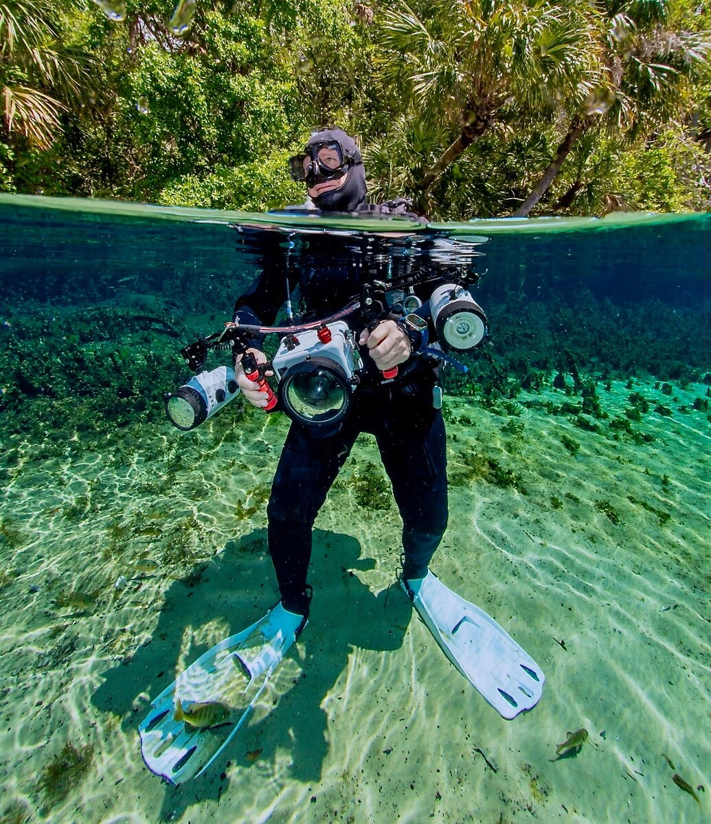

  5. Many dismiss Ikelite as an alternative but the DLM (Dry Lock Mirrorless) housing is small.....I used one for years with the small Canon SL1 series of APS-C cameras and now have one for the APS-C Canon R100 24 Megapixel camera. 3 trips so far using it with zero problems. My test configuration before Palau late March :)
