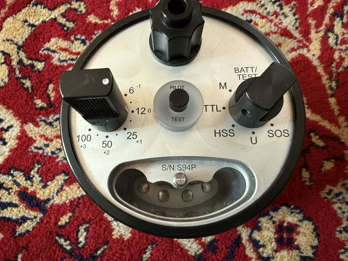

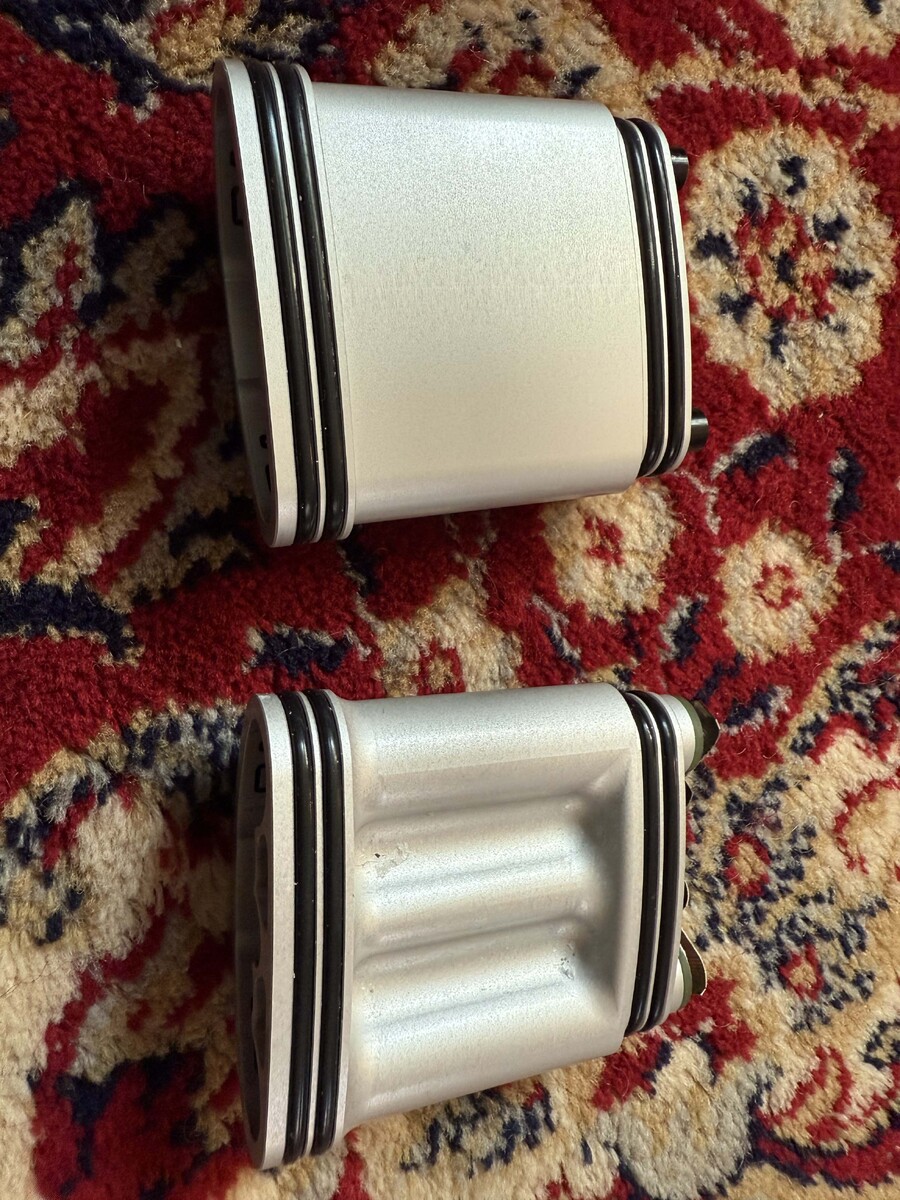

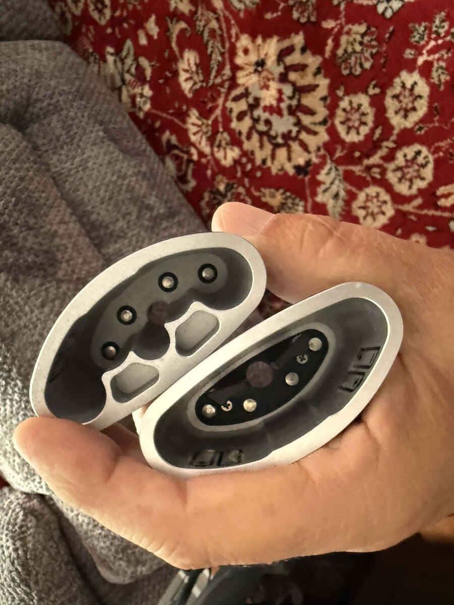

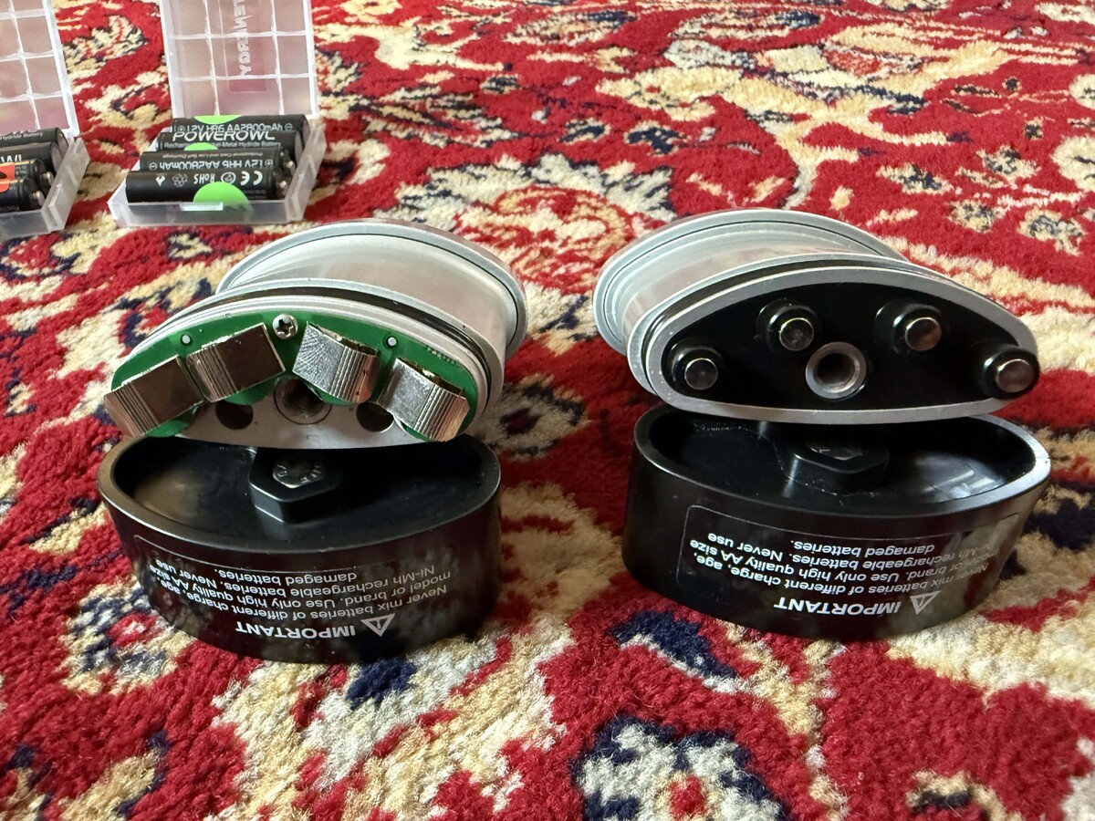

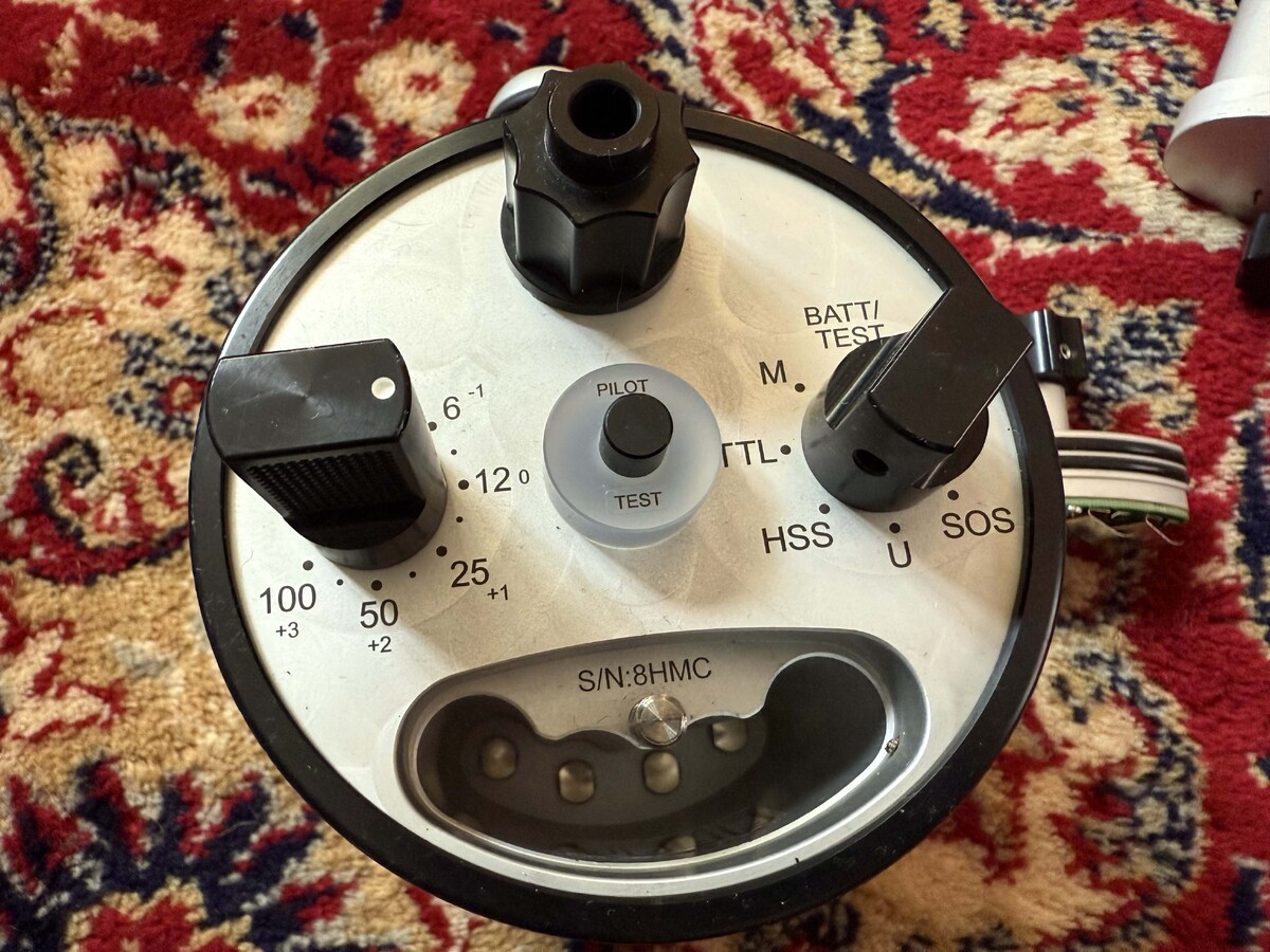

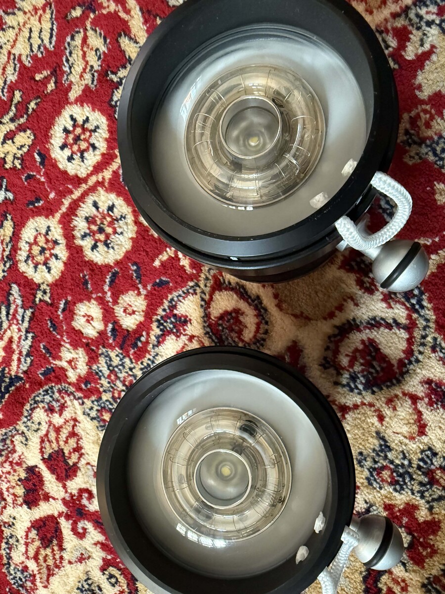

FS: Retra Pro X strobes with many accessories

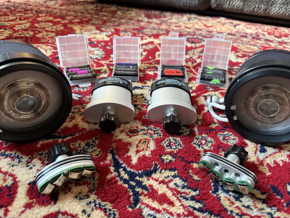

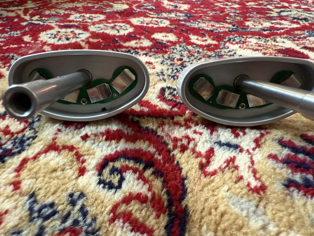

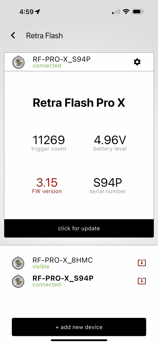

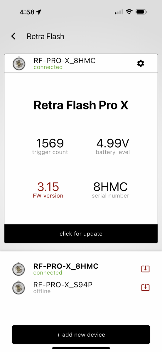

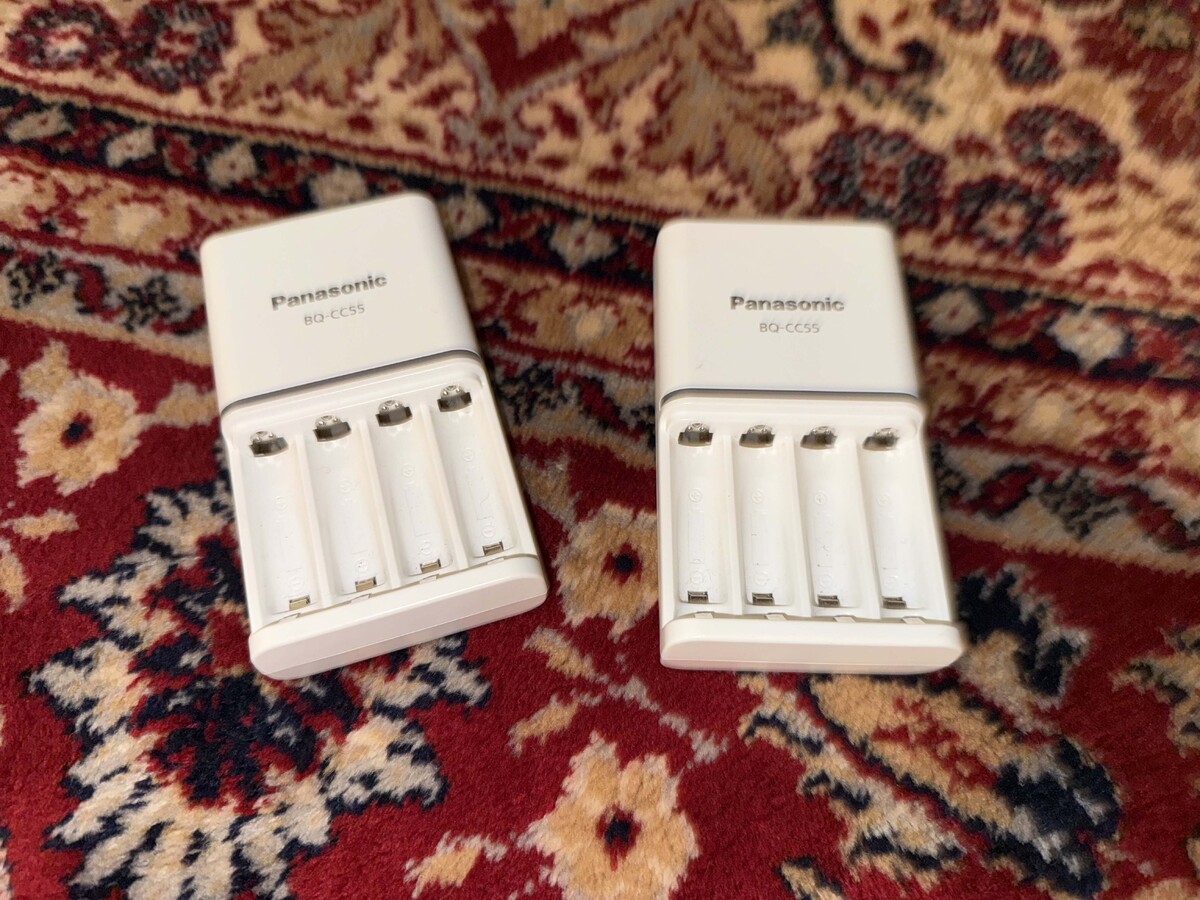

Selling my Retra strobes, both are in good condition, fully working, and never flooded. The strobes come with the front and rear bumper rings, the neoprene jacket, and the battery extensions that raise the cell count to 8 cells per light. You will be receiving this as I dived it, so the sale includes two quick battery chargers, 16 Eneloop high capacity batteries, and battery storage / transportation holders. Asking $1800 for the whole rig. Gary
