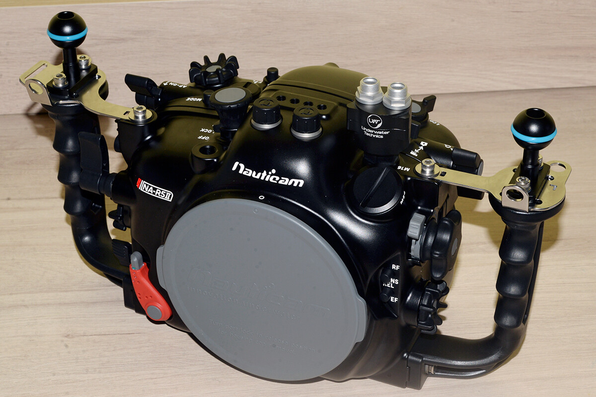

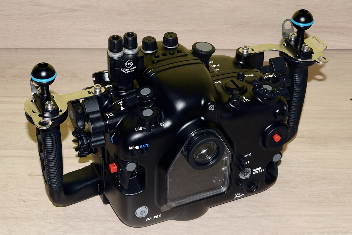

  10. External TTL Converter 18023-M24 for Sony, installed on the MARELUX housing. (Photo by Phil Rudin)

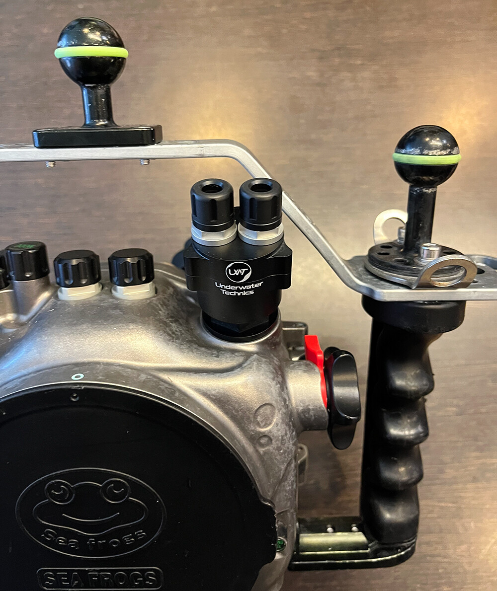

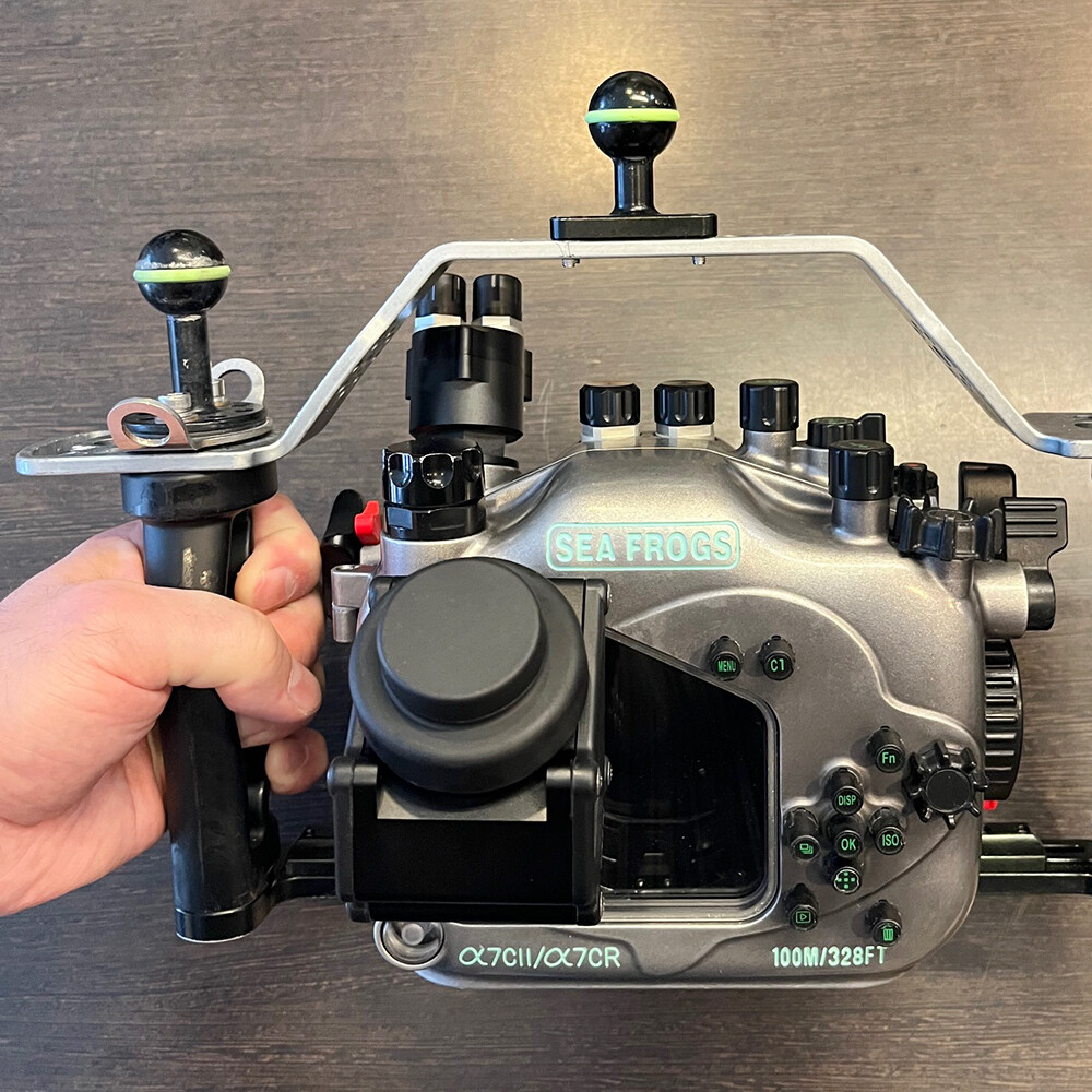

  14. Hi Brad, As i understand it, this is a second-hand TTL Converter for A7 camera, purchased together with a housing recently. You don't know the year of issue, so the circuit version is not clear enough. According to the photo, it looks like product of 2014 year. So, initial owner probably started to use it 12 years ago. But nobody knows if it works or broken now. I can help you with some information and User Manual. That circuit had a little bit different schematics than modern versions, and It did not have a separate profile for Z330 yet. Switch position "6" was reserved (empty) there. But you can use any existing similar profile, for example Z240 (switch position - 1). It is not the same, but will work. You also can try another profiles, according to the User Manual that i sent you by email.
