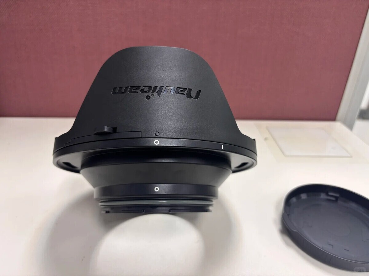

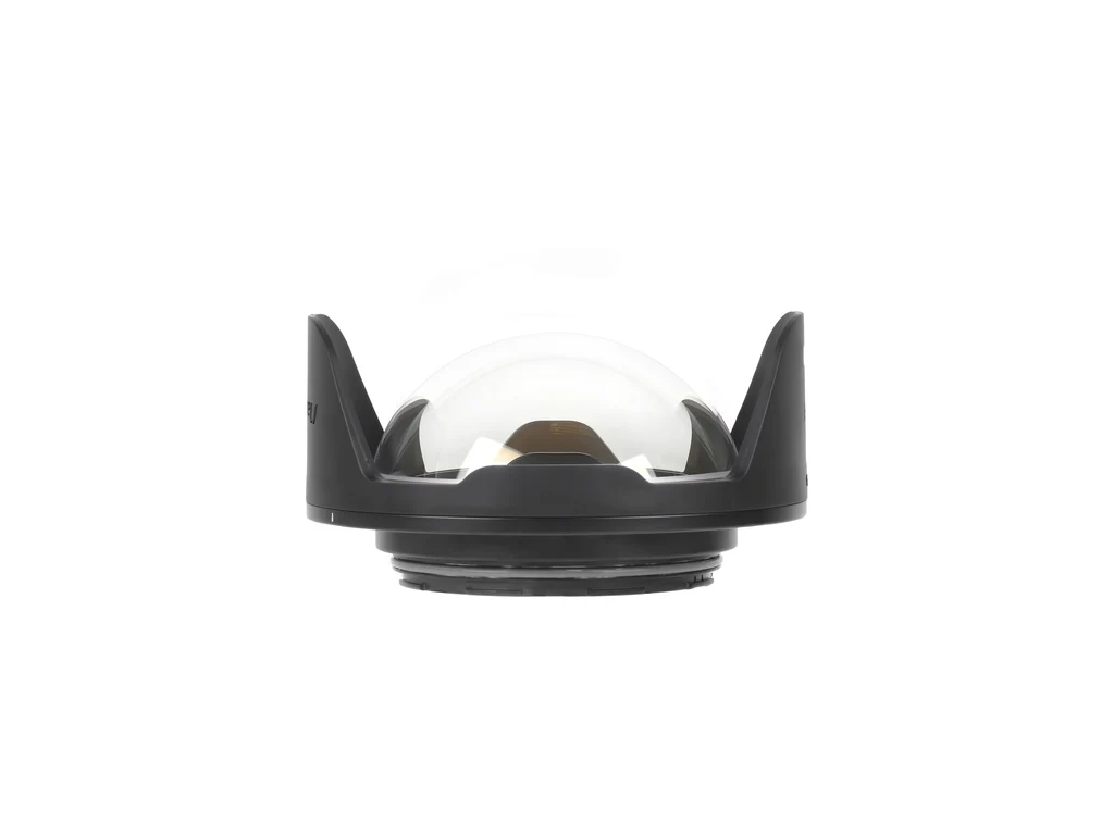

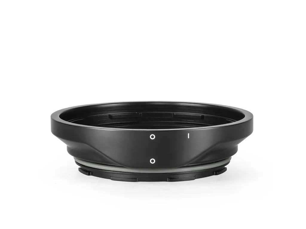

Confirmed: Sony Fisheye Zoom 8-14mm
I don't believe the extension is "built-in" it looks more like the #37306 N100 to N120 25mm port extension combined with the #18816 140mm port with removable shade II used for Canon RF 7-14mm fisheye. If not that extension something shorter than 35.5 rather than longer since the 8-14mm lens is shorter than the Canon 8-15 with adapter.
Nauticam already lists the old port using N100-N120 35.5 extension. The only difference is the port shade for the old 140 has four Allen screws to remove the shade and the new 140 port now has a bayonet mount to remove the shade. Both ports appear to be N120 and the new port just has a different N120 to N100 extension mounted on it. Two threads going on this topic, one here and one in general chat is making this a bit confusing.

New Sony Fish Eye
Regarding the new port chart the NEW N100 140mm II (#37188) with removable shade now appears to have a bayoneting shade while the older 140mm N120 has a shade where you loosen Allen screws to remove the shade. The new Sony N100 port appears to be the N120 140mm (#18816) II also with bayoneting shade for the Canon 7-14mm fisheye lens with a N100 to N120 adapter added. It will be interesting to see if the extension is fixed or removable and the same 35.5 mm length recommended for the old N120 140mm port with the Sony 8-14mm fisheye. Both ports, N120 and N100 (assuming the extension is included) retail for $1600.00.
