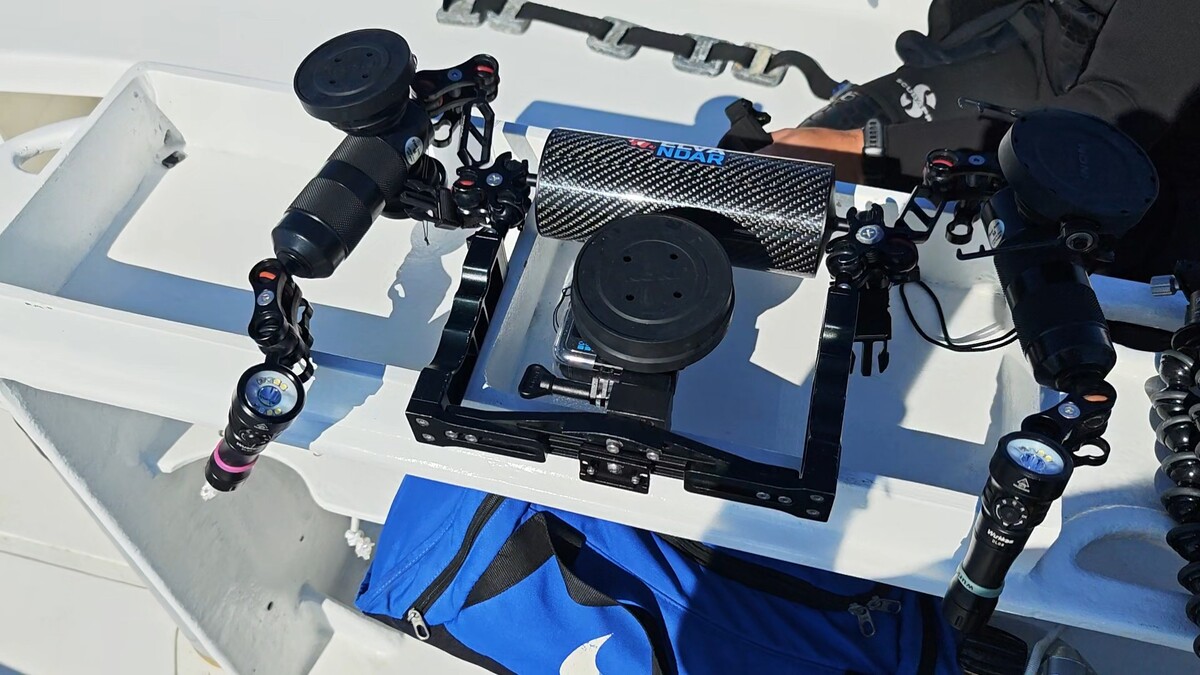

Pimp up your GoPro
I am a bit late to the party, but here my pimped GoPro, for macro, super macro and wide 😁 Lenses: Inon G55 (super macro) Inon G165 (macro) Inon G140 (wide) Tray, main floater, clips and the 2 short arm from AliExpress (really cheap, but served me well for 3 years) 2 Arm floater with lens holders from inon Tripod from Joby (5k version) Torch DL08 from wurkkos Torch here On my Instagram you can see some of the results (I have that problem, the one that I like to shoot a lot of cool video, but edit just a small part of them 🫣) Insta: Elvandar
