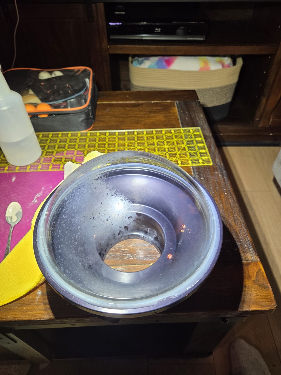

Everything posted by ScubaBC
  1. Ok, just FYI for anyone who may stumble upon this thread. The cerium oxide powder works like a hot damn. It's taken me an hour and I have 1/2 the dome done. Scale is completely gone and the dome looks like new. I haven't tested the optical quality underwater but if it's truly not-coated on the outside then we're good. I'll post some photos of the dome once it's fully done too. For those wondering what product I used, it was a 99% pure cerium oxide powder (photo attached), I added a little bit of powder into a bowl, mixed in some water to get a paste like consistency and then worked it into the dome using a Costco kirkland microfiber cloth (yellow ones) in small circles and then back and forth and then small circles over and over, lol... It takes a TON of elbow grease but it definitely takes off the scale, I am pretty impressed.
