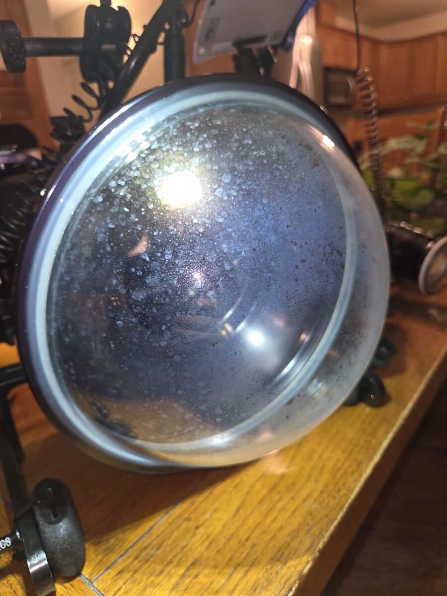

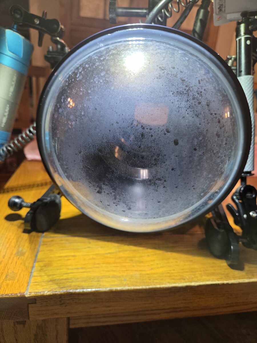

Hello,
I have a very cloudy exterior film on my Aquatica glass megadome. Possibly salt etching? or the exterior coating is done? Most of the time you cannot see it in my video when underwater, especially when using my lights but when trying to film ambient or at the higher base ISO of my camera (12800) it's very noticeable.
Any ideas on how to correct this? I have a couple trips coming up this next week, but after I am back I may just send it to Aquatica to have new glass put in. This dome is only 2 years old. I did try a claybar for auto detailing, that did nothing. I've tried vinegar/water that also did nothing. I have ordered some cerium oxide powder and will try that. I know Aquatica uses BK-7 mineral glass but I am unsure if they have an external coating on the dome. I did some searching but couldn't find a solid "how to" to repair this. I do rinse my gear after every dive but my rinse water is from my well, so this may be an issue too.
Thoughts?
And get yourself a supply of distilled water for soaking your camera. That hard well water is depositing minerals like calcium which is causing the spots on your glass.

Ok, just FYI for anyone who may stumble upon this thread. The cerium oxide powder works like a hot damn. It's taken me an hour and I have 1/2 the dome done. Scale is completely gone and the dome looks like new. I haven't tested the optical quality underwater but if it's truly not-coated on the outside then we're good. I'll post some photos of the dome once it's fully done too.
For those wondering what product I used, it was a 99% pure cerium oxide powder (photo attached), I added a little bit of powder into a bowl, mixed in some water to get a paste like consistency and then worked it into the dome using a Costco kirkland microfiber cloth (yellow ones) in small circles and then back and forth and then small circles over and over, lol... It takes a TON of elbow grease but it definitely takes off the scale, I am pretty impressed.
