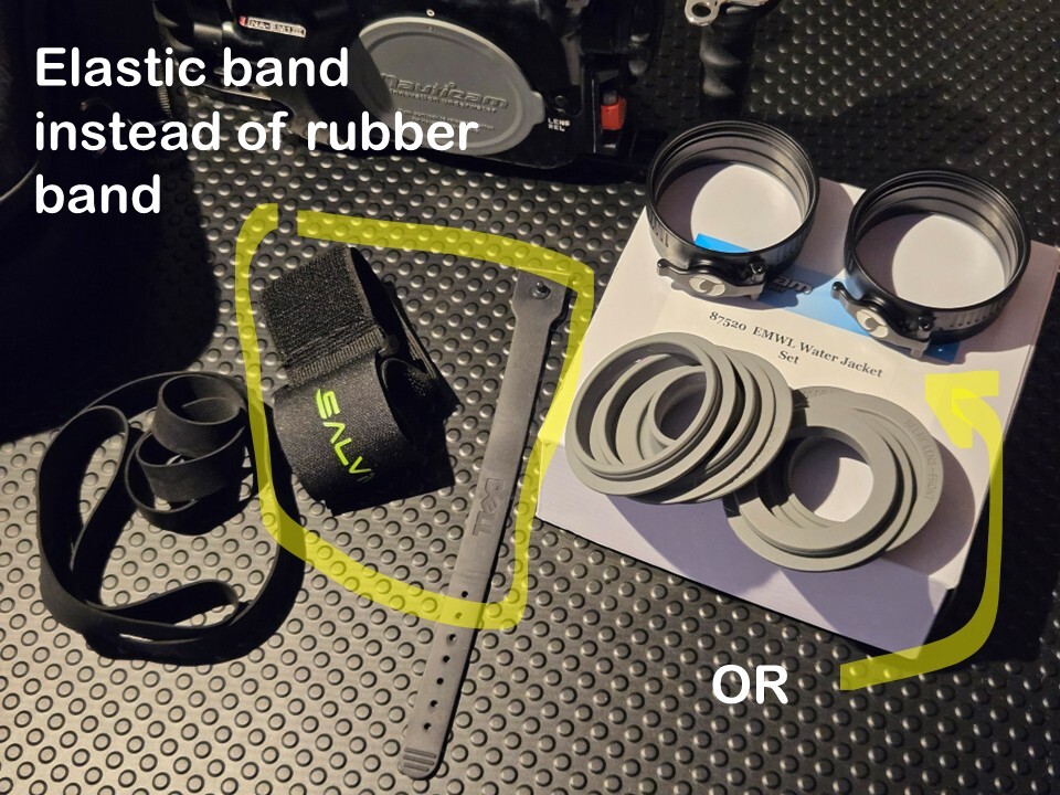

    Czech Republic

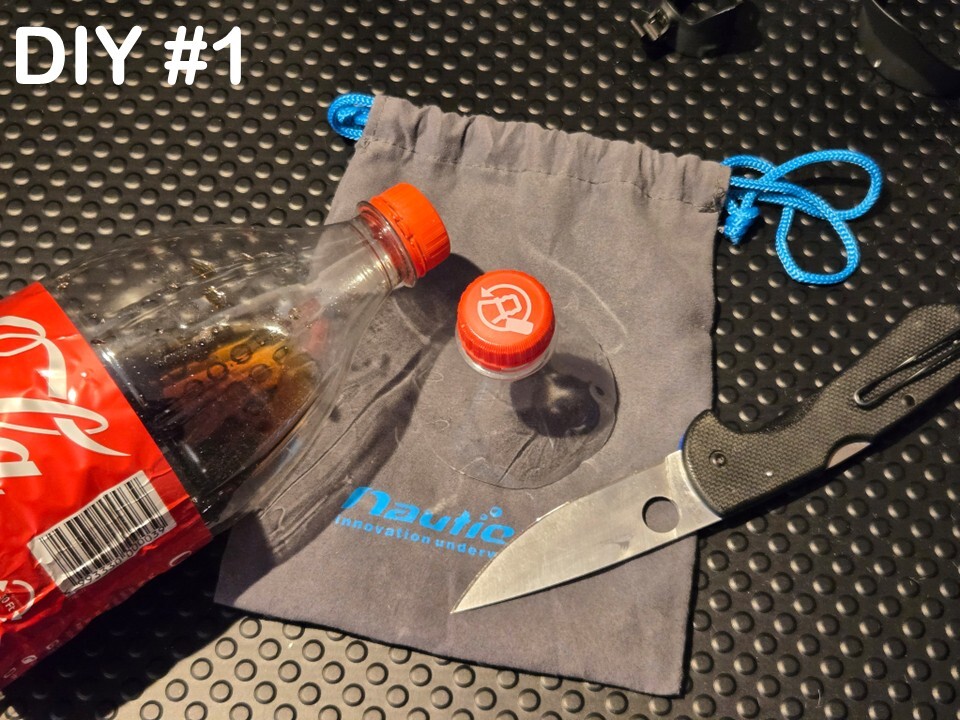

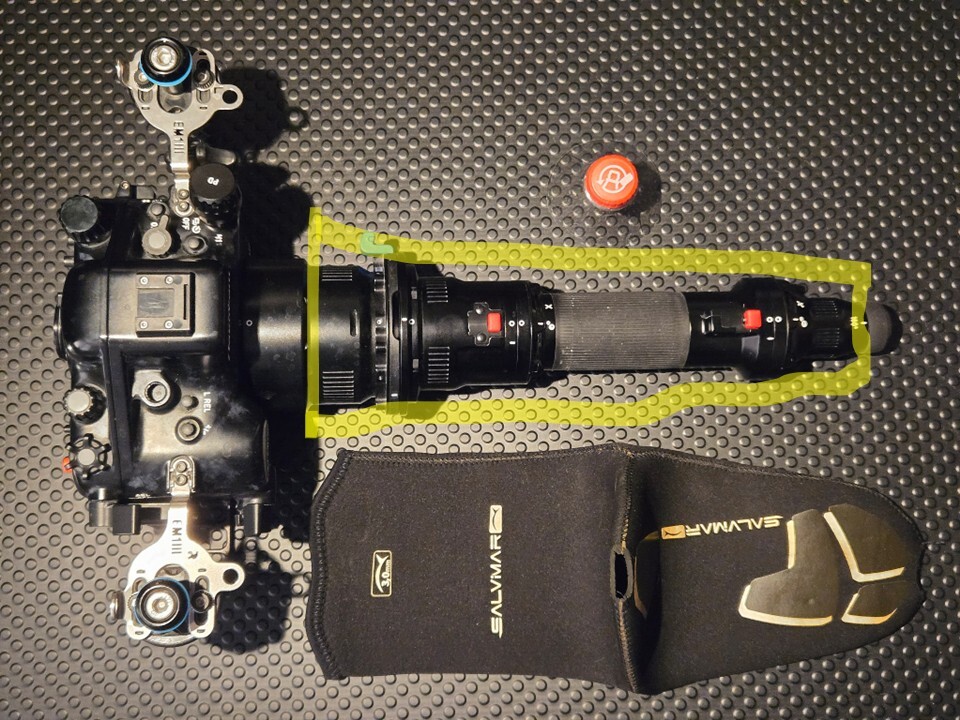

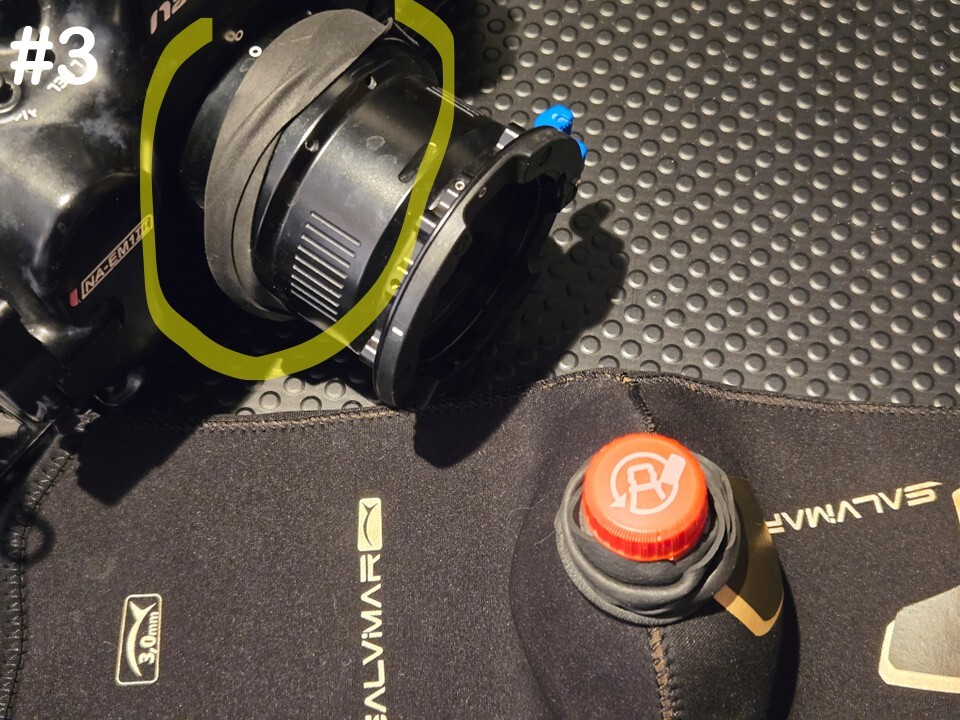

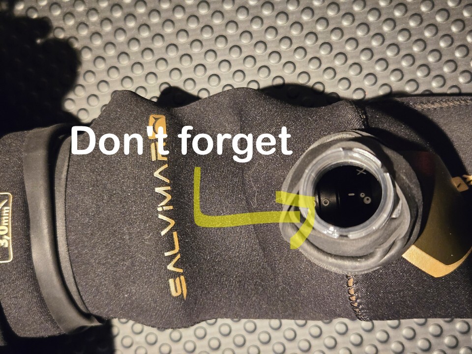

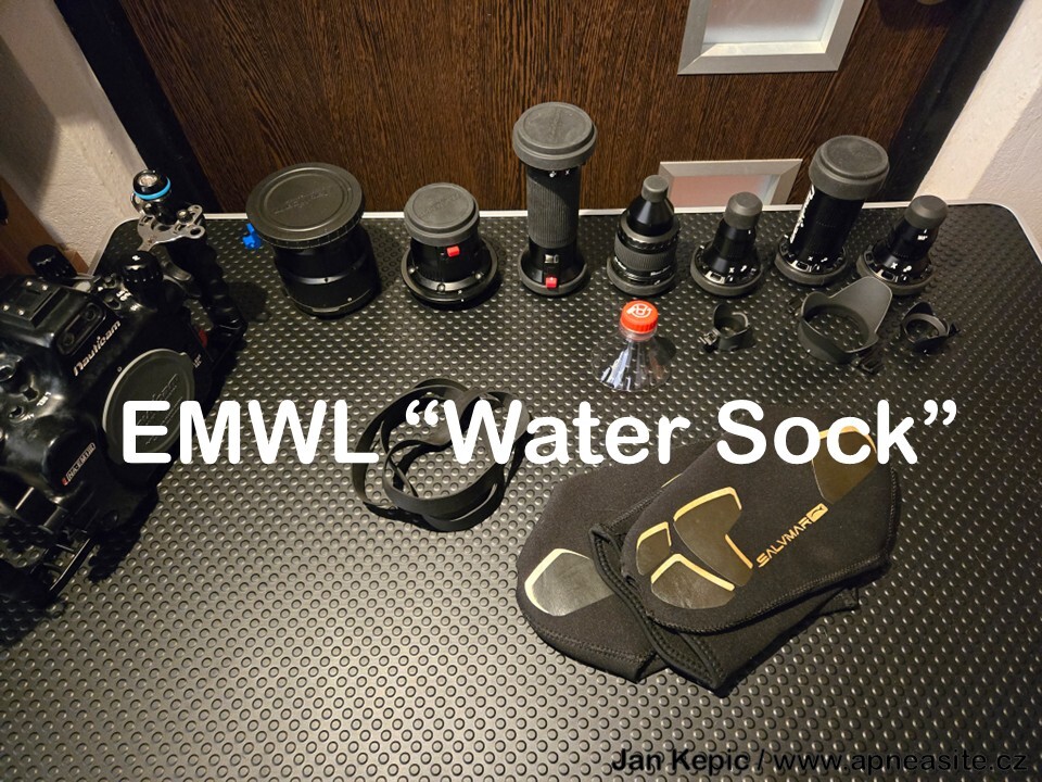

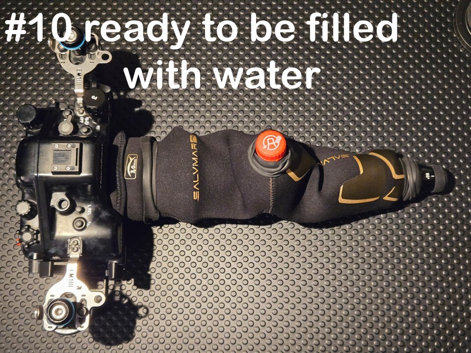

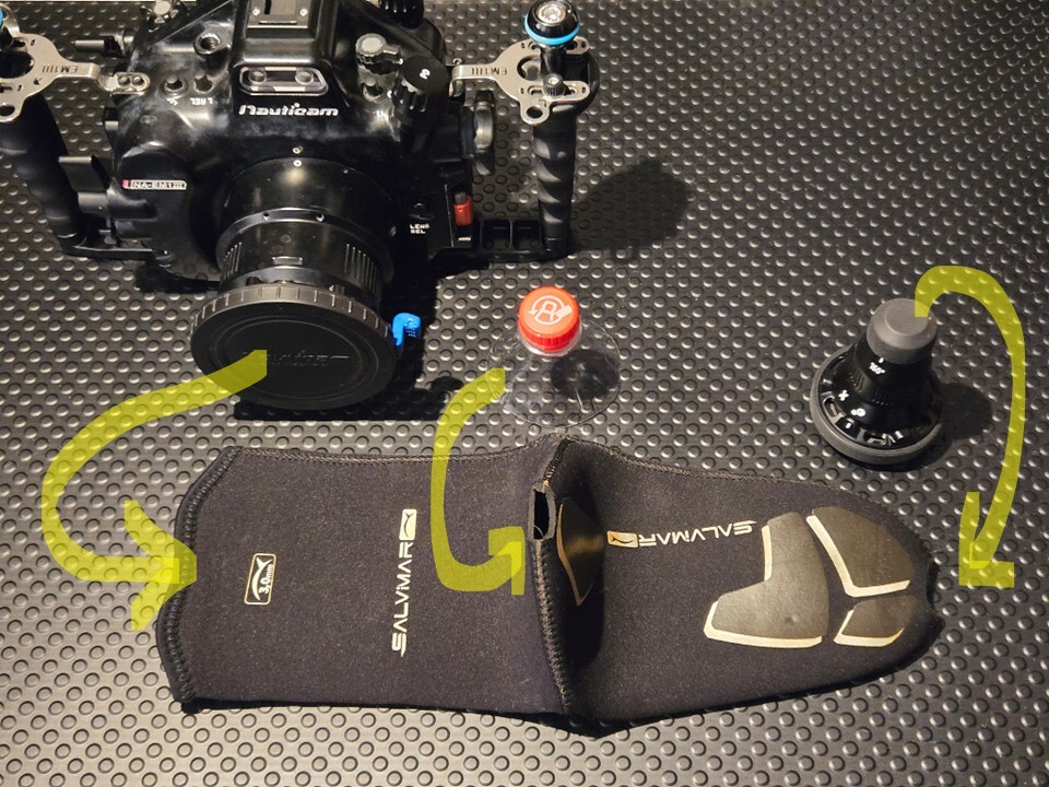

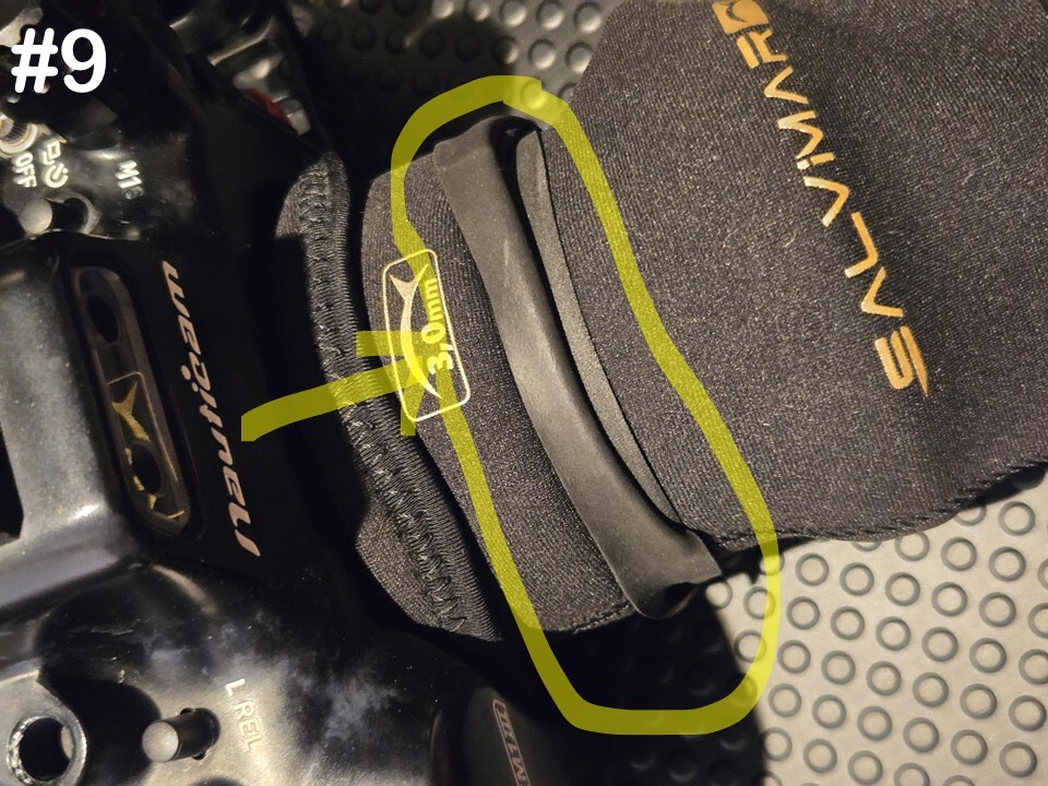

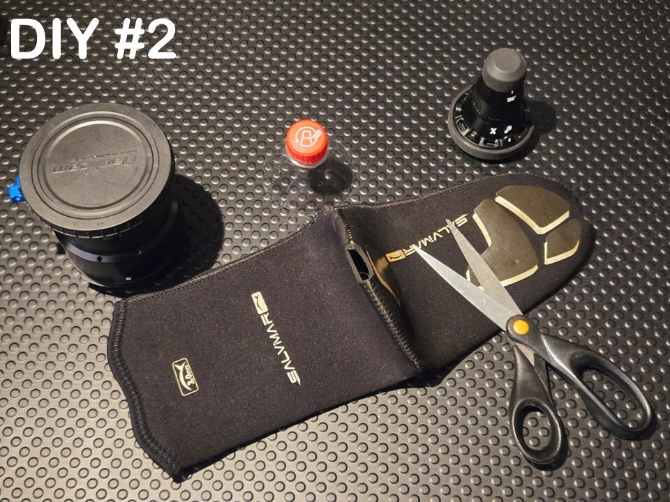

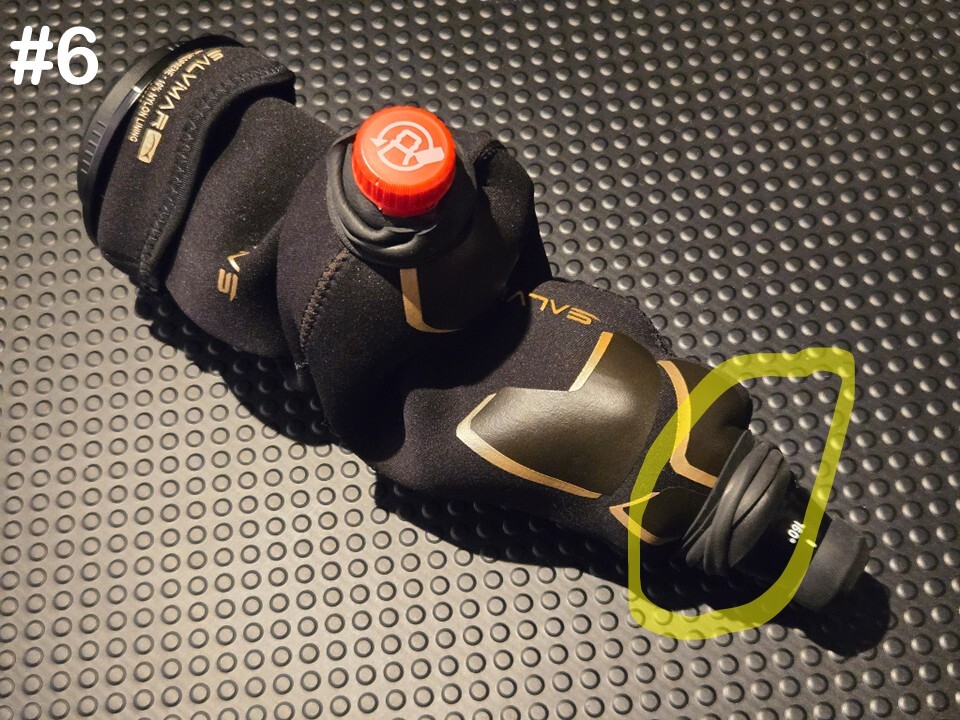

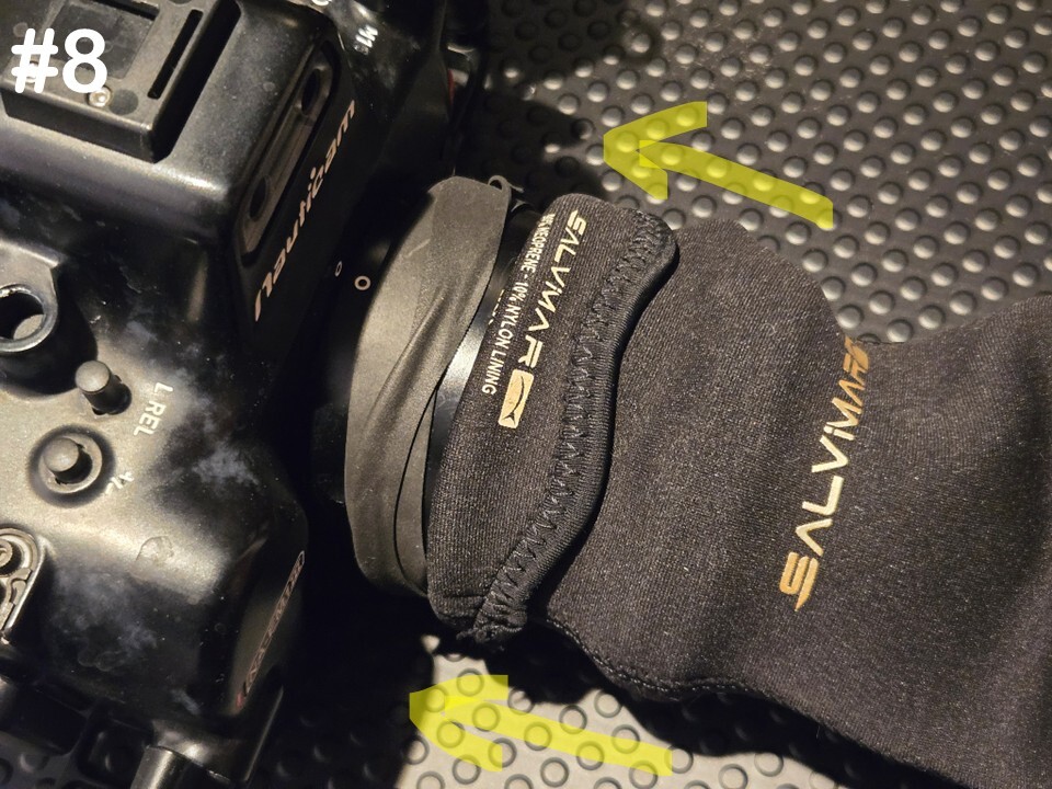

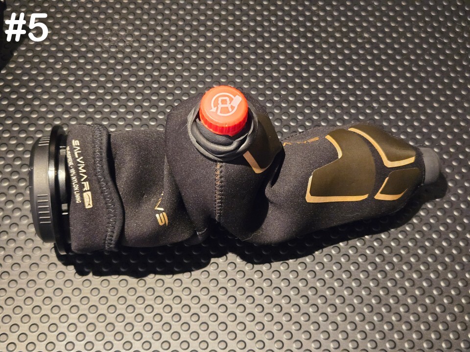

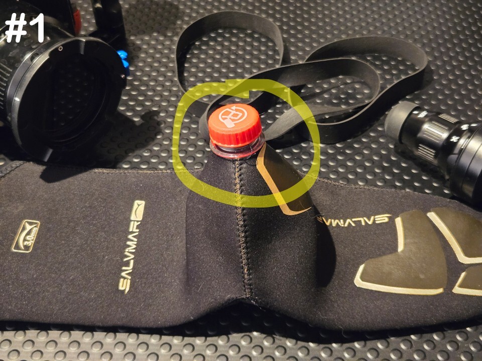

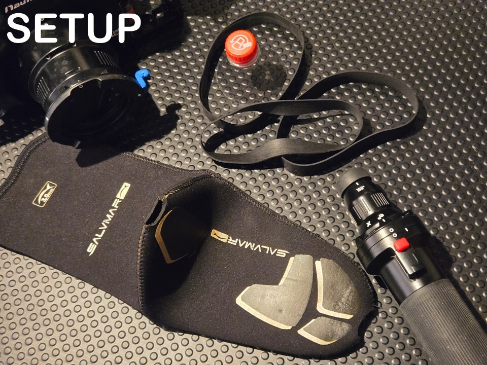

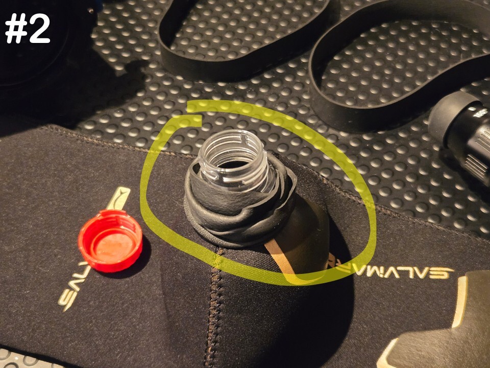

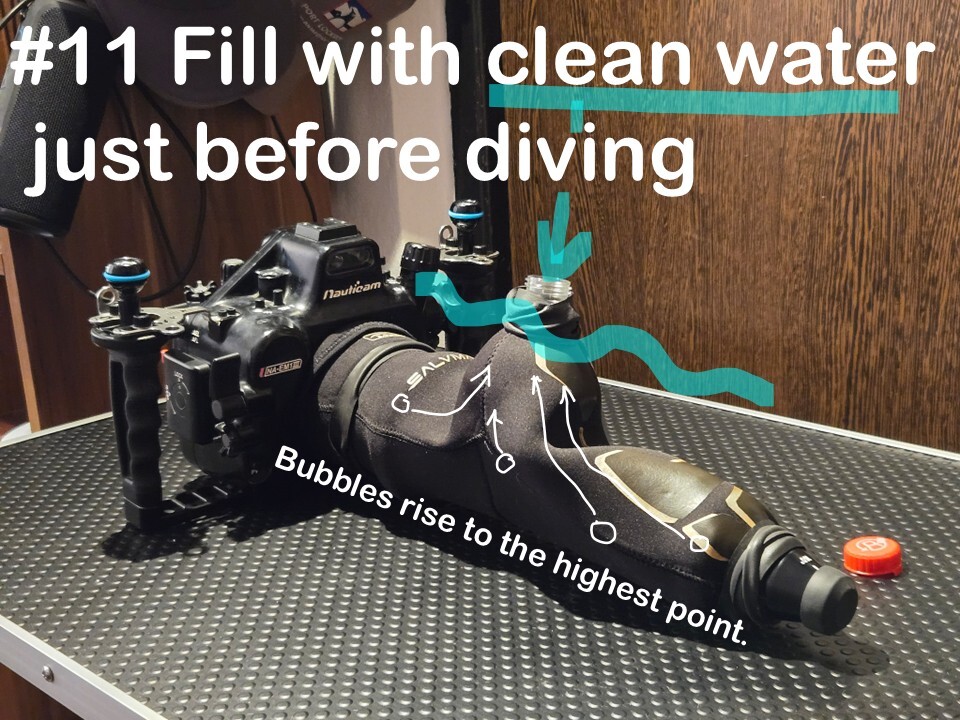

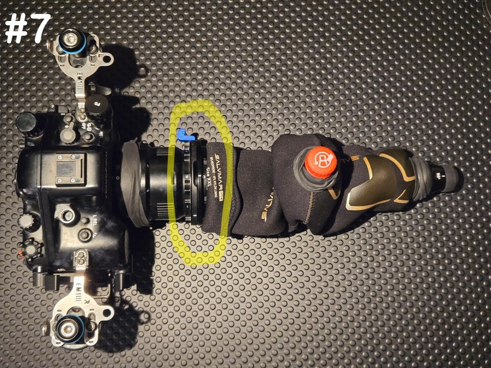

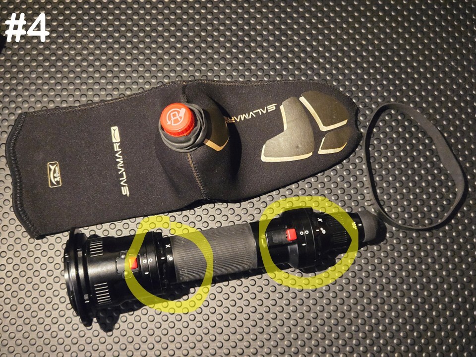

  2. The disadvantage is that it is a fixed setup, i.e., it is not possible to change lenses underwater. I have one sock for 100 + 160 and another sock with a larger opening for 130. I usually bring it to the location ready and only disconnected EMWL from the housing. At the location, I just attach the bayonet, pull the rubber band over the flat port, and fill it with settled drinking water. I can dive with it all day long and the water inside will stay in. Once the setup is submerged, the water doesn't leak out.

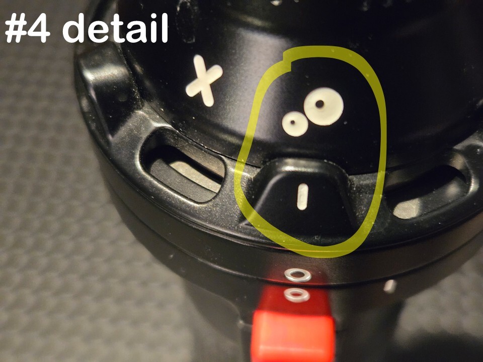

  3. Several people have asked me about this in the past, so I tried to summarize it in this simple HOWTO. I am adding it as images ...

  6. Generally, you have two options. The first is inexpensive and functional, but probably more difficult to handle (freediving sock), and the second is professional, but also significantly more expensive (water jacket). The only disadvantage of the second option is that you won't get as low as you would with a sock. EMWL with sock (DIY)- EMWL with jacket (Nauticam) -

  8. Don't get me wrong. The key word is balance "artificial light should not disturb balance". Do not disturb the scene in an undesirable way, for example by casting two harsh shadows that are obvious to the untrained eye. Alternatively, throwing a shadow in a direction unnatural to the senses (e.g. from bottom to top). Or, on the contrary, depriving the scene of natural shadows. All this is typically undesirable. Of course, everyone may like something different. Anyway, I personally try to make wildlife photography so that the interference of artificial light is not blatantly obvious (especially to the untrained eye of a non-photographer). Of course I don't always succeed. Everyone likes to change things up from time to time, but when we talk about "quality of artificial light" we usually don't mean maximum contrast of the shadows thrown, but rather the exact opposite. Of course artificial shadows are important too, but it's all about balance. At least that's my opinion.
