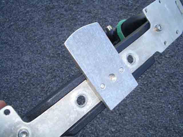

    I already have a 3mm aluminium plate attached under the tray. It is my intention to machine a 10mm thick alloy plate, tap it with a 3/8th bush, and fix it to the 3mm plate with a couple of stainless set screws. The 3mm plate is already a 'donor' which allows me to attach a pair of dive lights, a hand strap and if necessary, a lanyard. I'll post detailed photos later.

  15. Hi Karel,

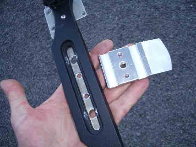

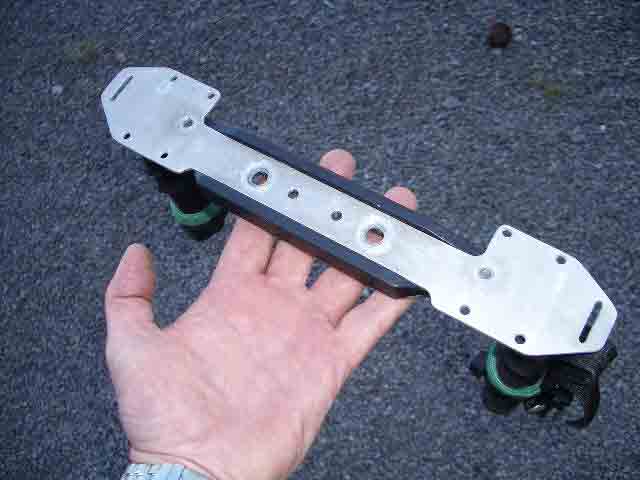

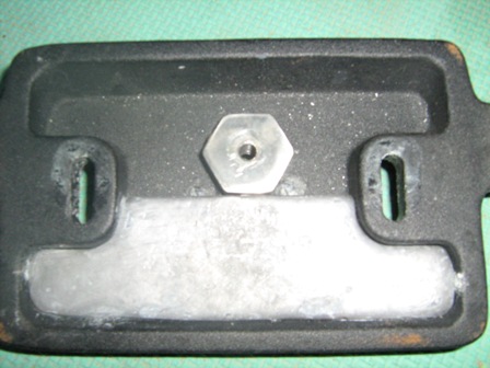

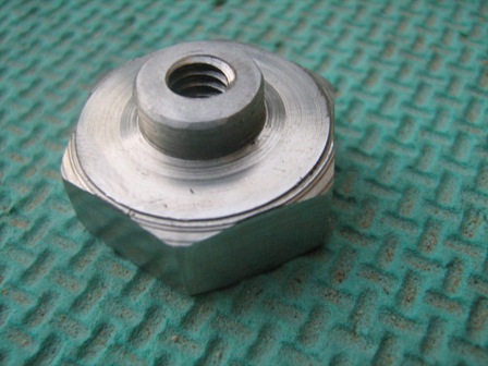

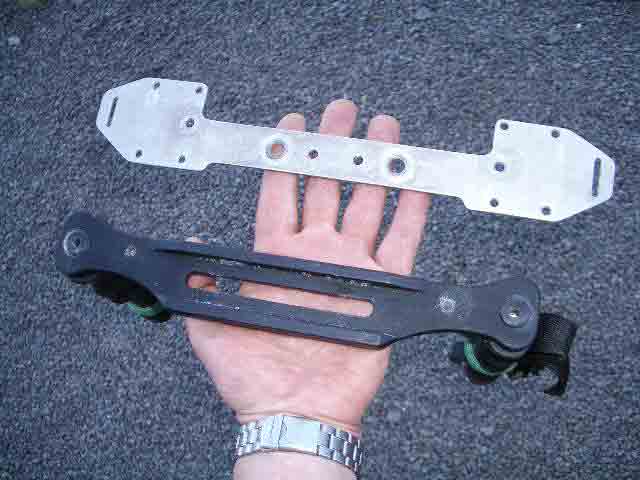

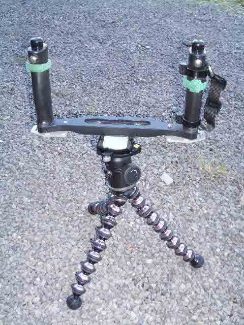

    This is my tripod solution for the Ike tray;
    The photos show:
    1. My original 'accessory' plate which fits under the Ike tray. The accessory plate is made from 3mm aluminium sheet and provides fixings for custom dive light mounts and a hand strap and is secured to the tray with a couple of stainless steel set screws.
    2. The accessory plate fitted to the tray.
    3. The tray, plate and tripod mount.
    4. The tripod mount secured to the accessory plate with two more stainless steel set screws
    5. A view of the tripod mount from below the tray
    6. The complete assemby including the Manfrotto ball head and Gorillapod Focus.
    Hope this helps. Tim
  16. Hi Tim!
    Thanks alot for posting the pictures!
    I went for a bit easyer solution and just modifyed the plate that attaches to the ballhead. Added a bigger bolt and screwed it right onto the armtray. :rolleyes:

  18. Glad you got it sorted out Karel. The Gorillapod is not ideal but it is the best solution, I think, for the travelling diver.
    I'm also very interested in using the Gorillapod to really nail the thin DOF when shooting macro with one or two UCL-165s. Using two of the legs as 'horns' works very well so long as there is dead coral or rock to rest them against. Since posting the photos I have drilled and tapped a 1/4" thread in the tripod plate so that I can attach the Grorillapod directly without using the Manfrotto ball-head. The ball-head restricts composition too much when shooting macro so I'll probably only use it when I'm shooting panos or HDR. Having both 1/4" and 3/8" threads in the mount allows for quick attachment or removal.
