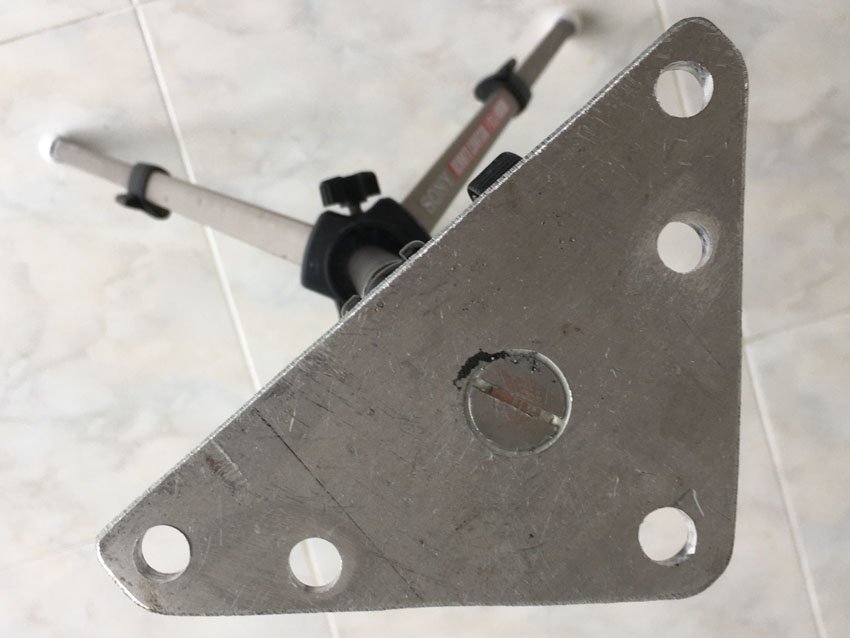

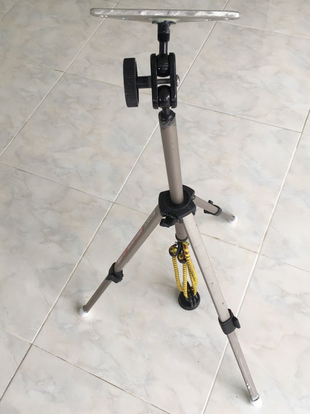

  4. I was thinking of casting resin around a snooker ball to make a plastic ball head, then realised I have any number of ball joints in flash arms. I bought a cheap tripod from a charity shop. cut off the pan/tilt head and ground down part of a TLC arm to glue into the tube. I removed the lower leg section and glued rubber feet on. I put a metal hook into the base of the column which I can tension to a rubber lever-suction cup attached to a pool tile with bungee cord. (In the sea you would need weights.) I cut a 6mm aluminium plate and drilled clearance holes for the 1/4" Whitworth machine screw and the 5mm metric screws in the corners of the plate, (for a NA-D800 housing).  An 8mm countersunk machine screw and epoxy secured the 1" ball fitting to the plate. Bits of TIG rod silver soldered to the screws allows me to attach the plate without tools.

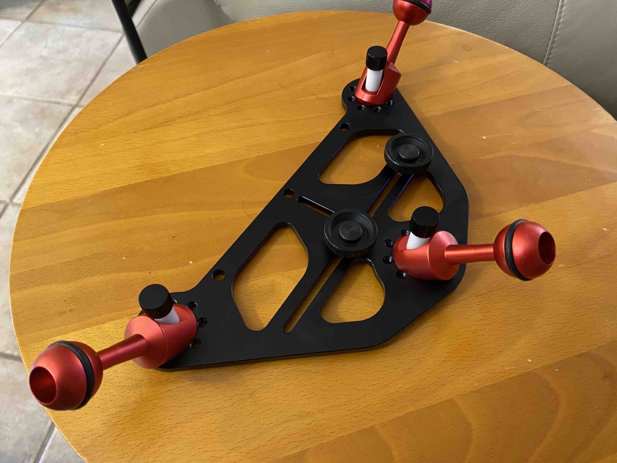

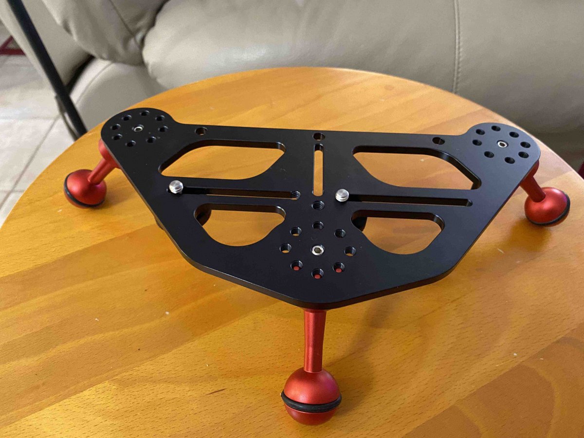

  9. I have recently purchased a very cheap but well-made aluminium tripod base from BGNing (on Aliexpress). I haven't tried yet underwater but it's quite sturdy on land. It was 40 Euro including shipping.
    If used for macro, I would arrange the camera on the opposite side
    Good advice, thanks!

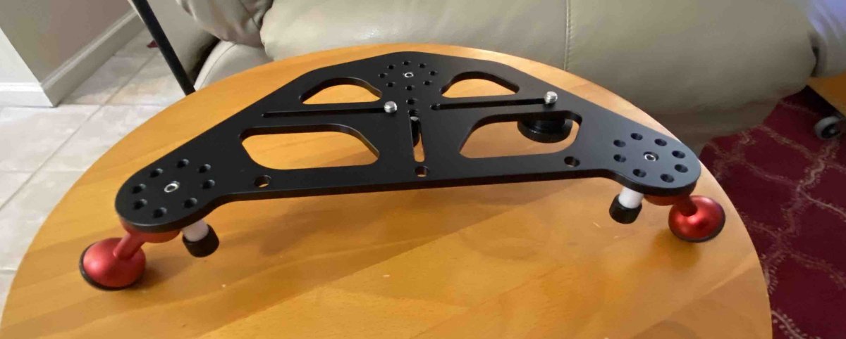

  12. I just received the BGNing plate mentioned above. Looks promising and cheap.  I can recycle some of my older strobe arms and ball clamps. looks sturdy to either mount Gimbal/ball head or directly attach to my Aquatica housing which has standard  1/4 inch holes on the bottom.  Macro would be the direct attach approach. clamps and/or a couple levels of short legs would let you tilt towards the subject. Can't wait to get out and try it
    shipped from china
    https://www.bgningoem.com/Search-+Triangular+Gimbal+Tray+Rig+Bracket+Mount+for+Underwater+LED+Light+Stand+DSLR+Camera+Tripod+Su/list-r1.html
    BGNing Aluminium SLR Diving Video Triangular Gimbal Tray Rig Bracket Mount for Underwater LED Light Stand DSLR Camera Tripod Su
    $32.32 USD

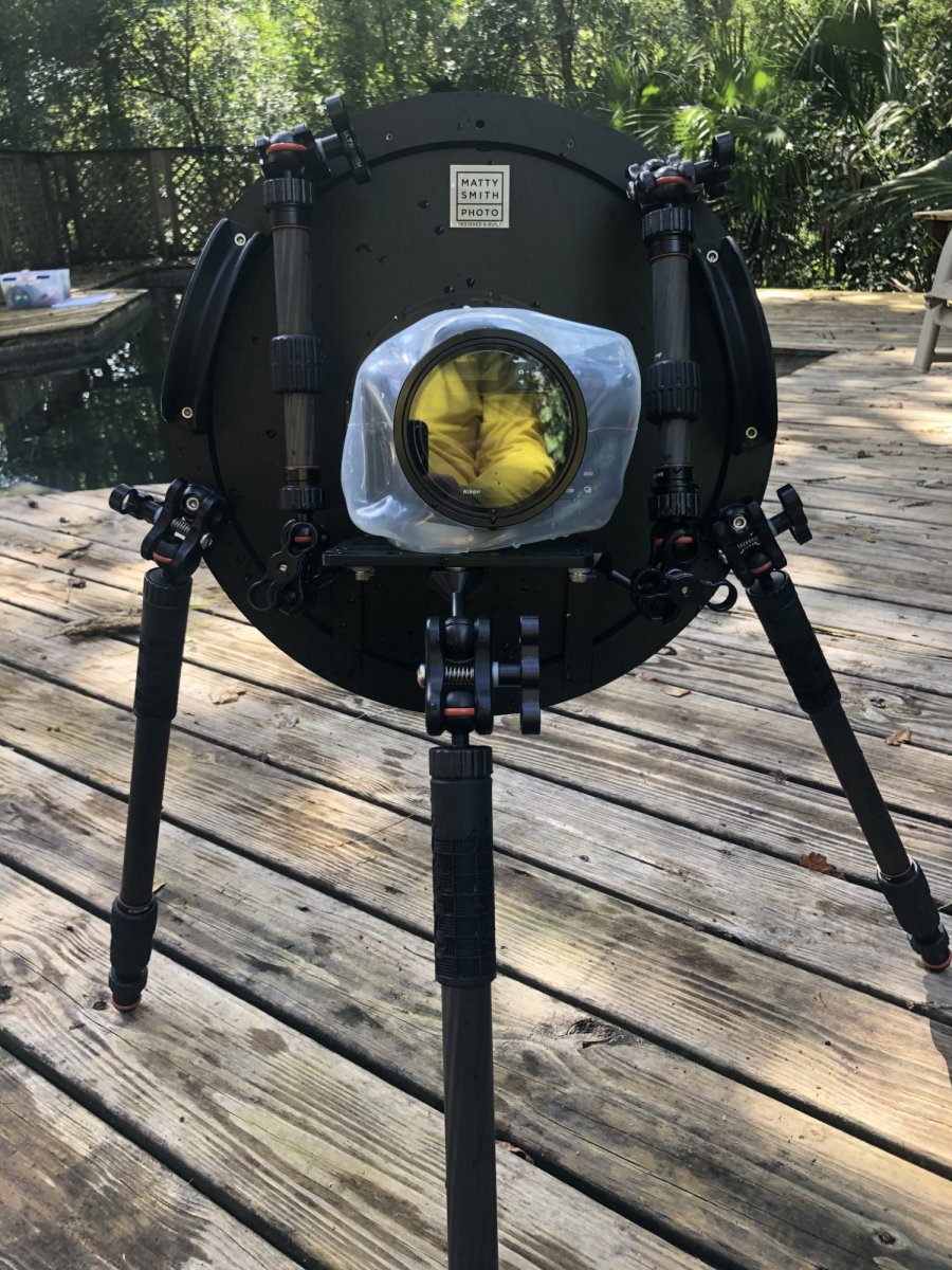

  13. I use Inon Carbon Fiber Telescoping arms (legs) attached to ball joints on a tray. Inon also makes an underwater tripod head you can attach those legs to. I haven't tried that yet because I don't pan underwater, but it would probably be pretty darned good if it is of similar quality to the arms. I wrap a weight belt around the legs for ballast.
    INON Arm System [UW Tripod System]
    As an aside, I also have a 17" dome port and attach 2 of the arms to  that and 1 to the tray.
    Which length telescopic legs did you go for?  I am about the buy the S (11in to 20in), wondering if that will be sufficient, these look longer in your photo maybe?  Thanks!
  18. Definitely looks interesting.  Do you use it with a tray or anything or does it become a matter of choosing tripod footage vs tray footage? Where do you stick your lights?

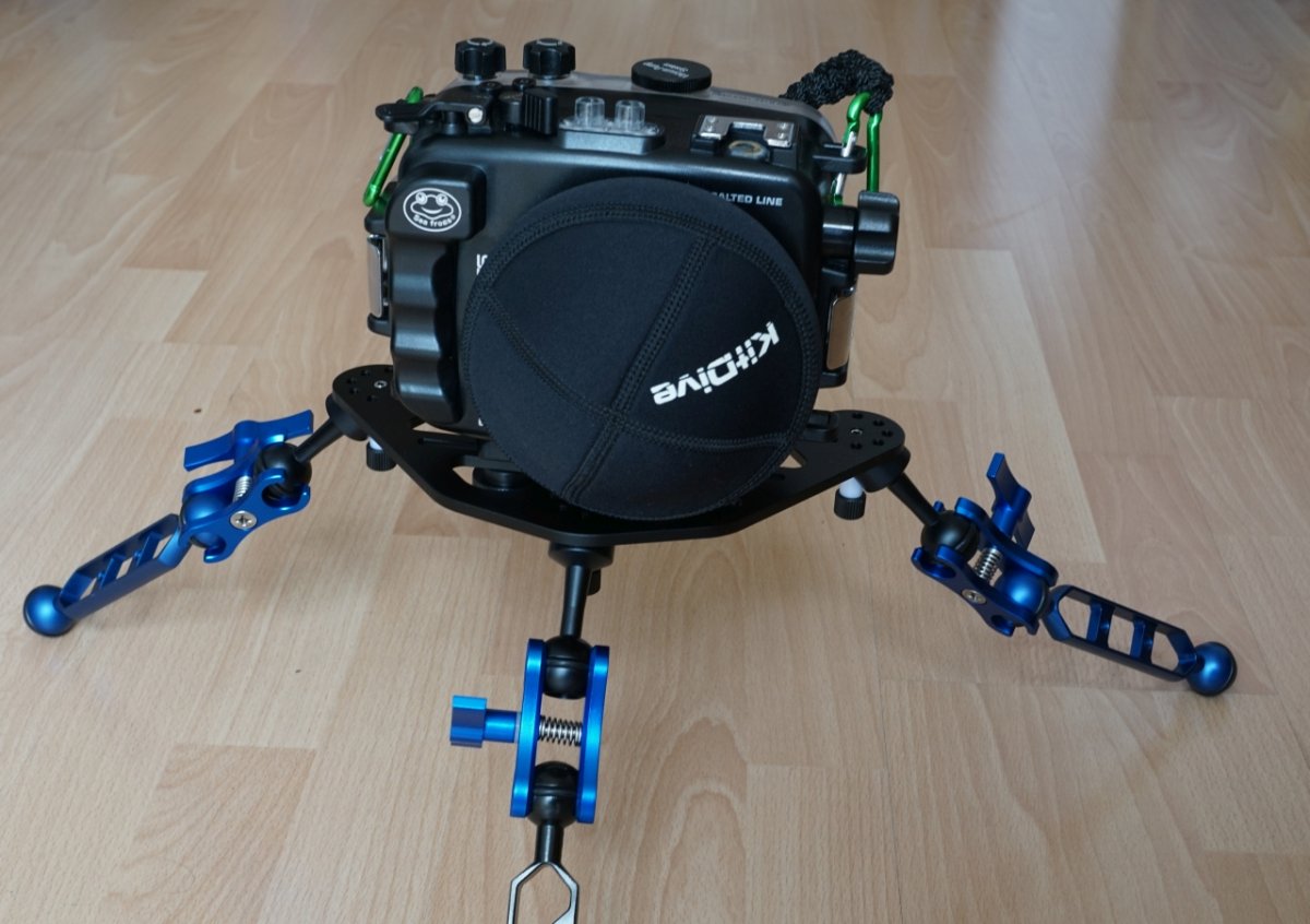

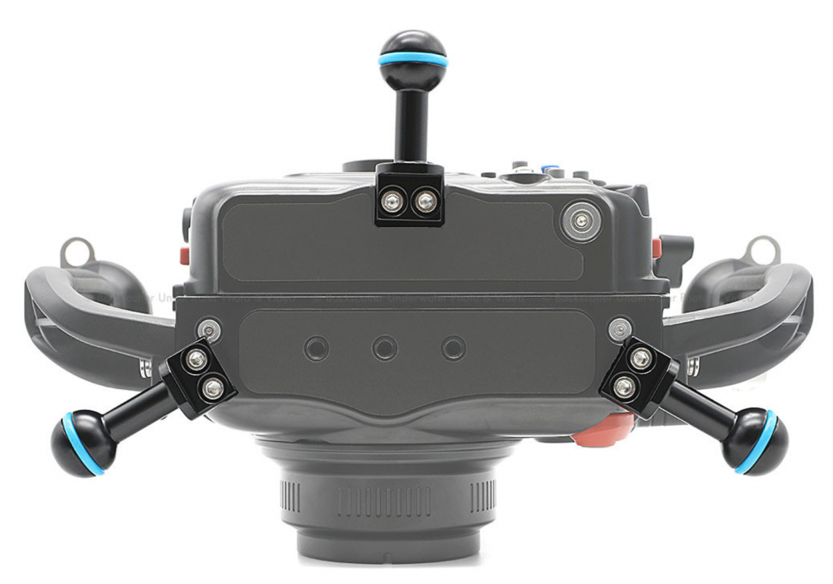

  19. If you have a Nauticam housing, you may be able to forgo the plate and just add some balls.
