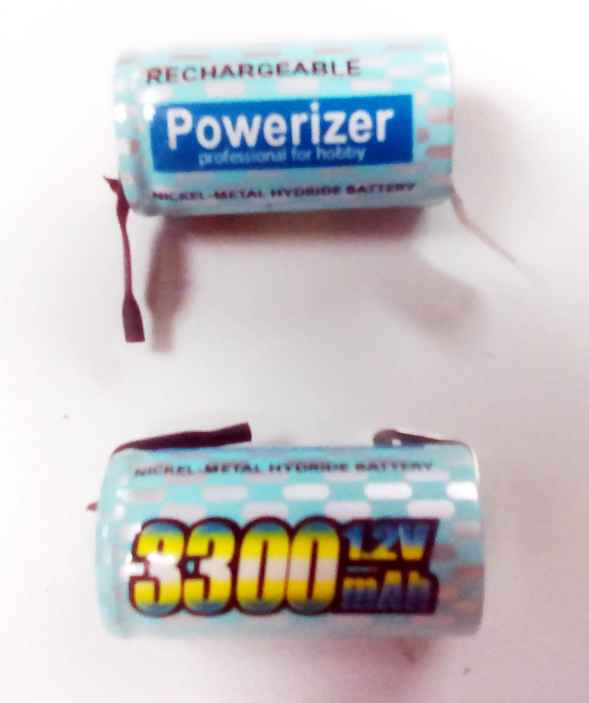

    What is the diameter of your cells? Maybe they changed since the question was answered. The cells I used were only 3300 ma. post-2195-0-28749600-1446732658_thumb.jpg
    Have the seller provide the exact measurements before you purchase it.
    Bill
