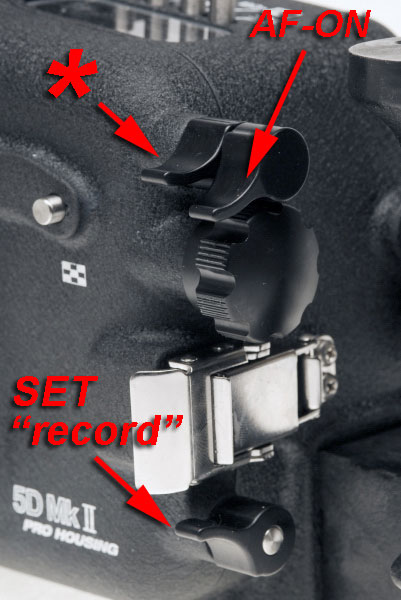

    With all these extra controls on the right, is it going to be possible to work the aperture and shutter speed without removing my hand from the handle? Starting to look a little crowded round that area! Good news on the weight.
  7. The straight on view are kind of give you that impression, but no I do not see why one would have to remove their hand from the grip to access such vital controls, it is a little more cluttered than standard (non video) housing but not to the point of forfeiting its photographic heritage.

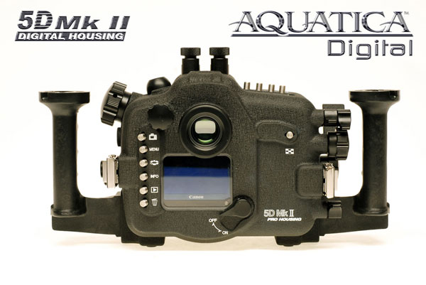

  14. Well forget about computer rendering, here the real deal, its in production and will start shipping in a few weeks.
  15. looks very nice Jean, congratulations!
  16. I can't wait to try it. Looks so beautiful designed and machined.
    Sold my old 20D with Ikelite UW housing so money in the account. Come on with the new one. I'm ready :huh:
