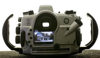

  10. Stephen Frink,
    When you look at the LCD in video mode on the new Seacam housing, can you see the red record circle in the upper right of the LCD?
    Cheers!
    Joel
    Yes, easily with Pro viewfinder:
    But, certainly difficult with either S180 or S45 magnified viewfinders.

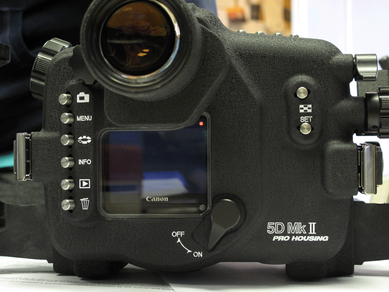

  15. Just a follow up, after having backscatter field evaluate the protoptype of our Aquatica 5D Mk II housing we have implemented some suggestions that they made, the rear window has been elongated to allow the "record ON" pilot light to be seen even with our large Aqua View Finder, the SET/Record controls who was at the lower part of the housing has been relocated to an easier access location and the dual levers for AF-ON and Star has been simplified and is now internally selectable. There is no substitute for field testing :vava: Thanks To Berkley and the folks at backscatter for being our lab rats on that one! :Ppost-1676-1237237373.gif

  17. Back at the office, sorry about the respond delay. internally selectable means that the user will be able to select which one of the two AF-ON or Star button he or she will want to use, its a well established system already being used on the D700 housing, the thing is that after going through all possible scenarios, we just couldn't come up with one where having the two accessible on the same dive made sense, so instead of over engineering it and end up with clutter around the vital quick control knob, we went for easier access while allowing the user to decide which of the two is most important for the job at hand.
    The way it is done is to move the small contact rod that push the button to the choosen location, no fancy tools, just straight on rocky boat on high seas kinda simple.

  19. You have to preselect the one you want prior to the dive, we ran over most if not all of the possibillity of scenarios we could think off and always found a way to get what we needed either through menus or custom function assignations. The point is that the dual lever was starting to block access to the quick command anybody with gloves had a hard time not pushing both lever at the same time.
  20. Still not sure I understand either. I hope it isn't what it sounds like.
    I agree with dsanders completely, without access to both * and AF-ON as separate functions while shooting. If it is how it is described, this housing no longer shows the promise of the original prototype, to the point of being unsuitable for the 5Dmkii's video capability.
    Typical shooting sequence is Live View on>AF ON>*Exposure lock>button on every time.
    Only exception would be if you were manually focussing, or didn't care about exposure! The housing should not limit these controls or determine the way to shoot.
