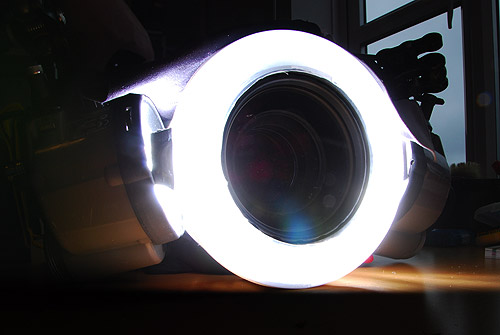

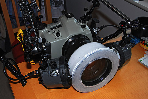

    Yesterday I built a ring-flash - that is powered by a pair of Inon Z240s. Its not really a ring flash - more a ring-shaped soft box - but the lighting effect is the same.
    I decided on this approach - as it makes it lightweight - so it can be taken on a trip with no weight penalty - and could be taken off during a dive if necessary. Plus there is no need to water proof it.
    Anyway - much to my surprise - it works really well. On land, that is. Gives lovely light for flower photos and only costs about 1-1.5 stops of light compared to straight strobes.

  2. As you can see from the photo - I still need to work on the strobe shading a bit.
    Alex

  6. Yeah. I actually used quite a thick plastic bowl - rather than a thin tupperware one - because I wanted it to be reasonably strong - even with the holes in it.
    Here is a shot of it on the housing during the testing.
    I have just pained the outside black - so it looks a little neater - so I'll post a picture after the second coat is on and dried in a couple of hours.
    Inside it is painted chrome, and then covered in tinfoil. The paint is there in case the tinfoil comes off!

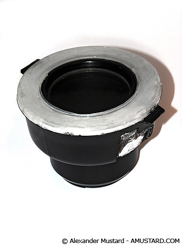

  10. Hi guys,
    Here it is painted and mounted on the port.
    Steve, it will only fit on Subals (old style ports too), but I am happy to lend it out on the workshop if it works. Of course, it may not. In which case it can be obtained for free from the nearest skip.

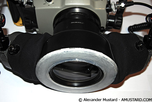

  11. And here it is on a housing - short sections of old wetsuit sleeves stop light spillage from Inons.
    Not the best picture - hard to see detail in black on black, I know.
    Alex

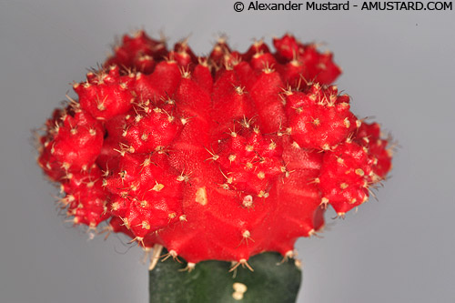

  12. And here is one of the test shots. The ring flash has lit the front of this complex, three dimensional structure of this cactus with flat light:
    F16 with strobes on F8 - about 1/4 power I think.
    Alex
  13. I like how you've used the handles on the bowl to hold the strobes and the wetsuit sleeves Alex. Great little DIY there!
    James
  14. Great job Alex!
    I tought how the strobes stay put with the sleave's, but James just cleared that out :D
