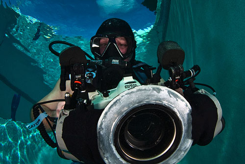

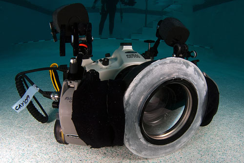

    Here are some pictures of the ring-flash in the pool on Sunday. The one with me in, was taken by Julian Cohen.
    Alex

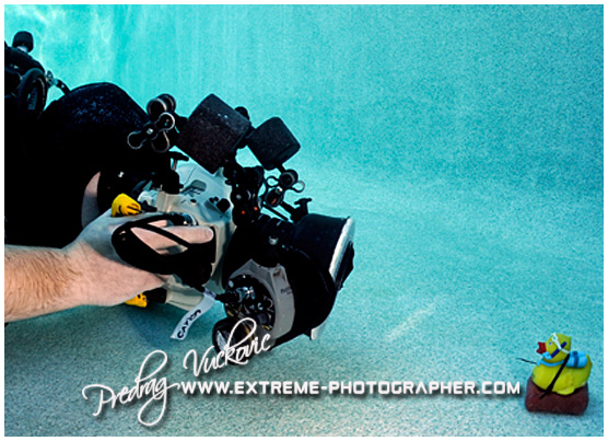

    Here is one of me testing the ring-flash on the duck.
    Alex
