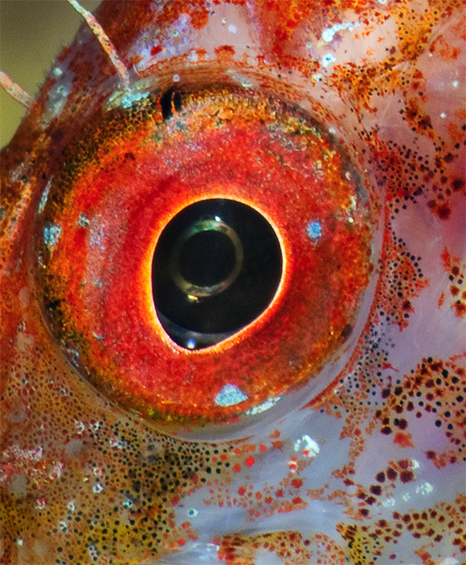

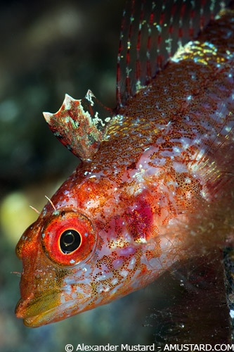

  4. An update. I took Ring Flash version II to Sardinia and was pleased with its performance. I still believe it only suits certain subjects, but it is a nice option to have when you have a specific shot/subject in mind.
    This image amused me, because you can see the ring flash reflected in the eye of this Peperoncino (triplefin).
    Not that I think that this is a particularly good effect.
    Here is the whole frame:
    Alex
