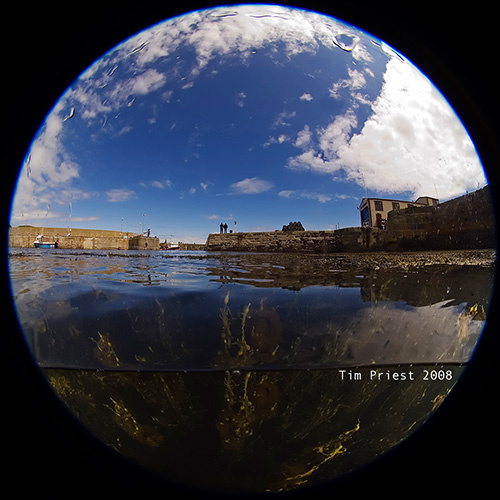

    Flat calm; big dome; wide, wide lens; shallow; strobes if there is a foreground subject...
    Sigma 4.5mm, twin strobes, Scotland.
    ... and I still use Photoshop to edit out some of the droplets on the dome! Detergent and anti-fog have been suggested, but aren't that friendly to the environment (and maybe not that friendly to o-rings).
    Nikon 10.5mm, ambient light, Sipadan.
    Tim
