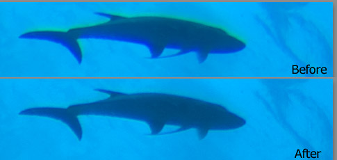

  14. I would also be concerned about the corner CA - an area where the Tokina is already a bit naughty and I would only expect it to get worse working through a TC. I would think that typical reef wide angle shots, where the corners might contain contrasty fine detail (silhouetted small fish, edges of seafans etc) that the purple fringing could be an issue.
    Alex
    Alex,
    In the cases where you saw this problem, did you try CA correction in post?
  15. The Tokina 10-17mm is well known for purple fringing - which is why is regularly gets slated in land photography reviews, e.g.
    "However, the Tokina lens clearly has some downsides. The primary weaknesses are chromatic aberrations (color shadows at the borders) and, more so, purple fringing (color blooming). Lateral CAs can be reduced easily via imaging tools but this is more difficult with PF."
    But as I have said since my initial reviews of this lens - this is not such a problem with UW subject matter:
    "Testing the lens on land I found that the zoom was more prone [than Nikon 10.5mm] to chromatic aberrations and particularly purple fringing on high contrast details in the corners of the frame. Sharpness was similar. Underwater, behind a dome port, the fringing issue is much less. At typical apertures (not wide open) under normal shooting conditions I have found the Tokina photos to be all but indistinguishable from my Nikon 10.5mm for sharpness, colour saturation and fringing. That said, pool tests published by Steve Frink and Mike Mesgleski on Wetpixel.com have shown more fringing from the Tokina, although they note that pool test shots are not truly representative of how fisheyes are used in the ocean."
    Jeff, here is an example from our Socorro trip, of a corner frame crop (screen grabbed from Lightroom) with the PF as shot (uncorrected) and then corrected (Blue/Yellow +75):
    My concern is that the teleconverter is likely to amplify the PF with Tokina. But this is just a concern - I have not tested it. And it would be good to see it wasn't.
    Alex
