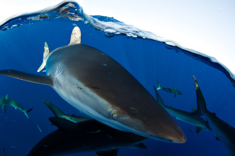

    After using the Tokina 10-17 with 1.4 Kenko TC on my D700 extensively last week on my trip I can happily say this lens is now in my bag as my favorite wide angle lens on full frame underwater as it was on my D200, and I have now happily left DX behind.
    So I am now posting quite seriously that I think this lens is a great option, and I am surprised none of the Canon full frame users have tried this lens combination underwater over the last few years.
    The D700 has changed the way I shoot underwater, so the one stop loss due to the TC is simply not a problem, as I routinely shoot now between 400 and 1600 ISO depending on depth. I will write more about this another time.
    I found the autofocus worked just fine, and all the Tokina close focus and fisheye depth of focus advantages were there just as they were with my D200 and using it on the D700 was a no brainer.
    Here are a few uncropped images. The stated focal lengths are from EXIF data, so are the lens barrel setting and should be converted by x 1.4.
    (The color is a little off only because of AdobeRGB export issues directly from Aperture to Picassa)
    To my eye sharpness is clearly not an issue, and compares favorably to any of the full frame wide angle options I have seen for Canon or Nikon underwater. Going out on a limb a little, I'd say corner sharpness is better than the rectilinears. (Particularly evident in the second shot)
    I also used the 17-35 with +4 dioptre, and was very pleased with this as well, and will post some of those later.
    I was having so much fun with the Tokina, that I did not get around to trying my 24-70 underwater as I had planned.
    First two at 11.5mm
    ISO 400 f16, 1/125 sec
    ISO 400 f11 1/125sec
    Next at 13mm
    ISO 400 f8 1/60 sec
    Finally at 17mm
    Edited by loftus

  4. Did you happen take any shots at 10mm? I'm just wondering if 11.5 is the the lowest-usable FL.
    Also, did you encounter any significant
    I recently got a Sigma 15mm FE for my 30D for some wide angle shooting I did. I opted to avoid the 10-17 because I also have a 5D2 and know I'll eventually upgrade my housing and didn't want to lose out on the FF options... now I'm wondering if I'm missing out! :D
  5. Did you happen take any shots at 10mm? I'm just wondering if 11.5 is the the lowest-usable FL.
    Yup, I did. (Not on purpose) Still works fine, just means some cropping is required. ^_^
    Nothing a little cropping and cloning cannot fix.
    Edited by loftus
  6. Yup, I did. (Not on purpose) Still works fine, just means some cropping is required. :D
    Good to know - thanks for posting!!

  12. I would like to add a couple of new observations with regard to port extensions and vignetting at the 10mm setting.
    On my recent trip I used the FE2 Subal Domeport and 30mm extension and the following vignetting / corner obstruction resulted. It should be pointed out that with this setup the Tokina and 1.4TC combination protrudes just beyond the port opening. My initial thought was that the lines of vignetting down the sides (right more than left) are 'in-camera' the soft vignetting at the top is due to the Tokina lens shade which is longer on top and bottom than on the sides, and the corner vignetting is due to the dome port shade.
    However removing the dome port shade, does not significantly improve the corner vignetting / obstruction
    Kyra
    On the other hand when I change to a 20mm extension there is less corner vignetting or obstruction, even with the domeport shade on
    Kyra
    So I am not sure which extension is preferable though I have a sense that the corners may be a little softer with the 20mm extension possibly due to the lens surface being closer to the dome.
    I was surprised to find that the corner vignetting got better when I moved the lens closer to the dome (10mm extension), thinking it was the dome port shade, but did not get better when I moved the lens back(20mm extension), even with the dome shade removed.
    Any comments, or thoughts on the best extension to use would be appreciated.
  13. The Tokina has an internal baffle - 10mm is just not a usable focal length with the 1.4x teleconverter on full-frame. A 1.5x teleconverter may just get you there, though...

  17. Excellent to see your Dr Franken-lens working Jeff. I think it is a jolly good solution for this type of shooting. The shots show that and it looks plenty sharp enough.
    The main downsides I see are that small loss in quality from using the teleconverter would probably mean that a D300 and 10-17mm would give you better image quality. Of course, you don't own a D300, so it is not really a relevant point.
    I would also be concerned about the corner CA - an area where the Tokina is already a bit naughty and I would only expect it to get worse working through a TC. I would think that typical reef wide angle shots, where the corners might contain contrasty fine detail (silhouetted small fish, edges of seafans etc) that the purple fringing could be an issue. Of course for big animals and pool images - the subjects that you shoot - this is not a significant issue. I also think that the optical flaws would become more serious on higher megapixel full frame cameras, like the D3X, 5DMk2 and 1DsMk3, so this might not be a preferred solution for all shooters.
    The reason that your corner cut off got less when you moved the lens forward relative to the dome (10mm extension) is because the closer a lens is to a dome the more it acts like a flat port - narrowing the angle of coverage of the lens and reducing cut off from the shade in the corners.
    Oh, ok, the d700 does not realize it is a dx lens without the contacts touching as the teleconverter is in place. Do you get all metering modes and TTL also?
    You can tell the FX Nikons to treat DX lenses as FX lenses and not to default to DX. I think that the AF will be considerably slower than a straight F2.8 fisheye - since the Tokina is 3.5-4.5mm lens and you will loose a stop for the TC - so AF will be working through a F5-F6 lens (approx) - which might become significant in lower light conditions. I'd imagine that TTL would work OK - but I don't see TTL as an ideal lighting solution for fisheye shots so I see this as less of an issue.
    Alex
    Edited by Alex_Mustard
  18. The main downsides I see are that small loss in quality from using the teleconverter would probably mean that a D300 and 10-17mm would give you better image quality. Of course, you don't own a D300, so it is not really a relevant point.
    No question this is not an ideal setup for all the reasons you mention, we would just hope Tokina would make a 15-24 Fisheye zoom for FX, which I guess is pretty unlikely.
    I think for the type of stuff I have shown, close-up shark action ala Abernathy, and the whaleshark, this lens performed admirably and at this point in time I would probably choose this lens for these situations over all others. I am hard pressed to see any loss of quality, at least compared to my D200 and at routine magnifications. I must admit I was surprised it performed as well as it did, as I was sure that it would not work well otherwise folks would have been using it already. I had no issues with autofocus, the lens seemed to perform as well (except for the vignettiing which is easily overcome) as it does on DX, and the big thing it retained was the close-focus ability which is unsurpassed by any rectilinear. I own the 14-24 and 17-35 and 16. For pool work, more distant big animals, general reef work etc, I would use my 17-35 with +4, possibly my 16mm for the pool (which I used on DX). Maybe, if I can be convinced that the 14-24 can work predictably I will use it at some point. I think pool tests are helpful, but I'm not convinced they translate completely into more dynamic real life situations, particularly in the corners. We can't escape the fact that fisheye lenses will theoretically always be a better match than any rectilinear with present dome port designs.
    I think the question to be asked at this point, is whether any of the rectilinears available for Canon or Nikon on FX, could have done a better job with the type of images I have shown in terms of IQ and corner to corner sharpness. Of course the FE distortion may be something undesirable, but again, rack it out to 17mm and most of that is gone as well. I see no reason to use my 16mm again for diving, except maybe low light siuations.
    I think the Tokina is one of those lenses that when you have it on for something like that chance whaleshark encounter, you're pretty happy you did.
    Edited by loftus
  19. The Tokina has an internal baffle - 10mm is just not a usable focal length with the 1.4x teleconverter on full-frame. A 1.5x teleconverter may just get you there, though...
    I think what puzzled me is that I thought the corner obstructions, which are sharper than the more diffuse peripheral shading, were from the dome port shade, and they were not as removing the domeport shade did not help. I know it's not possible to get rid of all the vignetting, I'm just trying to work out if any of it is from the external shades of the lens or the dome port. I thought of trying the 1.5 Kenko, but it does not get very good reviews when compared to the 1.4
    Edited by loftus
  20. I think what puzzled me is that I thought the corner obstructions, which are sharper than the more diffuse peripheral shading, were from the dome port shade, and they were not as removing the domeport shade did not help. I know it's not possible to get rid of all the vignetting, I'm just trying to work out if any of it is from the external shades of the lens or the dome port. I thought of trying the 1.5 Kenko, but it does not get very good reviews when compared to the 1.4
    I assume the 1.7 would solve the problem at the cost of some FOV, right?
    1.7x + 10mm = 17.0mm
    1.4x + 11mm = 15.4mm
    Is that the right way to think about it?
    How does one estimate or calculate what the effective FOV will be for a given lens/TC combination and focal length?
