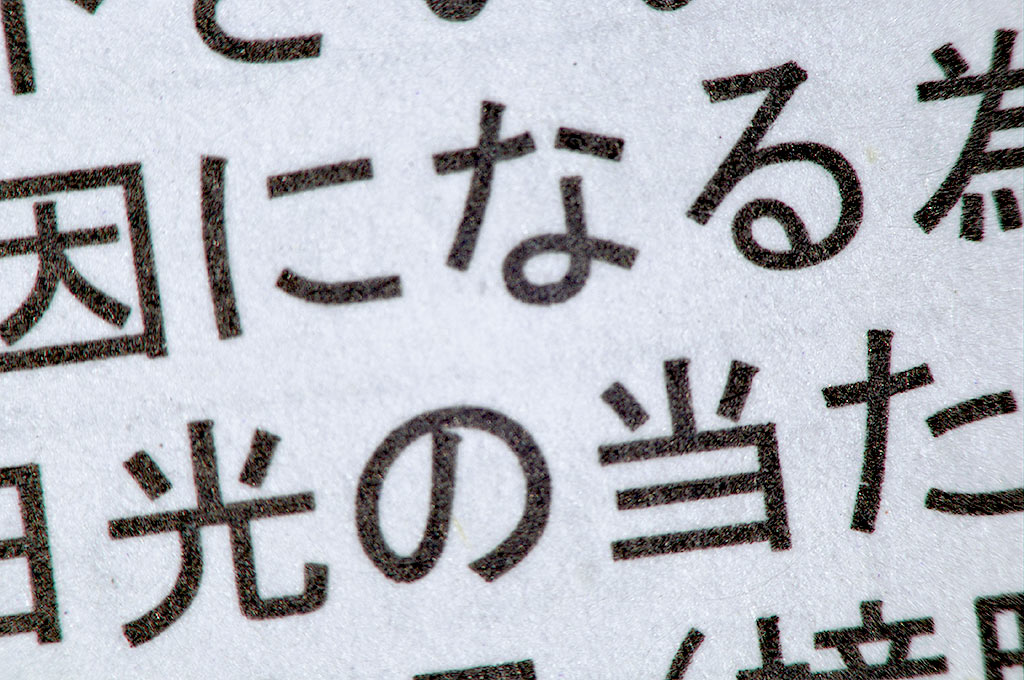

  14. Here's a pic of some text on a pamphlet. F/11, 1/320, D300, Sigma 150, Hoya +3 achromat. It's about 1.8:1. Sigma needs a bit more for 2:1. Working distance is 5".
    I made no special effort to shoot the paper completely flat and it is not. As you can see, there is no particular problem getting sharp corners and f/11 is adequate for DOF.
  15. Keri suggested I will get better results out of the water by flipping the diopter. The results look a little better with the diopter flipped.
    I shot at F11, and your right, I had no problem getting adequate DOF.
  16. That's better.

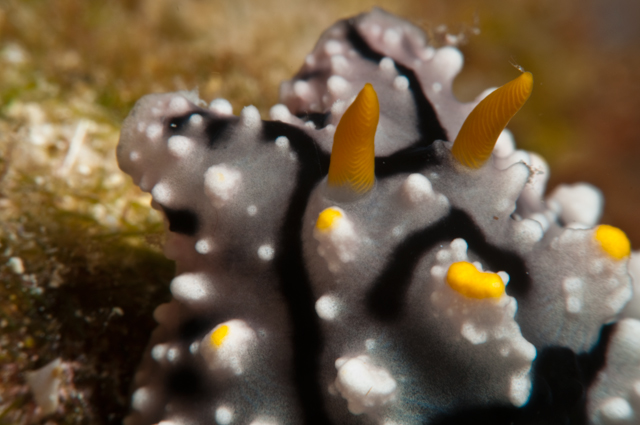

  17. I have one of these. I had it on my Nikon Af-105-VR for 3 diving days in Tulamben and 10 diving days in Wakatobi.
    The device was very difficult for me to use and will take considerable practice for me. If you get it right it will take an awesome shot. However, on a wall where it is uncool to grab hold I found getting a focus lock very difficult. Then too, one needs a VERY small subject to want to magnify a 105 past 1:1.
    I found that using a light was critical for focus and that proper positioning of the strobes so the camera could see the preflash equally importent. I used autofocus. I also experimented with release priority and focus priority for the shutter release. In my pool at home release priority was fine but in the ocean I needed focus priority because the depth of field was so shallow that shots I thought were in focus were not. (My eyes are not good enough to make a decision using the camera's viewer.) Jeff Mullins told me he gets 1 of 10 in focus using an E-330/50mm.
    I did get some shots but nothing worth posting much less framing.
    This nudi was shot at F/32 1/160.
    I'll try to find some more.
