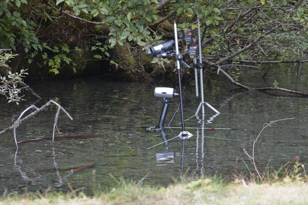

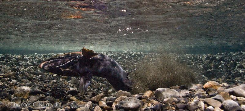

  14. Well-timed thread Alex! I took this week's winning shot (thank you all for the votes! ;) ), 'I've got the power' (one must think of the snappy tune :blush: ), with slaved strobes.
    I agree on both the cord and sensor issues. In this case I had the strobes mounted on studio light stands (don't try this in seawater) and was careful to have a line of sight between the sensors and front of the main strobe, which was centered above the housing (in order to illuminate right in front of the FE lens). Whatever background you see under water as well as the green leaves of the trees overhanging the site above the water were due to the slaved strobes. Without them, there would have been just a few specks where light was coming through the leaves.
    I have done other shots where I have held a slaved strobe pointed at the camera (my other hand had the remote release). It is VERY easy to get lens flare this way! One also gets retinal after-burn. However, it does light up the background well. See attached pic of a female coho salmon digging her nest. The background would have been virtually black without the slaved light.

  15. OK, I went browsing through my collection of jpegs and found this technique shot. It was taken 2 weeks before 'I've got the power!' so the setup is not identical. I replaced the Inons with a S&S and added a diffuser to the Seacam strobe. The location is within a few meters of where 'I've got the power!' was taken. The arm holding the S&S strobe is positioned so that the slave, which is next to the strobe mount, is facing the housing. The Inon's are bolted directly to an Al L-bracket so that the row of sensors are in front of the bracket and have a clear sight towards the housing.
    Tom

    Thanks for posting the setup, Tom. That is fascinating. It really makes it look like the sun is shining and gives the image tremendous depth. Very cool. Shows how much work goes into your images. I am mightly jealous of your strobe collection too. I only have 2 strobes less than a decade old. Makes me realise I need to invest in some lighting. The Seacam 150 (Kurt Amsler edition, of course) is such a nice strobe.
