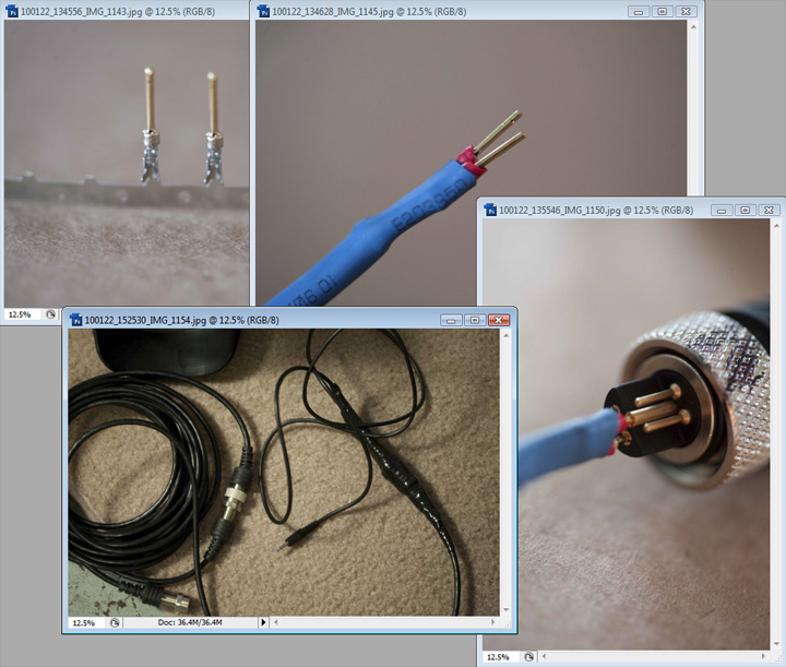

  12. Here's what I came up with to fire my topland strobes. Just a couple of pin connectors from Radio Shack fit nicely into my ikelite cable, which I do not have to cut into. Tested at home and it works great. I can't wait to do some further testing at the pool. Thanks for all the help and ideas to get this done. Oh yeah, it cost me about $8 in tape and the pin connectors :):D.
    MP
