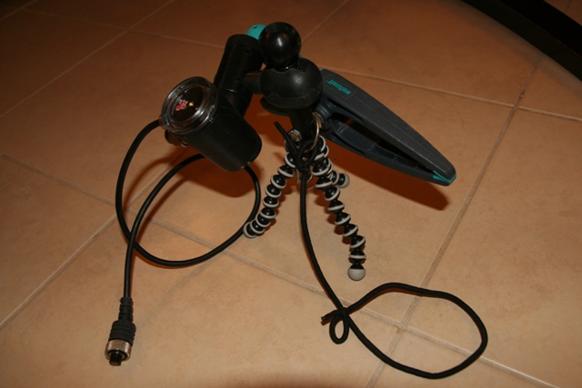

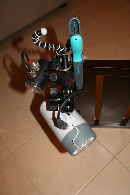

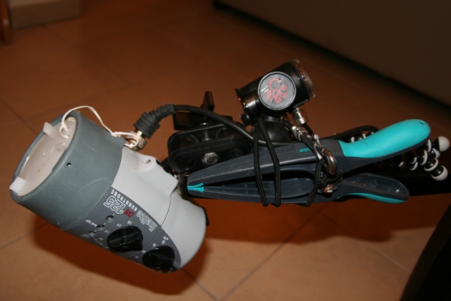

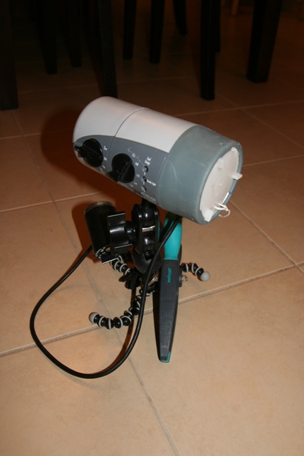

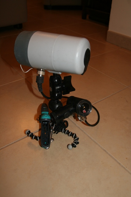

  6. Hi All,
    I thought I post a few shots of my barstadiezed gorilapod.
    (Sorry Alex just seen your questions.)
    It uses a small gorilapod which is glued into a section of arm, which then has a plastic clamp bolted through the joint and a length of bungey and dog snap clip attached.
    This size gorilapod is a bit small on land but underwater gravity is offset by bouyancy so seems okay, but if I was going it again I'd get bigger gorilapod.
    1- Strobe facing right, slave facing left.
    2- Strobe facing left, slave facing right.
    3- Clipped on, normally use on wrecks (but this time dining room chair).
    4- Tied on, using the attached lenght of bungey for bigger items.
    4- Just the pod without strobe,
    Any questions please shout.
    Richard B.
