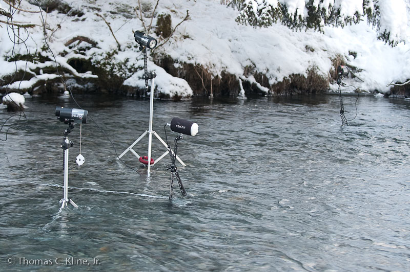

    I use two most of the time for scuba pix. I have also used just one. I started this way. Recently I have been using just one, but a super-wide strobe, centered over the middle when shooting a fisheye. These are non-scuba shots!! :) I optionally use a slaved strobe or strobes with the this set up as shown here -- http://wetpixel.com/forums/index.php?showt...mp;#entry234554
    I have also used just one strobe recently for semi-available light pix as described in the next post.
    Edited by Tom_Kline
  13. After posting I remembered I had this technique shot so quickly cranked it out of Lightroom. On the left is my housing with the fisheye and centered WA strobe (a Seaflash 150) with two slaved S&S 250s on light stands. Over on the right is a wee Inon by itself protruding out of the water. For the Inon arm I attached two 12" sections end to end to make it about 2 feet long. The housing it is attached to has a D2H in it with a Sigma 20/1.8 that I was shooting at f/4 at ISO200. The strobe here was just proving a kicker light whereas for the other set up most of the light was from the strobes. Otherwise the D2H shot was by available light. As you can tell by the dull contrast it was rather overcast. Post #29 in this thread has a shot taken with the Inon set up-
    http://wetpixel.com/forums/index.php?showtopic=33642
    I was using a smaller aperture for the fisheye, either f/9 or f/10, so needed much more flash power (ISO was 250).
    Edited by Tom_Kline

  16. After posting I remembered I had this technique shot so quickly cranked it out of Lightroom. On the left is my housing with the fisheye and centered WA strobe (a Seaflash 150) with two slaved S&S 250s on light stands. Over on the right is a we Inon by itself protruding out of the water. For the Inon arm I attached two 12" sections end to end to make it about 2 feet long. The housing it is attached to has a D2H in it with a Sigma 20/1.8 that I was shooting at f/4 at ISO200. The strobe here was just proving a kicker light whereas for the other set up most of the light was from the strobes. Otherwise the D2H shot was by available light. As you can tell by the dull contrast it was rather overcast. Post #29 in this thread has a shot taken with the Inon set up-
