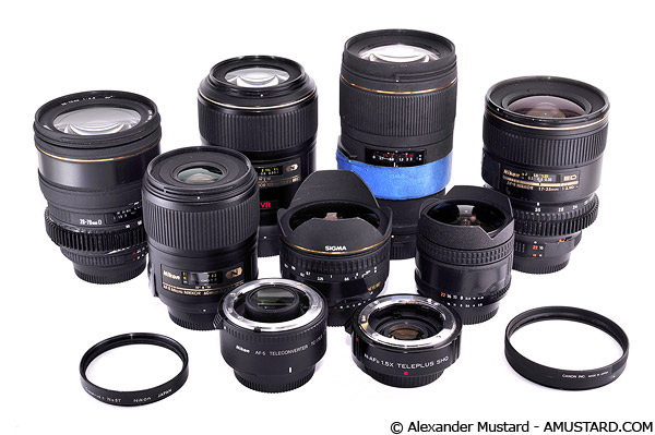

  1. Soon enough you'll end up with this lot. This is what I consider my standard travelling set of underwater lenses (for FF Nikon - so not relevant here) - took this picture yesterday for something else and thought it looked pretty cool:
    Alex
  2. Nice collection Alex! I'm not a Nikon user, so a lot of them are unfamiliar, care to name them all?
    What's the blue tape on the longer lens for as well?

  15. Nice collection Alex! I'm not a Nikon user, so a lot of them are unfamiliar, care to name them all?
    The image shows (back left to front right) Sigma 28-70mm, Nikon 105mm VR, Sigma 150mm, Nikon 17-35mm, Nikon 60mm AF-S, Sigma 15mm FE, Nikon 16mm FE, Nikon 5T, Nikon 1.7x TC AF-S, Kenko 1.5x TC, Canon 500D. These are what I generally use on FX. I also have a 20mm Nikon, but I only dived it once last year.
    This was taken with the 20mm:
    The blue tape is to stop a switch moving. The lens used to have black tape on it, but this came off at some point and this blue tape was the only one available on the liveaboard.
