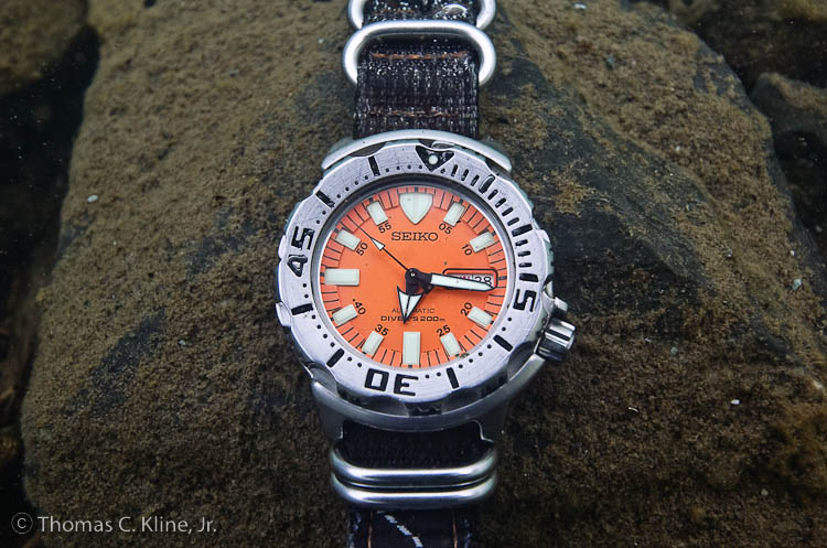

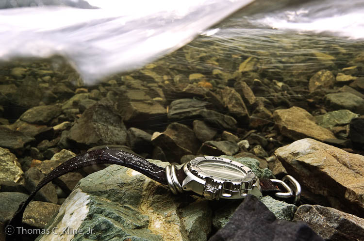

  9. The zoom control ring arrived yesterday from Seacam USA but the clouds did not part until 1800 today so I have just a few quick shots to satisfy my curiosity. I set the lens at the minimum focus distance and disabled AF. VR was on. My Seiko watch had to serve as a subject. Shot with a D2H.
    The shot of the watch face is at the 35mm FL setting. The over/under shot at 21mm. Fine detail such as scratches on the watch crystal are resolved. Looks like a good lens for close-focus wide-angle. :o
