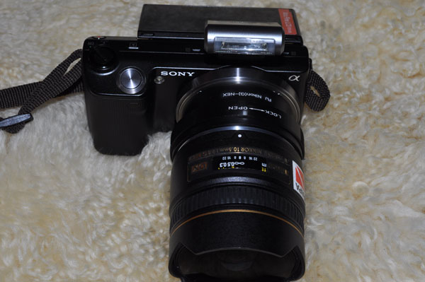

    Here is another option;
    Nikkor 10.5mm/2.8 DX(1.5 crop) Fisheye through Nikon G/Nex adapter (U$40.- in e-bay). Camera in 'Release w/o Lens' mode, A-mode(shutter speed automatically changes), manual focusing (or fix at 0.5m to cover 3-10m in UW).
    Lens almost same size as 18-55 bundle lens. Need dome + extension to house this lens but, should be a simple one.
    Sam

  2. Here is another option;
    Nikor 10.5mm/2.8 Fisheye through Nikon G/Nex adapter (U$40.- in e-bay). Camera in 'Release w/o Lens' mode, A-mode, manual focusing (or fix at 0.5m to cover 3-10m in UW).

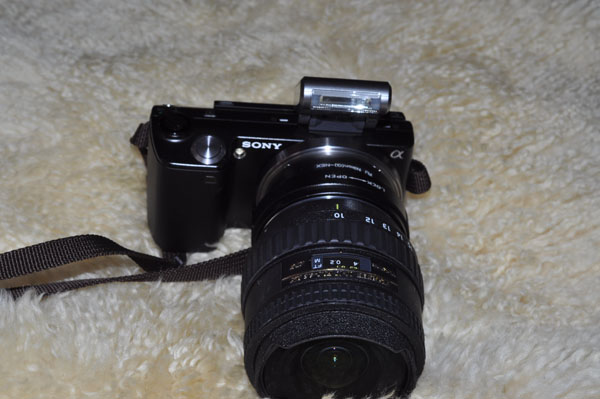

    Picture with Tokina 10-17mm Fisheye Zoom through Nikon G/Nex adapter(U$40 for Nikon G adpter/U$26 for Canon adapter). Camera in 'Release w/o Lens' mode, A-mode, manual focusing (or fix at 0.4m to cover 3-10m in UW).
    Lens little bigger than 18-55mm bundle Sony lens. Zoom gear is needed or use at fixed.
    Sam
