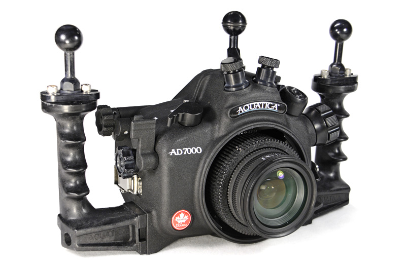

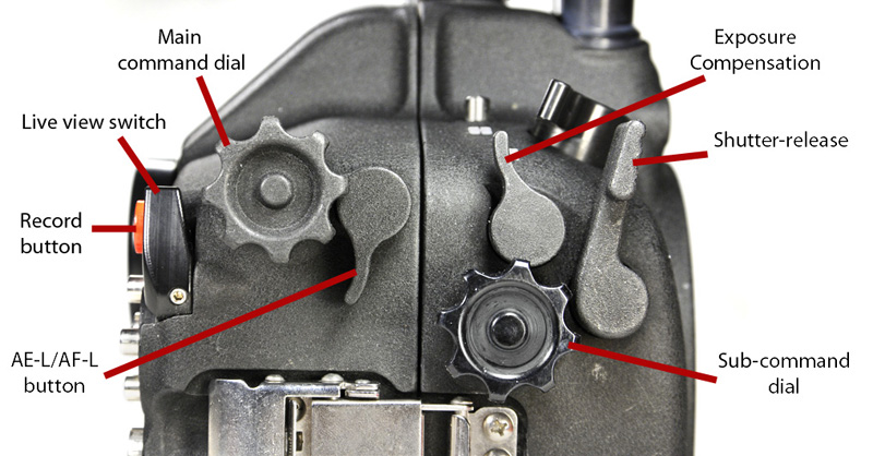

  8. Mark - I've got lots of images of the housing, including detail shots of internal components, but I'm holding off posting those until I've got the review of the camera/housing complete. This past week I was bogged down with shipping SubSee units out, but I'm hoping that I'll be able to get the review out this weekend, now that I've got some room to breath.
    Here are a couple of shots that might help tie you over :island::
    *NOTE: the sub-command dial, live view switch, and on/off button (above the shutter-release) are unfinished in this photo. They will be powder-coated just like all other buttons/levers in production versions; Aquatica didn't have time to get these finished before I left for Dominica*
    Stay tuned for more...
    Keri
    Edited by SlipperyDick
